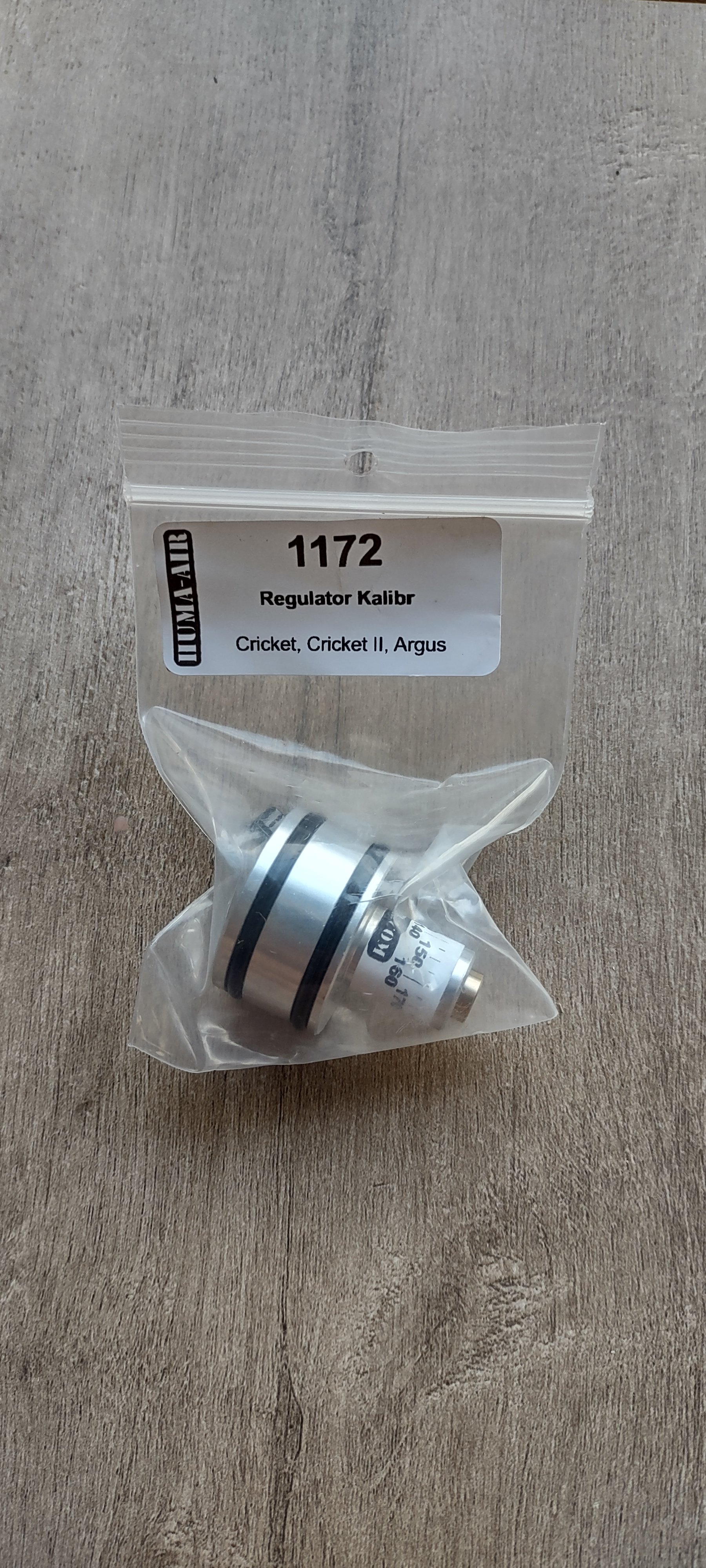

Just a quick update on my regulator creep situation, it has gotten to the point that it is starting to bother me so I am going to replace it. I just received my argus regulator from huma air and it appears the regulator works for cricket I, cricket II, and the argus based on the label of the packaging.

Below is a pic of the label from Huma Air.
