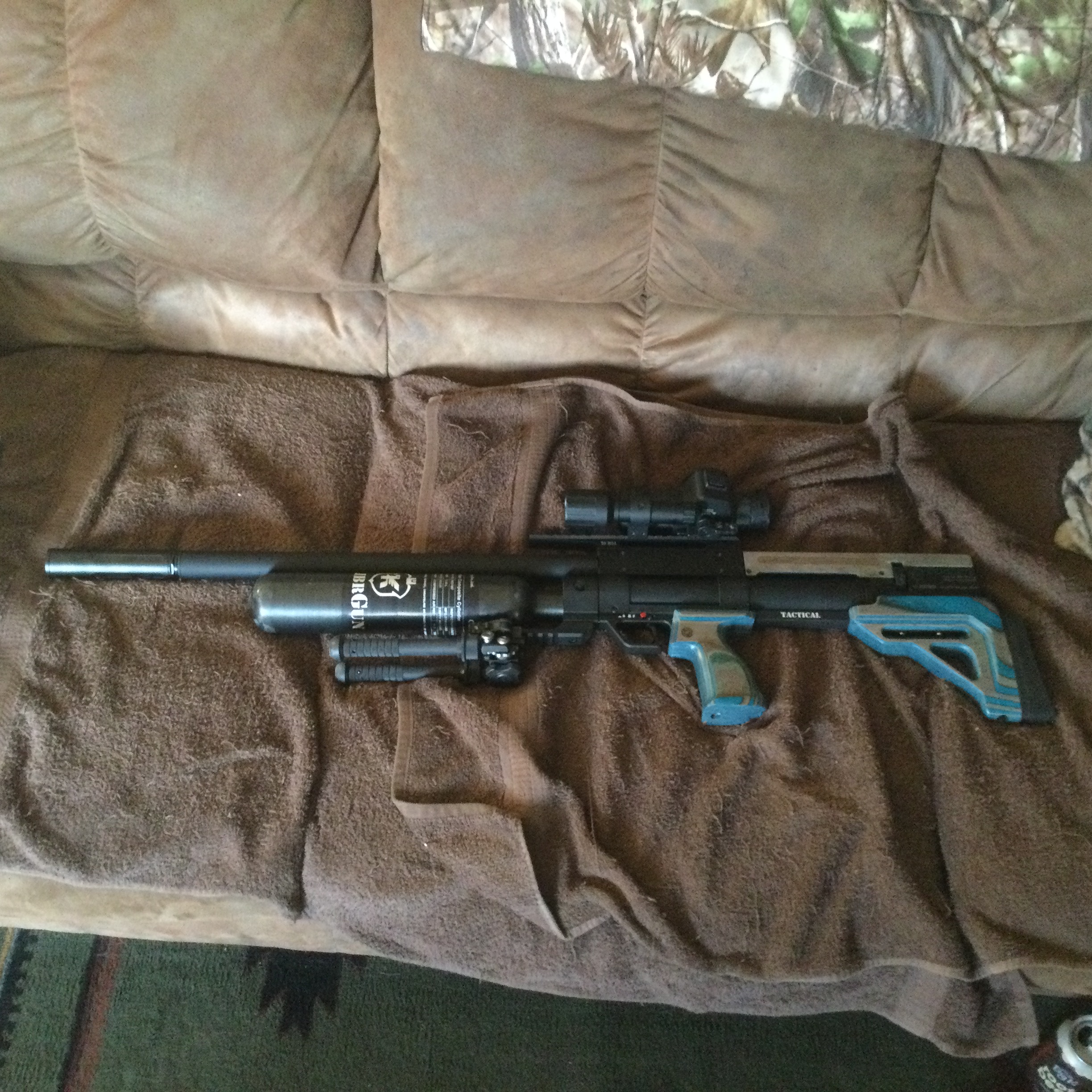

KalibrGun Cricket 2 Tactical 45 Wood Opinions Wanted
@Deltaman What would you like to know? Yes, the polish job on the mag screams Charlie.
The Cricket 2 45 and 60 are the same but different barrels and settings.
The Cricket 2 Smooth is the same but with a tube and not a bottle.
The Argus is totally different other than barrel and reg.
