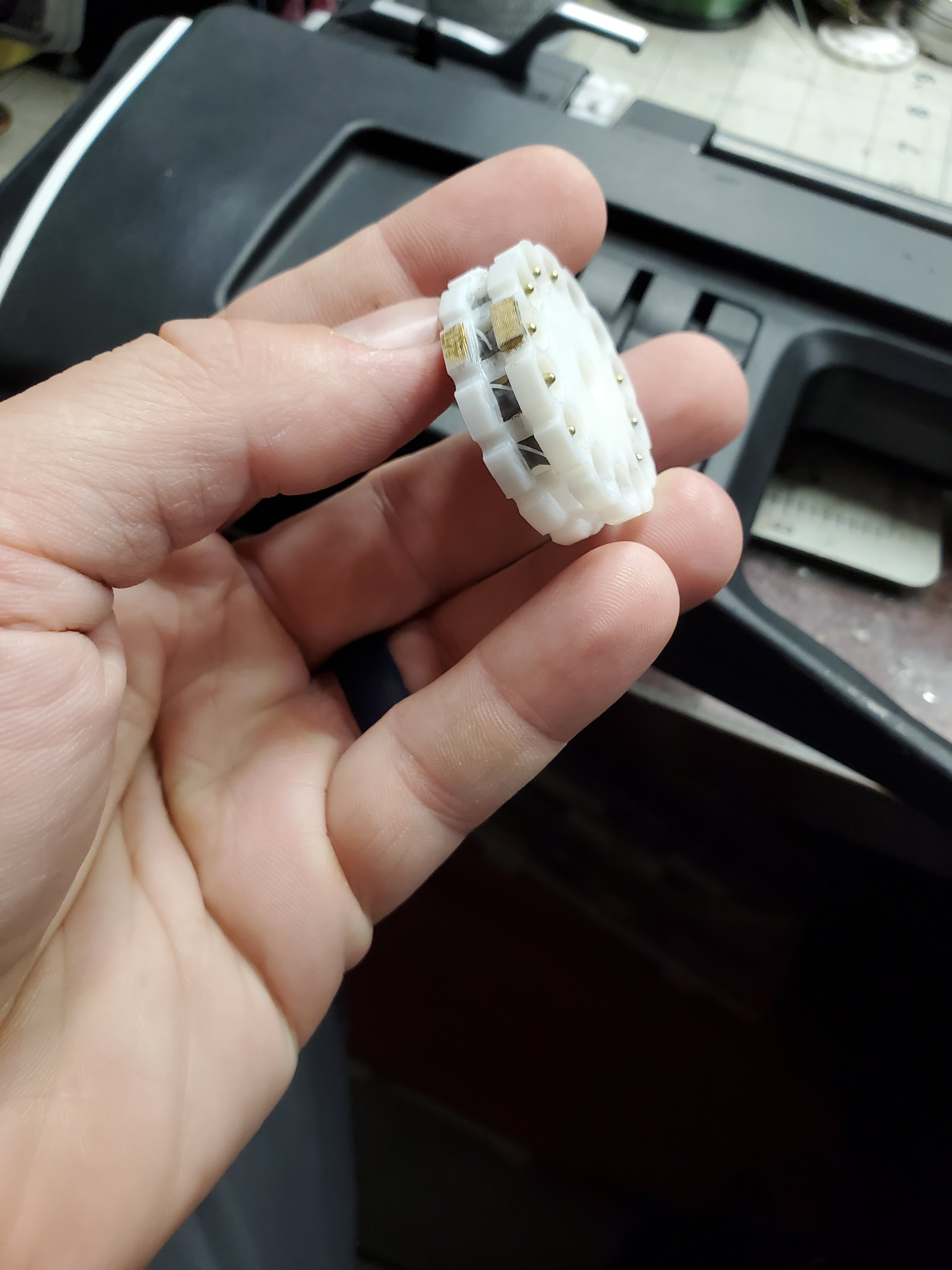

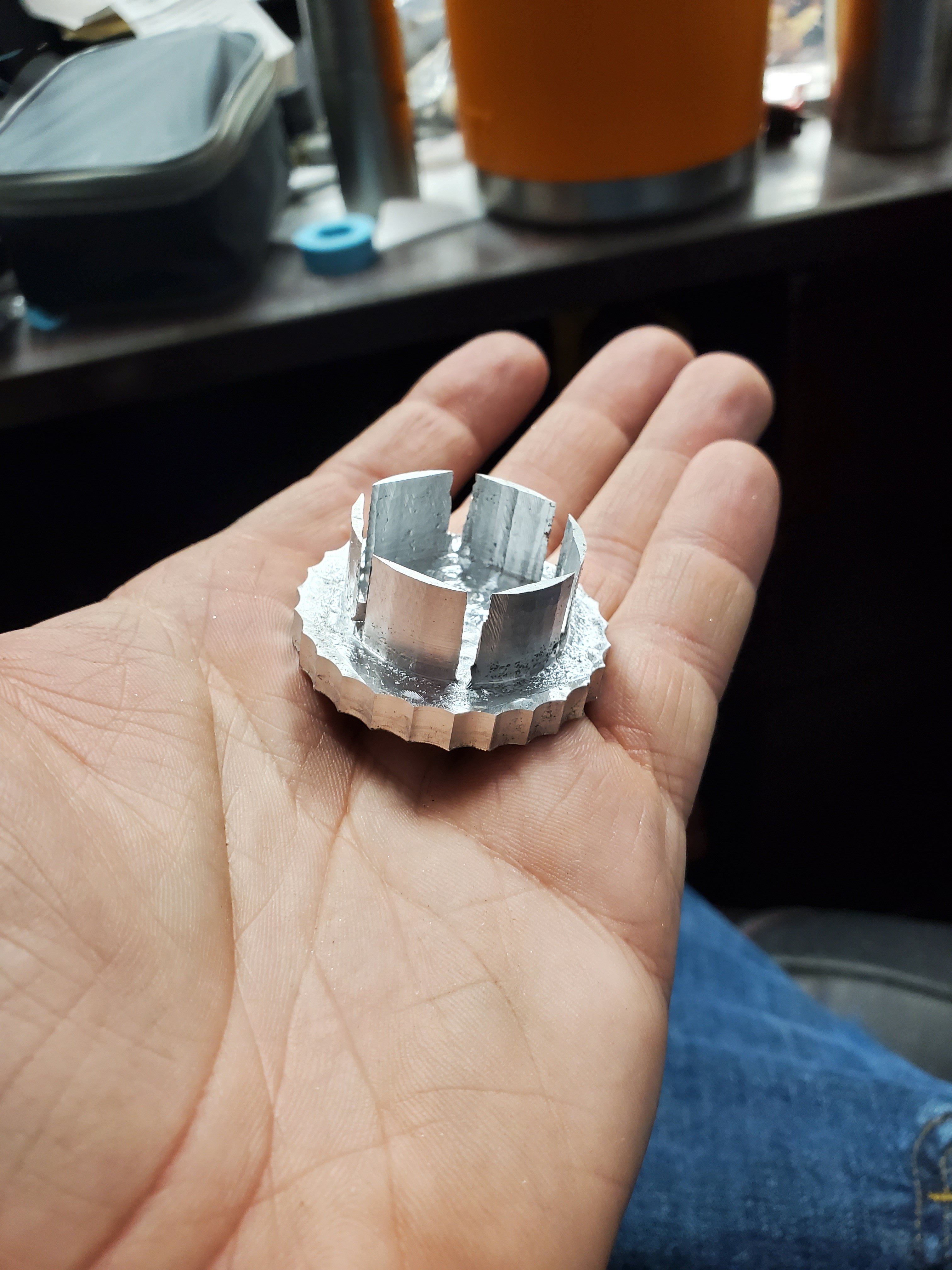

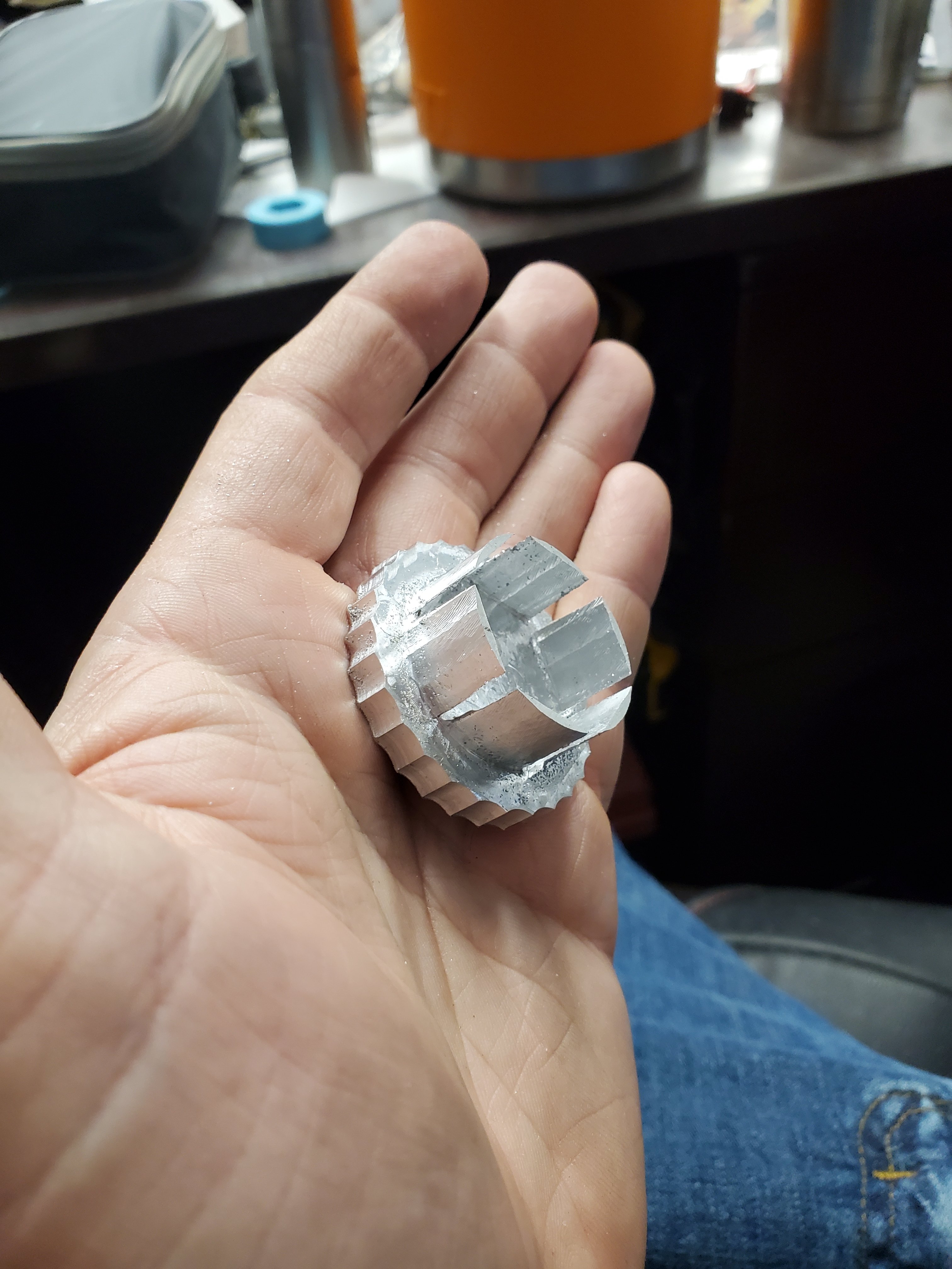

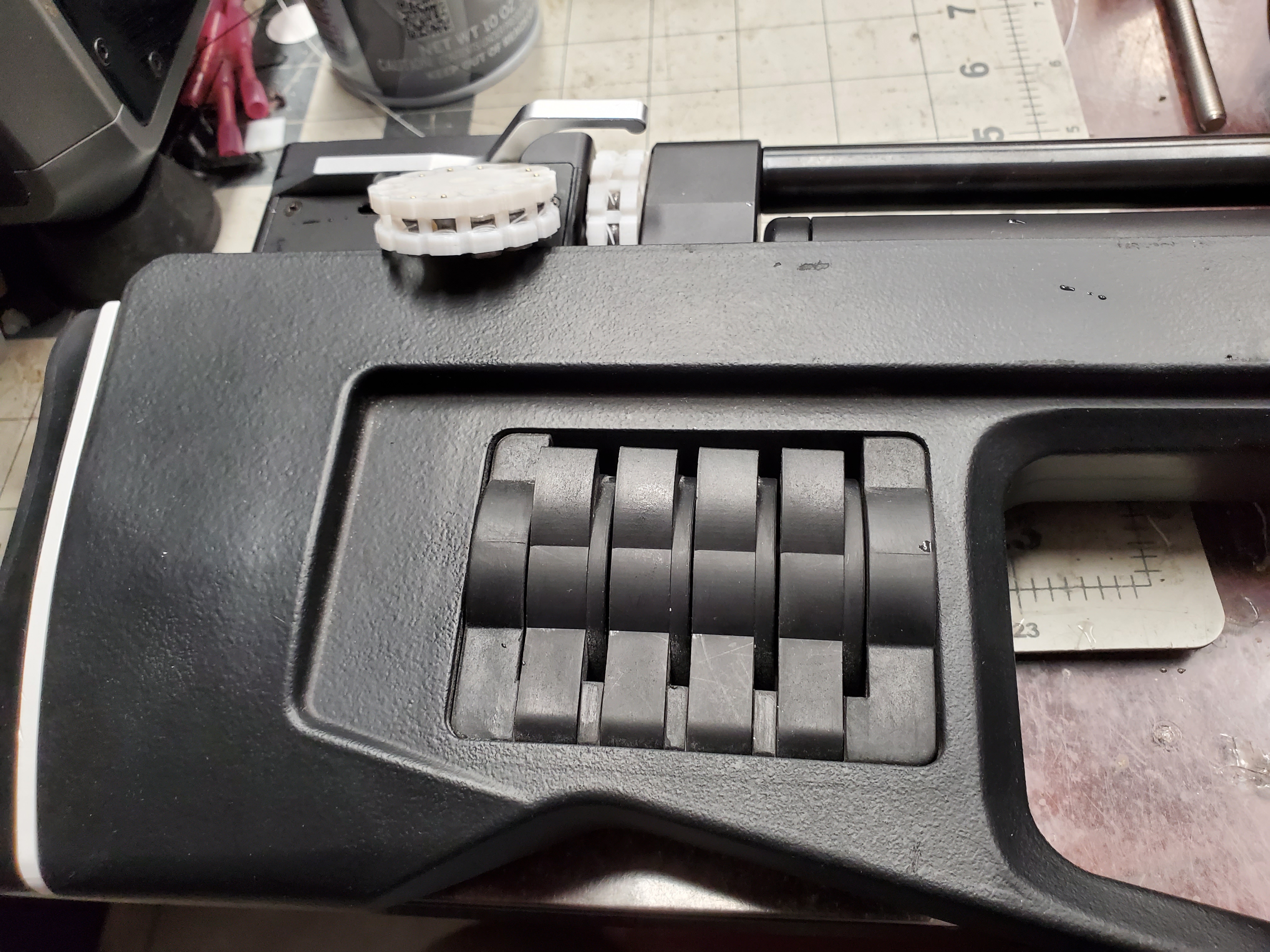

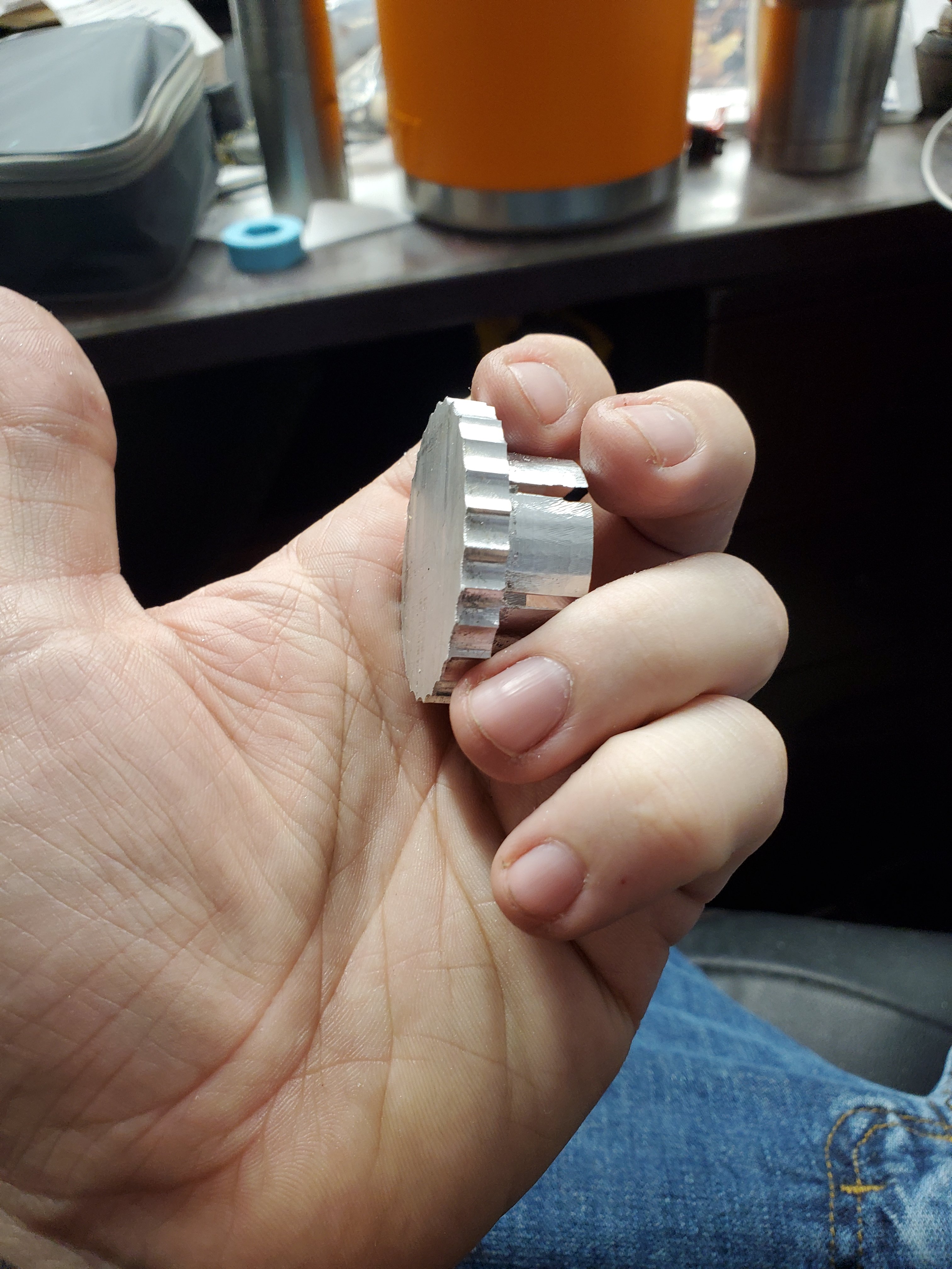

So how does one fit a 27mm socket into a 31mm hole? You can spend copious amounts of money for a special tool, or have one machined down, or go all bucky beaver with a grinder and make a 27mm fit. Or you could draw it out in cad and print something that fits. This works quite well and costs maybe 50 cents worth of plastic. And while I'm at it I might as well make a reg puller, and I've only got two magazines so I bet I can print those too.
