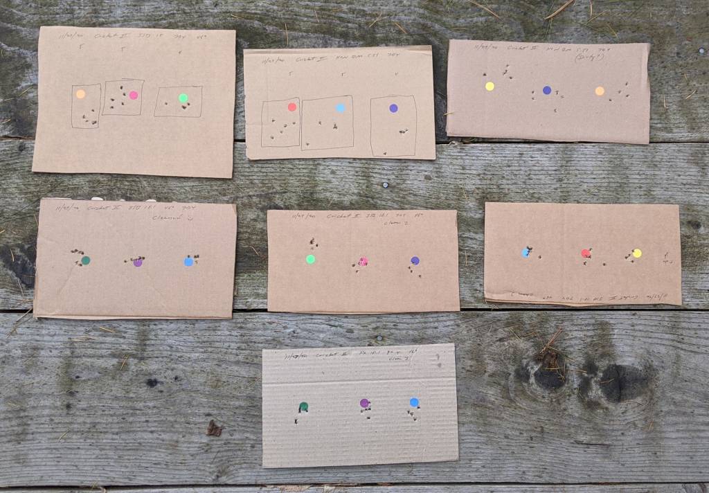

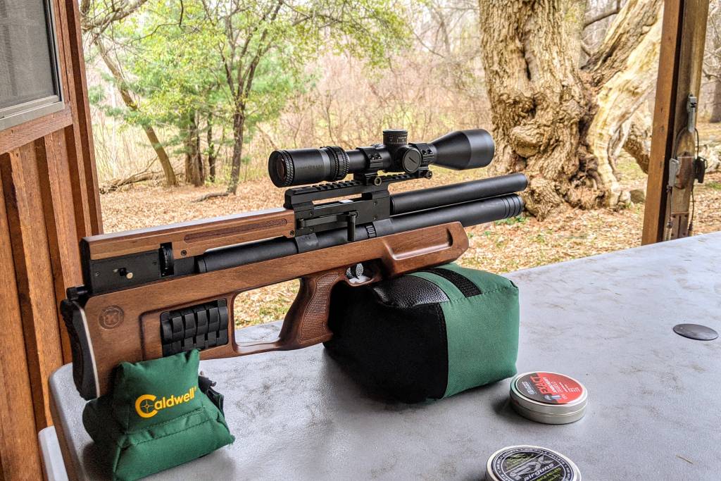

I've had the .22 caliber Cricket II a little over two weeks now and today was really the first calm day that I have had so far. Winds were light at probably 5mph or less (coming from behind me). So today felt right to push out past 50 yards. I set up my bullet box at 70 yards and loaded the first of what would become the 7 magazines (98 shots) I ran through the gun today.
While I'm not going to go through each of these 7 targets, I will mention each target is one magazine worth of shots (14 pellets). And here they all are:

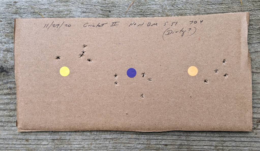

As we all know, shooting at longer distances tends to amplify things. And while I was really looking forward to testing the few H&N Baracuda Match 5.51mm pellets I had left at this longer distance, it became clear that darn it, I think it's time to clean the barrel. It just didn't feel like these 70 yard groups was representative of what the gun had been showing me at 50.
(Note: I shot this target and all the rest of them in groups of 5, 5, and then 4 shots.)

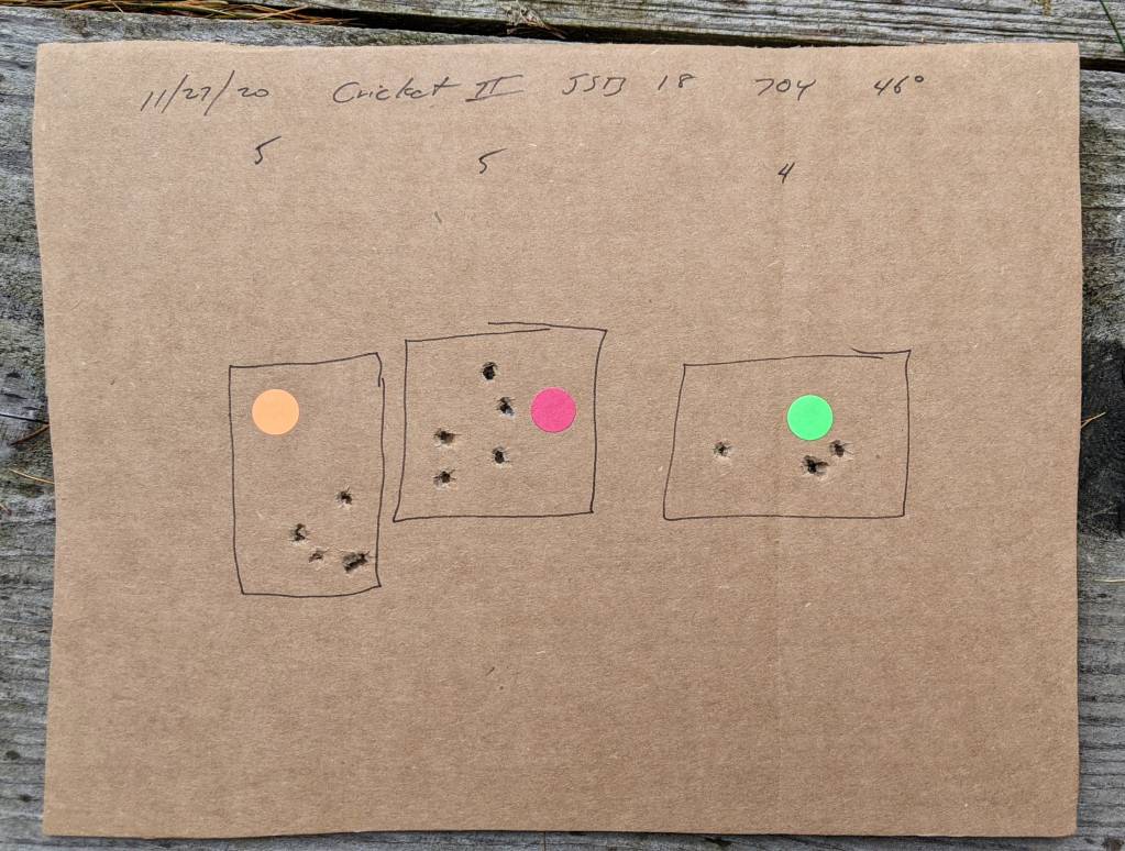

So before jumping to any conclusions, I wanted to shoot my "baseline pellets" which are JSB 18.1s. They were a bit better, but I still felt they should be grouping tighter than this at 70 yards:

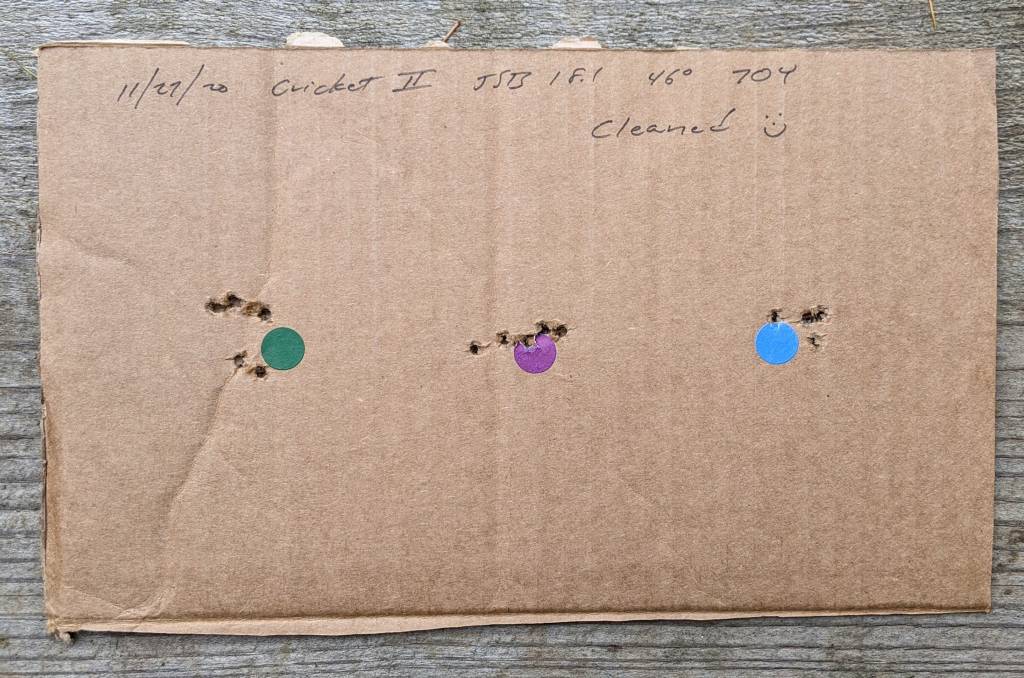

I unscrewed the shroud and pulled 4 ballistol soaked patches through with a patchworm and then pulled one or two dry patches. No major flakes of lead came out but the barrel, but it was pretty dirty. I also noted some lead dust on the outside of the barrel. I'm pretty sure I have between 350 and 400 shots through the gun now at the point of this cleaning.
Sooooo, how's this for an improvement? Not bad grouping for a 27-inch long bullpup at 70 yards!

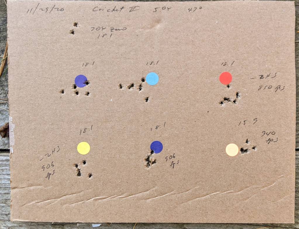

The poor lighting today was giving my Prochrono fits, but I was able to find a spot in my yard with adequate light to record some individual shots (no full strings yet). As originally delivered, the Cricket II was shooting JSB 18.1s around 950 (36.3 fpe). With two counter clockwise turns on the hammer spring the gun was now shooting them at 890 fps. But after a mag or so of shots, they seemed to settle in at about 906 fps (33 fpe).

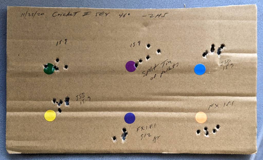

Below is today's 1st 50 yards target . The two really high shots here were from a 70 yard zero (post above). I brought the scope adjustment down and the groups were uninspiring. Winds were variable but relatively light. They were coming from the south (my right) and going between calm and 7mph. I took this as my sign that it's time to play with velocities!
The top right group was the first after the two counter clockwise turns on the HS. BTW, that adjuster is really tight so I'm not too worried that it's going to walk around on its own! I wish my chrony was reading better because I would have liked to see exactly how many shots it might take for the velocity to stabilize after a two-turn adjustment, but between the shots on paper and what I chronied, my feeling is that one mag should be enough. That bottom middle group did make me smile!
I switched to JSB 15.9s for the right group. Those JSBs shot a pretty consistently at 940 fps (31.2 fpe) across this and the next target.
This velocity is probably still kind of hot for these 15.9 grain JSBs, but they did reasonably well. Oh, it's worth noting (and you'll see written on the target below) that one of my groups with 15.9 JSBs was shot pellets split between two tins. I found that pellets from the tin I just opened (a smaller sized one) hit a bit higher and to the right than the pellets from the larger tin I was finishing up. Once I finished up that split mag (center top), I did two 7-shot groups (top right and bottom left) with the small tin 15.9s.
For the last two groups on this target (bottom row) I tried one more thing and switched back to the FX 18.1 grains pellets. These definitely have a different look than JSBs. They're shinier and almost have a machined feel to them.
