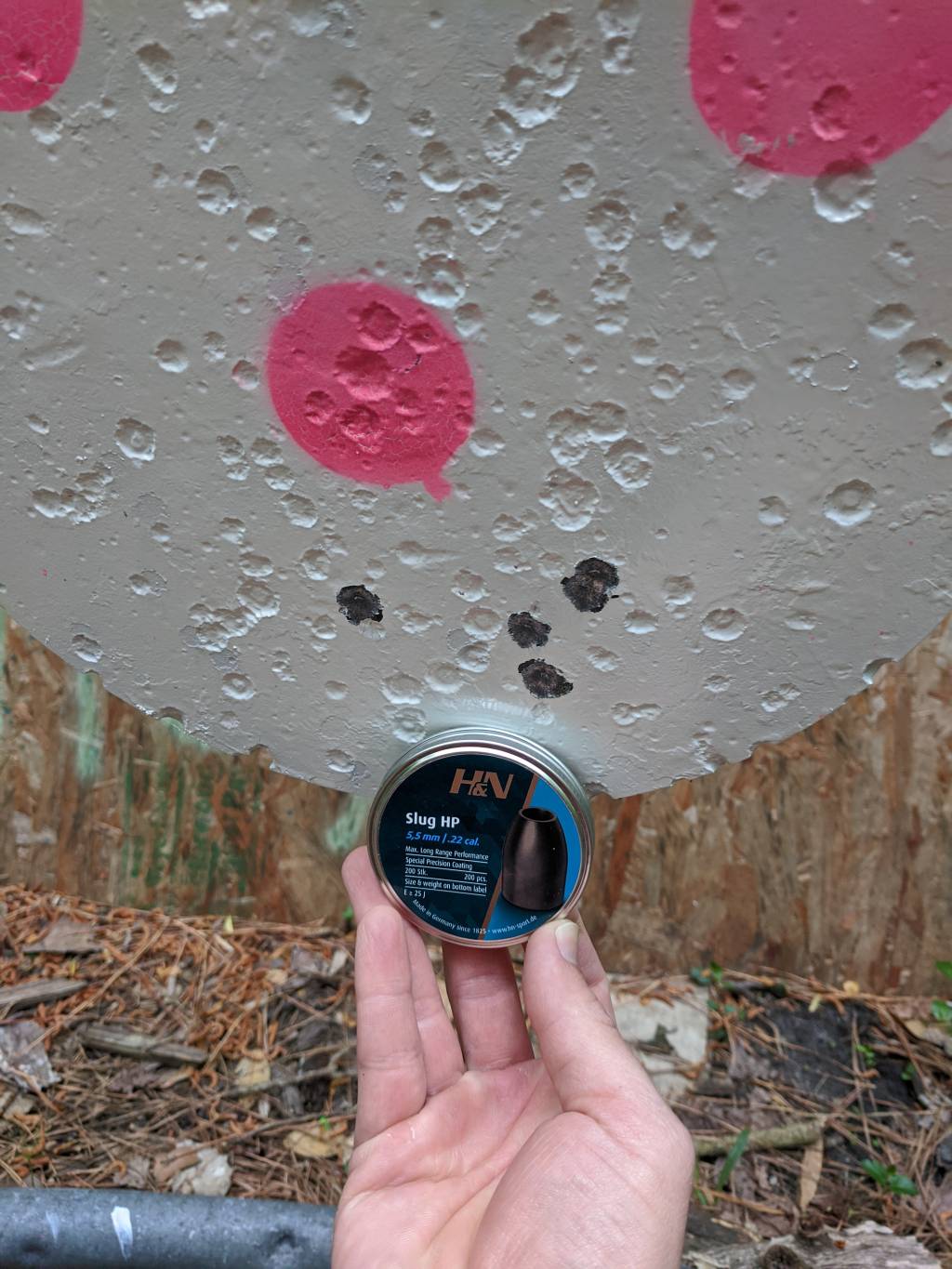

Kalibrgun Cricket II Tac .22 w/ HN 30gr @ 110yd

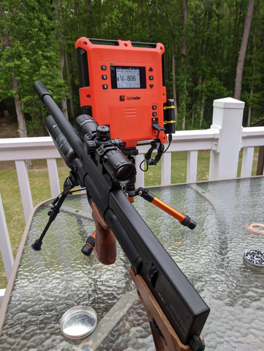

I think these are flying a little slow. Regulator is untouched but I have the Hammer spring maxed out. Same setting will throw a 14.3gr CPHP @ 1099FPS.
Was shooting off of the bipod, no rear support. Scope is 3-9x bugbuster. These slugs seat very tight into the breech (.217). I think I'm going to source some ~20gr slugs to see if I can bring the velocity up without touching the regulator.

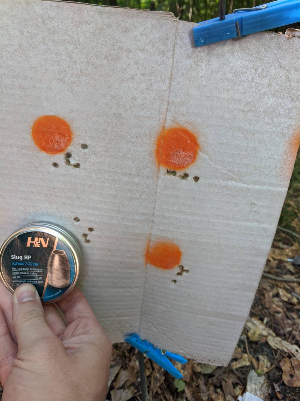

Glad I found this thread. I've had a Cricket II Tac in .22 for about a month now. The only slug I'm having any luck with is the H&N .25 grain in 0.217 diameter, and even that is a snug fit. My groups at 50 yds (with some moderate wind) was been about 1-1.5 MOA. Not bad but not spectacular. I have some NSA 20 and 23 grain slugs in 0.216 and 0.2165 diameter on order.
Like you, all I've done is max out the hammer spring pretension. I don't remember exactly what the speeds were but it was under 900 fps and I'd like them to be around 950-1,000 fps.
Please keep us posted on what you learn and I will do the same.
I'm getting a new optic this week and I hope to be able to do some plinking if the weather will cooperate (currently gusting 20mph +). I'll also try to get some 50 yard groups on cardboard and post those. I think the factory configuration for these rifles is limited to about ~43ft/lbs (or at least that is what mine maxes out at). I ordered mine from krale, so it doesn't have any third party tuning in it. I think I would have to up the regulator and/or flip the plenum if I wanted to bring the speeds up with my current projectile weight. I'm not keen to do that, as I'd be guessing on the regulator set-point and I only have a boosted hand pump as a fill source.
I think I may have finally found a slug my Cricket II Tac likes, NSA 0.2165 in diameter, 20.2 grain, dish-tail. I'm able to keep 10 shots inside a 1" circle at 50 yds. Not spectacular but the conditions weren't ideal and I still need to get the trigger right. It's also still kind of a tight-ish fit into the breach, but not as bad as all the other slugs I've tried.
