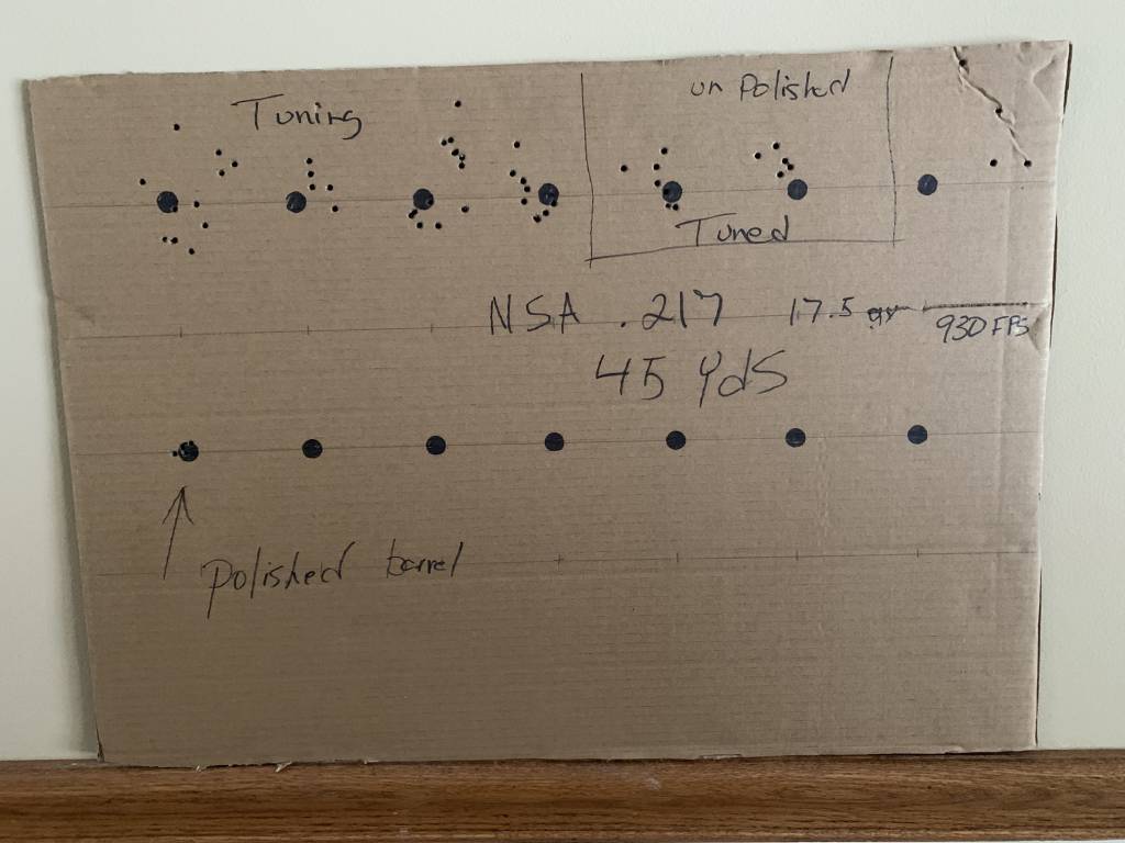

Hey guys I have been working with my compact and NSA slugs and after turning to 930 I had about a 1/14 “ group at 45 yds. Today I removed the barrel and polished it and the result will speak for them selves
In response to the polishing of my barrel I used a .22 J Dewey nylon coated rod ant Tipton .22 cleaning mops with Blue magic metal polish cream. What I did first is clamp the barrel in a vise with rubber jaws to not damage it . I placed the vise on a counter top and used the wall as a stop to protect the crown and . Start by coating the mop with compound insert in the breach end going slow towards the wall about 5 times. Remove the rod and use a new mop coat with compound and go back and forth only a few inches at a time I did this about 10 per 2-4 inches til I reach the stop than I replaced the mop and did full length strokes another 20 times so I probably used 4 mops totally also I forgot to mention start with a clean barrel
