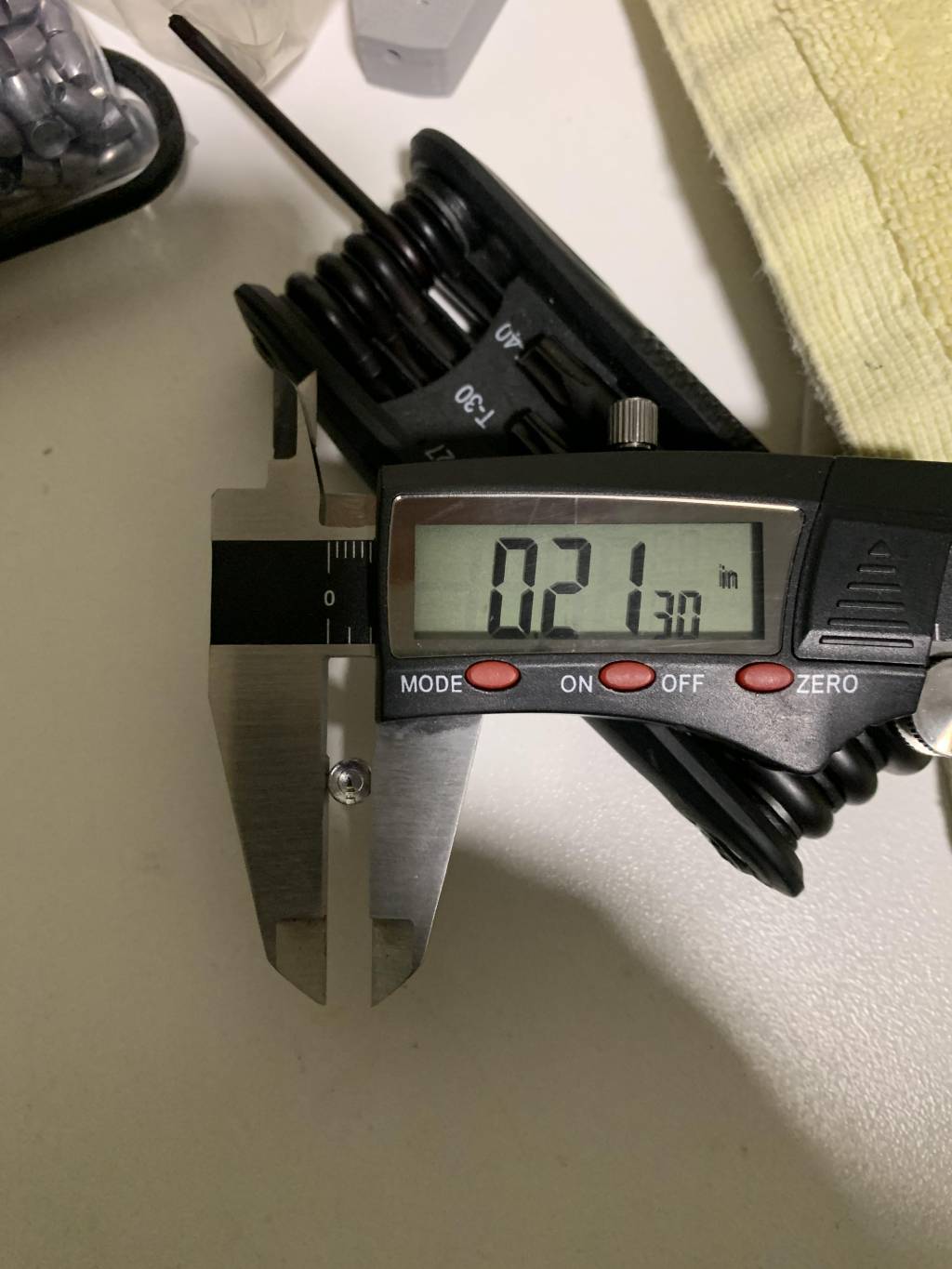

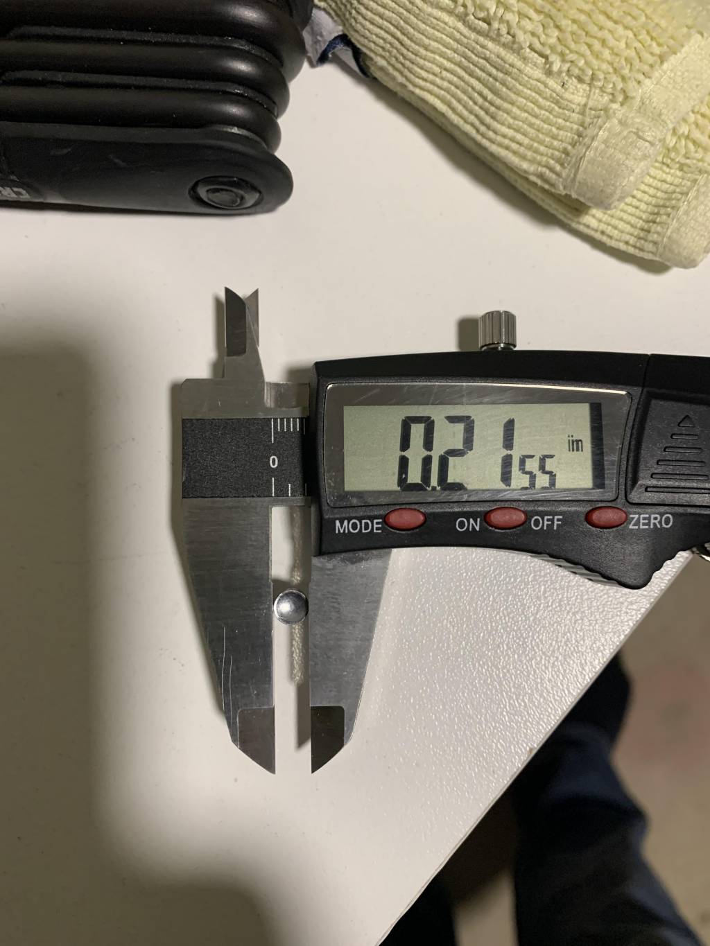

Hello guys as I have mentioned I have the .30 and the compact.22 . I have been testing slugs and I noticed with the.217 size I am getting a lot of lead fouling and I decided to do some investigation and what I discovered is the CZ chocked barrel is actually is .213 so I have bought NSA 215.5 and they Leed into the barrel very nice l will attach photos of a slug before and after
To answer your question most air gun barrels are chocked for the simple purpose to help with the accuracy for pellets and there inconsistency of sizes. So for getting a slug to preform really well in a chocked barrel usually it takes a lot of testing to get really awesome results but with that said you can usually get excitable results in most cases I just want a repeatable accuracy so this why I go as far as I do.
