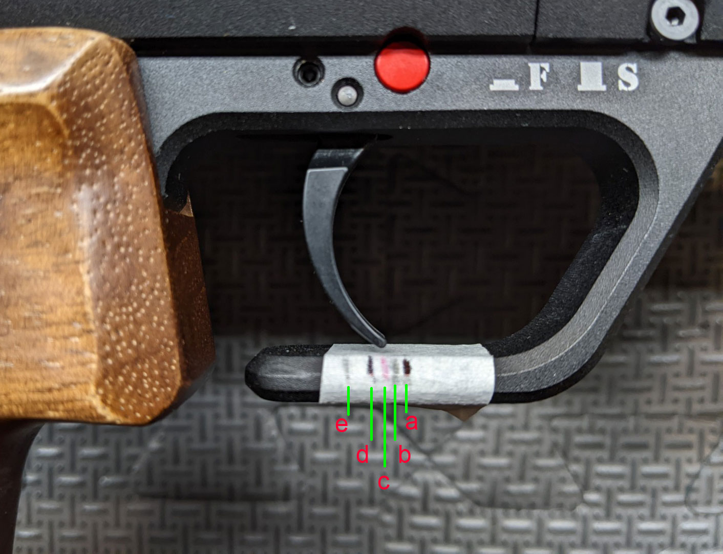

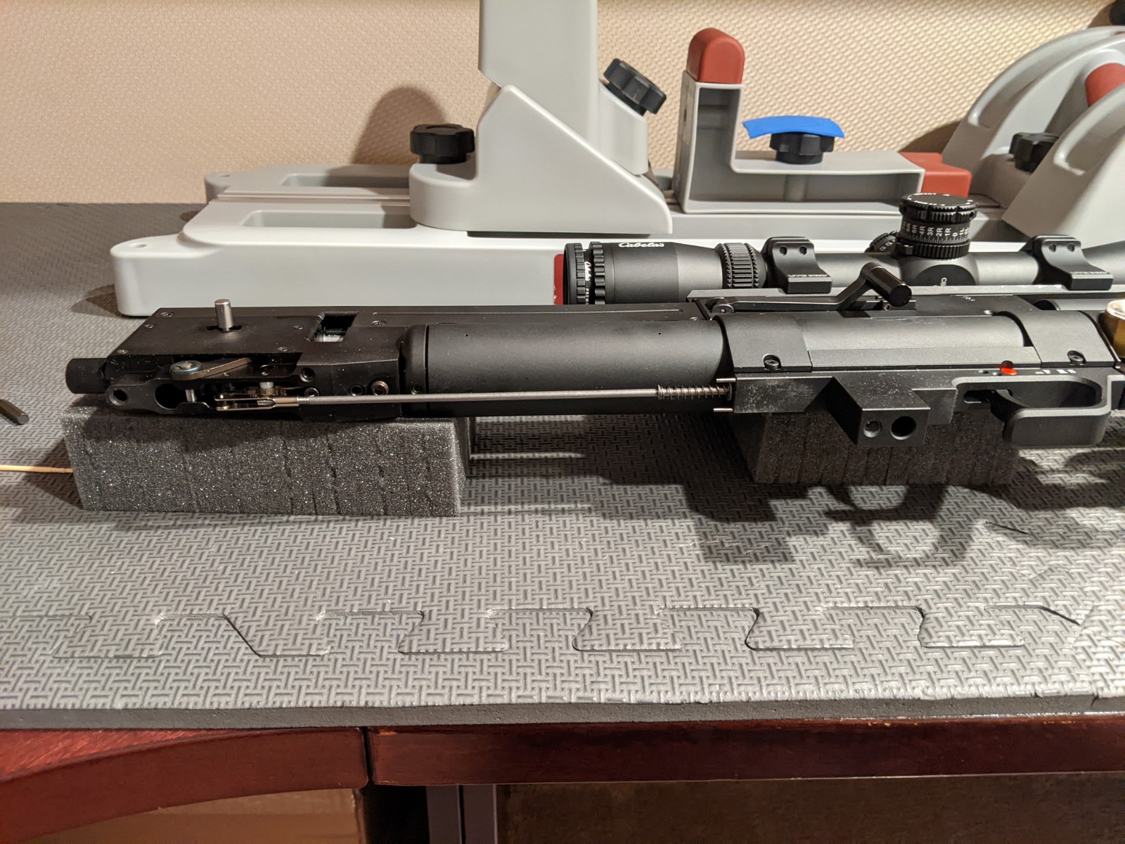

Adjusted trigger blade placement, from position a (cocked)/ b (uncocked) moved to c (cocked)/ d (uncocked).

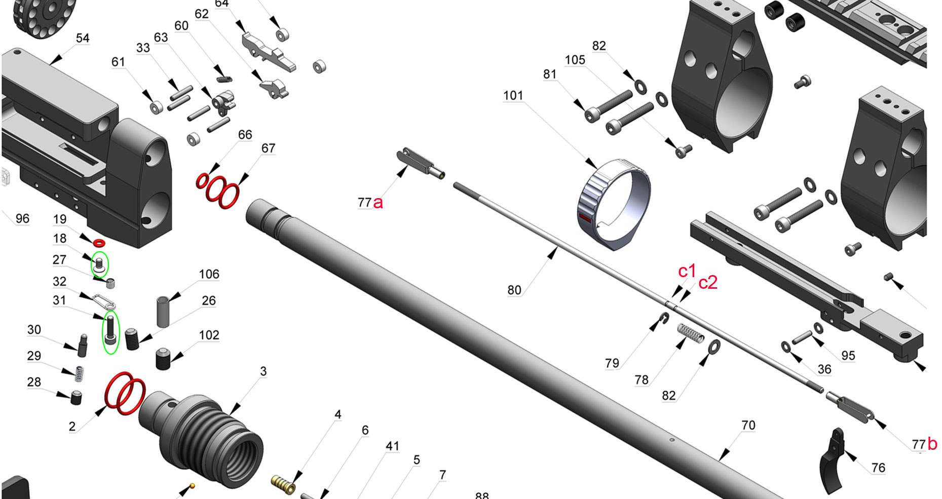

For adjustment, disconnect #77a from #63, then turns #80 trigger rod AND #77a together. (= keep #77a & #80 in place, only #77b moving front or rear.) If turns #77a then both trigger blade placement and 1st stage trigger pull force will change.
Adjusted 2nd stage trigger travel.
2nd stage trigger travel = engage length of top and bottom sear. This a my hunting gun. For safety reasons, I set it up a little bit long. If you want a "hair" trigger, asjust it shorter.
After 2nd stage trigger travel adjustment, the cocked trigger blade placement will move. So if you want full adjust the trigger, do this step first.

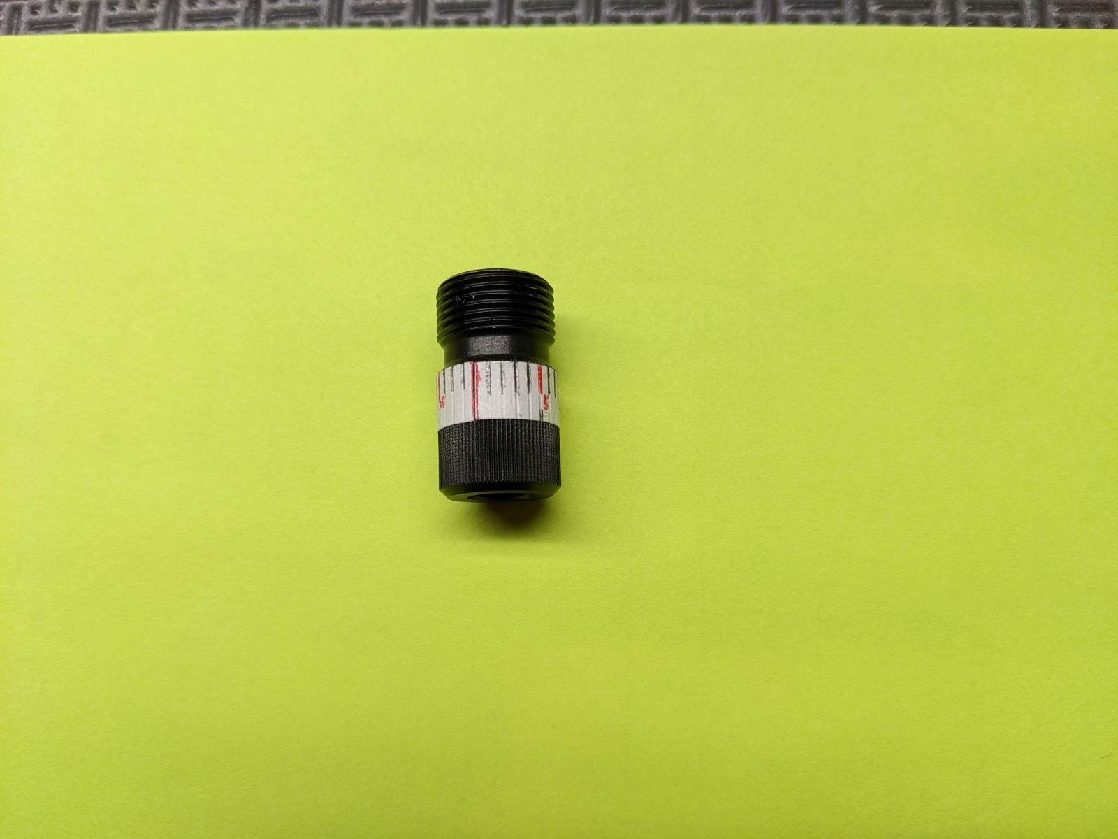

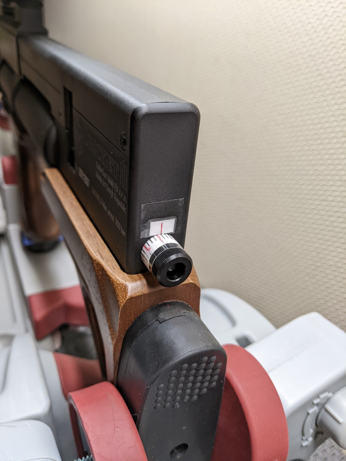

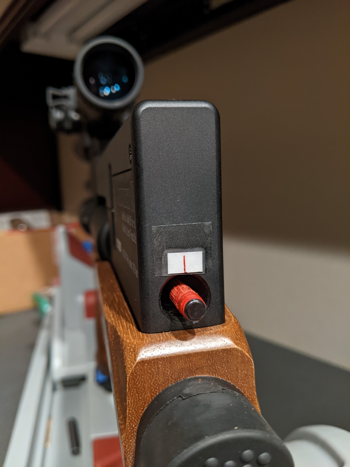

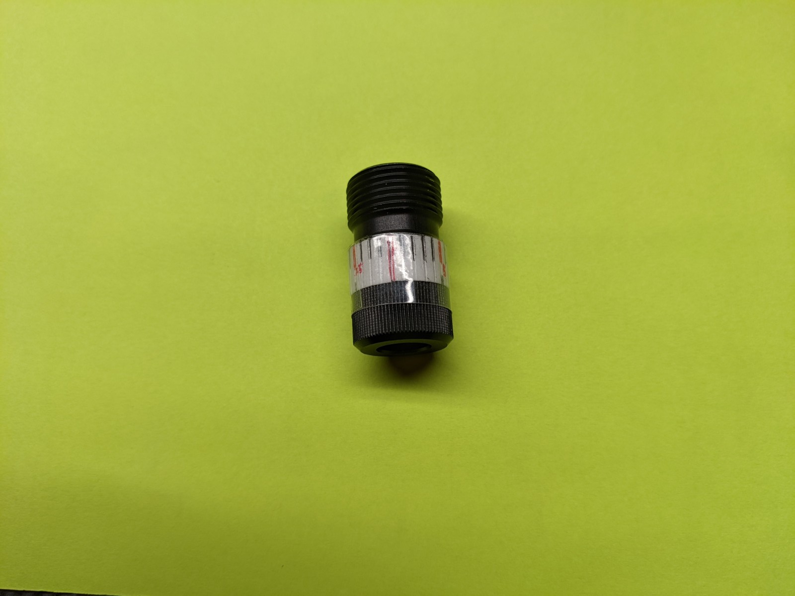

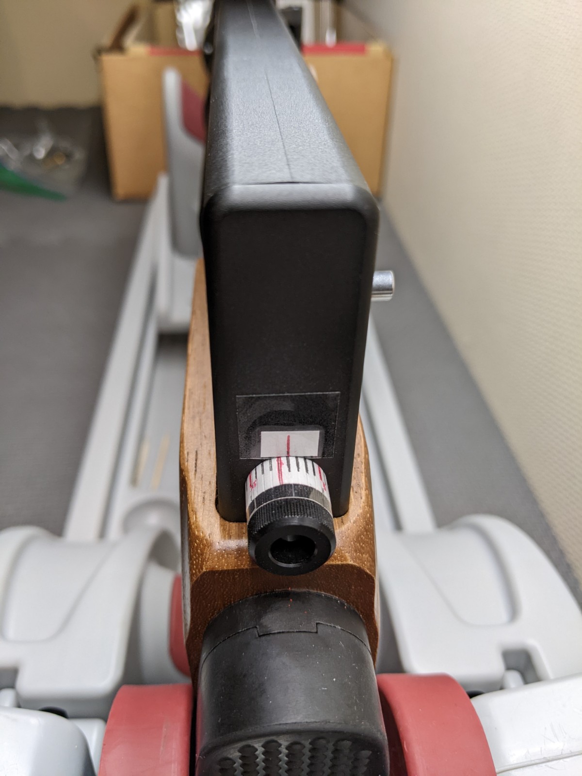

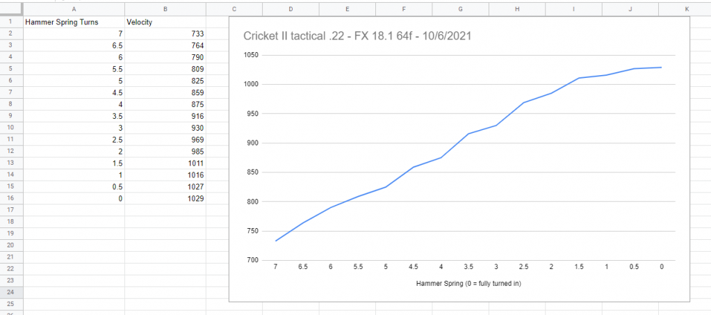

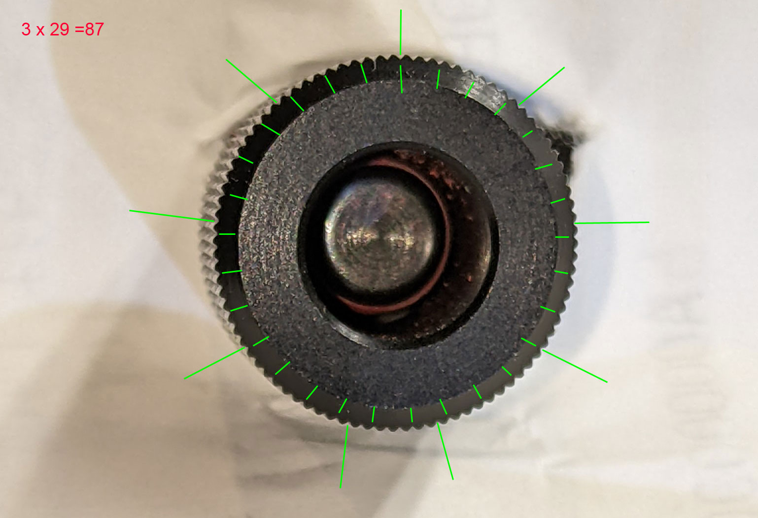

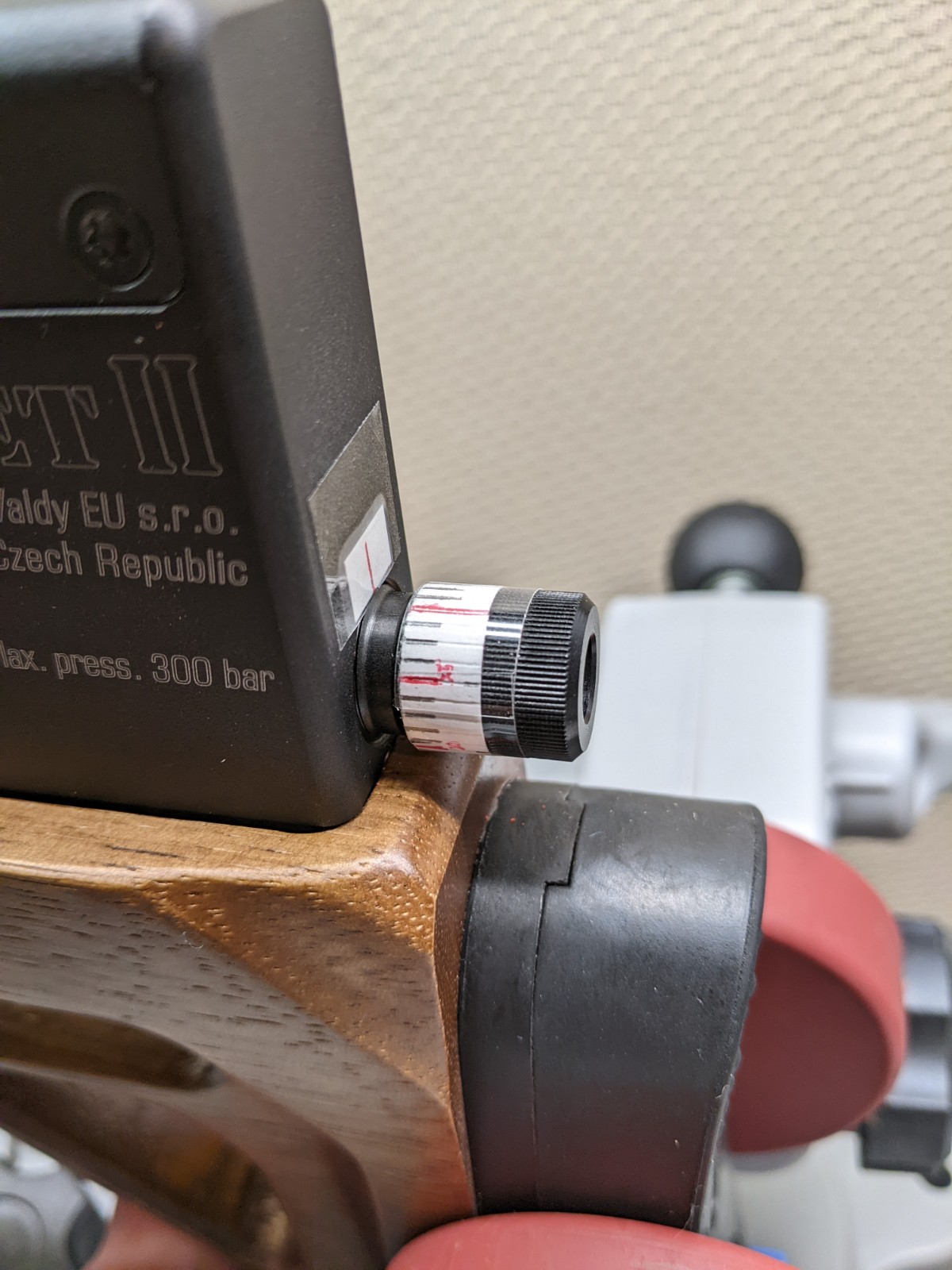

@mcoulter got 960 fps at about 2.6 turns with FX 18 gr.

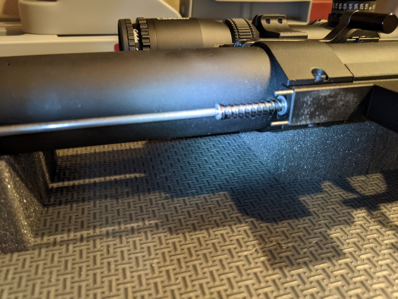

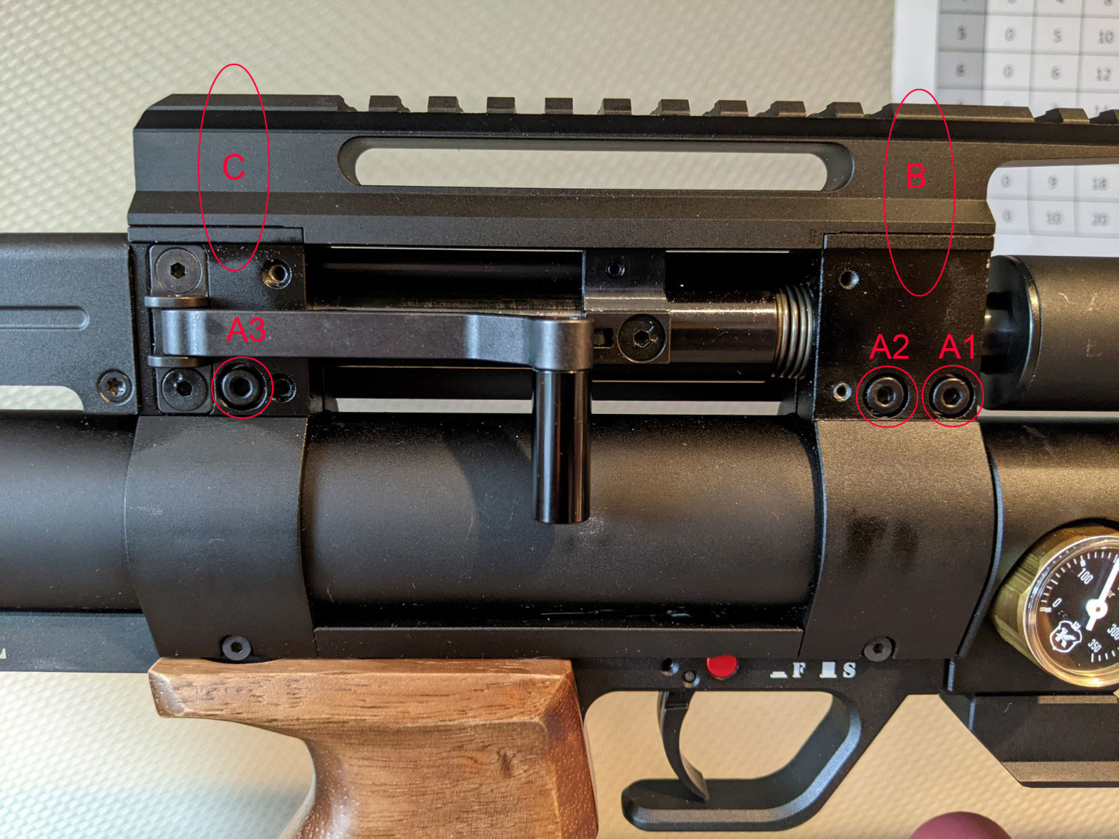

I bought the Cricket II Tactical 60 off of the forum. The barrel is loose, it rotate when screwing on the shroud. I can easy rotate the barrel/shroud just by 2 fingers.
After some homeworks, now I know how to do it.
The front/rear clamps are only parts to hold the barrel. Screws (A1/A2/A3) are used to tighten clamps to hold barrel and air tube. The screw is M4x16.

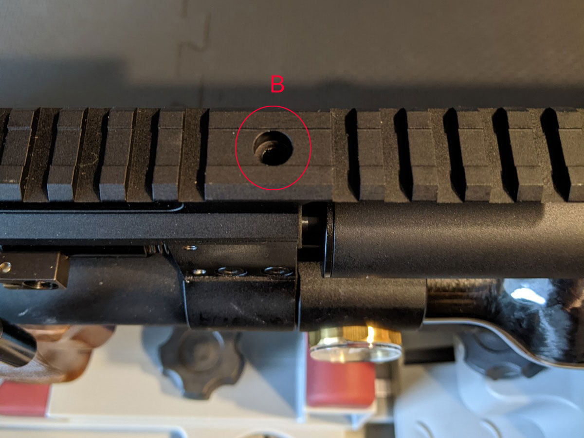

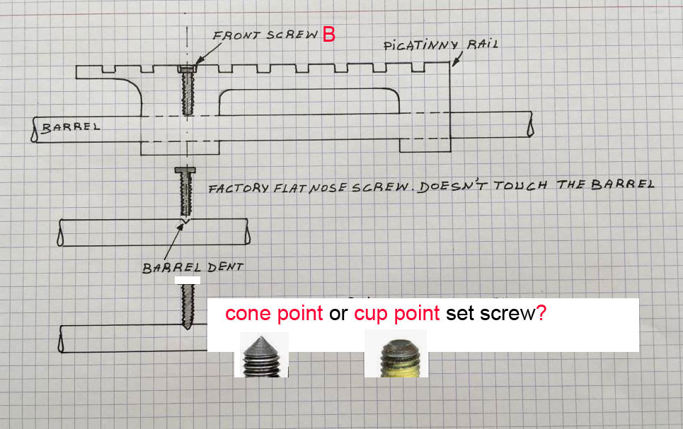

The barrel has a little dent, set at exactly 180 degrees of the barrel port. When fitting the barrel, this dent must be seen through the front screw hole in the picatinny rail. This means that the barrel port and the transfert port are exactly aligned. A pointed barrel locating set screw is used when installing the barrel. It is then taken out once clamp is tightened and is replaced with a normal bolt. The front picatinny rail screw (B) is M4x25, so the set screw is M4.
My questions are:
1. the set screw is cone point or cup point?
2. torque for the 3 clamp screws (A1/A2/A3)?
3. torque for front picatinny rail screw (B)?
4. torque for rear picatinny rail screw (C)? It's M4x20, 5mm short than front screw, only about 3mm thread in clamp, right?
