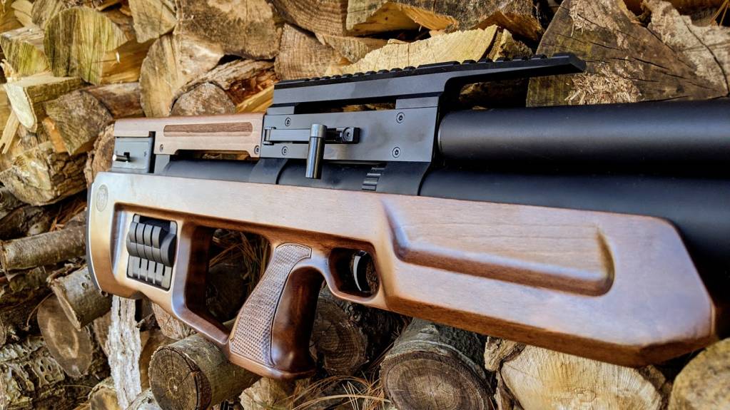

Kalibrgun Cricket II WB .22 has arrived!
And the cheekpiece is screwed down.
Nice little improvement.
Yes, the cheekpiece is very well designed - especially considering what's on my .25 which I assume is probably an older model. I had a couple of close calls when I got my .25 where I went to grab the gun by the cheeckpiece only to have it slip off and (ALMOST) drop the gun! This design was only held on by a little natural clamping action. The plus side of this older style is that it's not as angular as the nice wooden one on the Cricket II and feels a bit more comfortable...

Grats! Very pretty wood on yours.

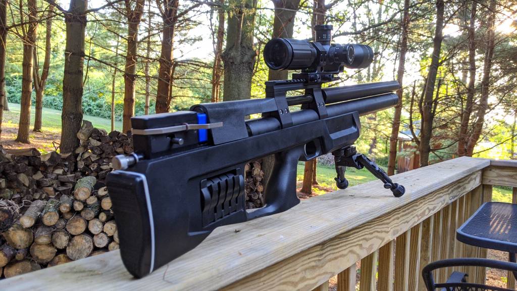

Happy Friday folks! It's been a busy week and I have only put a few magazines through the Cricket II so far but I'll do a brain dump of initial impressions and observations here. I fully expect to spend some "quality time" with it over the weekend and will dive into more thorough accuracy and chrony testing!
  • It’s GREAT that the fill probe came with a quick connect. What other sellers do that on a new gun? Charlie also includes a crown saver pull-through cleaner, several mags and orings.
  • The pressure gauge only has markings for 100, 200, 300, and 350 bar. I do miss having finer markings on the gauge.
  • The gun's air cylinder fills much more quickly than my .25. I think the .25 has some flow restrictor where the newer Cricket II doesn't
  • I was initially bummed that Kalibrgun does not include a picatinny rail for a bipod, but even a short rail would take up too much room on the fore-end of the gun. I'll likely be adding a swivel stud for a bipod. The wood is plenty beefy up front for one.
  • I had first used the Sightmark Citadel scope (and rings) on my Brocock HP. I literally took it mounts and all and dropped it on the Cricket II. There was a substantial difference in elevation (shot high on the Cricket II) but the windage was VERY close between the pic rails on the two guns.
  • The cocking mechanism has a LOT of lubrication on it. I'm imagining it'll be a dust magnet. I'm going to keep an eye on this... My thoughts are to keep it as-is for a tin or two of pellets and then eventually start cleaning some of this off.
  • When I was examining the shroud and snugging it down again I found that the barrel rotated (perhaps due to the excess lubrication noted above?) and I had to re-index the barrel to make sure the transfer ports lined up properly. This process is the same as my .25 cricket which involves removing a screw that goes vertically into the scope rail and then using a long smaller diameter threaded screw to go down and find a detent in the barrel. The side plate had to be removed to access the barrel clamping screws. All-in-all simple enough.
  • I'm still finding myself reaching to the back of the gun to cock it! Old habits die hard...
  • The gun is backyard friendly and makes a pretty distinctive "ping" sound like my .25 when firing.
  • Inserting the magazine into the receiver is becoming easier already. I realize how much I like this style magazine vs. the Brocock magazine.
  • The trigger is quite good but has a different feel from my .25 cricket. It's like the 1st stage is just a bit heavier than the .25 which makes the 2nd stage slightly less distinct. I have not even removed the stock so I don't know if the trigger linkage is the same as the older models or not.
  • The stock is VERY comfortable and has a great feel. The fore-end is broad (almost chunky feeling) but it's nicely contoured and the grip checkering is just right.

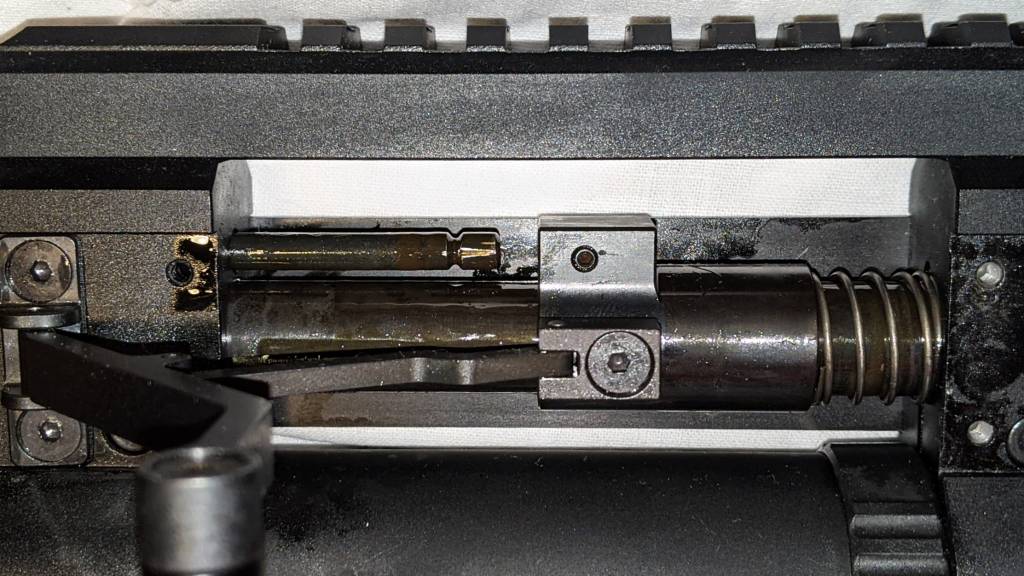

Well, I had been meaning to take the barrel off but this was not my ideal time. Oh well. I bring it inside and take of the side plate to expose the barrel clamping screws and I see this... the cocking link separated. This was causing the probe to not seal as it should (and sound like a blown inner o-ring):
To make a long(ish) story short, it wasn't a hard thing to fix, but I took my time, took lots of photo and some video, got it back together, adjusted it properly and the gun is shooting well again today.
Either the grub screws backed out a little bit and allowed the linkage to come apart, or the linkage wasn't inserted quite far enough and grub screws were not seated in that little groove in the linkage arm.

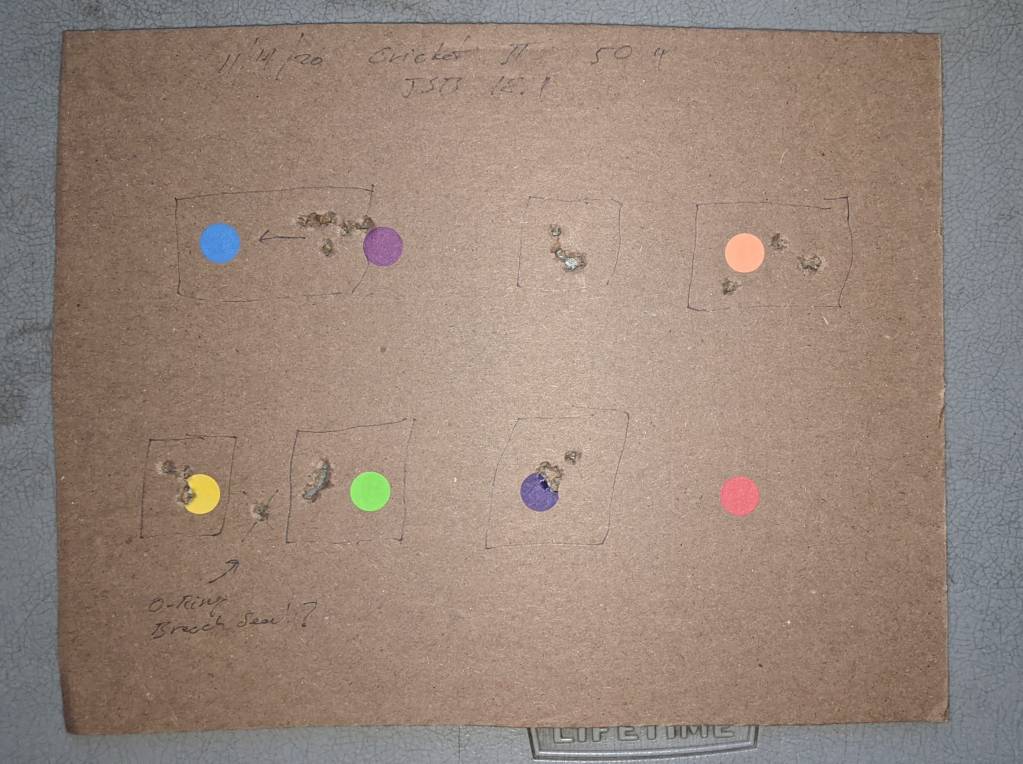

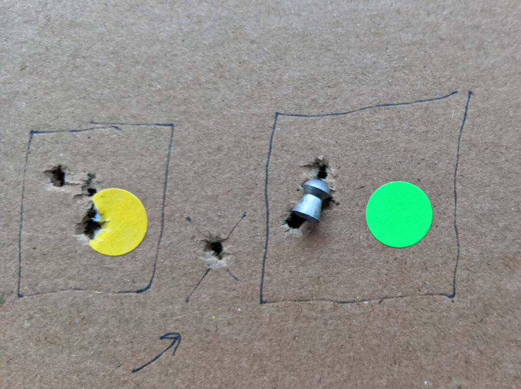

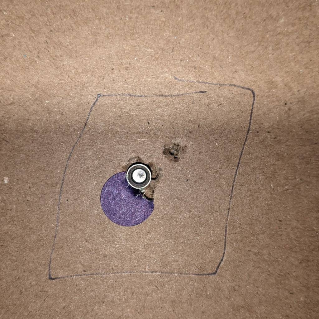

Here's the flip side of today ----> HOLY COW, IS THIS GUN ACCURATE!
Here are a couple of closeups of 50-yard / 5-shot groups. These were with JSB 18s.
And here's the full target (such as it is). The top row are groups shot just before the linkage separated (which was what I originally interpreted as the barrel o-ring going).
In fact, I think that top right group was opening up as the linkage was coming apart. You can see my note on the bottom row where I thought the breech seal blew. The yellow, green and purple stickers were all 5-shot groups with the gun sounding good and strong again.
So all's well that ends well :)
Matt, I greatly appreciate all of your up front and honest review work. As far as the linkage, I can't say for sure what caused it to come loose other than the grub screws weren't properly aligned or tightened. I can assure you of this, I will be double checking every Cricket bullpup to make sure that does not happen again. I think this is a small glitch in the learning process of making a modified cocking system work reliably.
I will be sending you two tuned and polished magazines to see if you think they make for an easier cocking stroke over the untouched magazines. These magazines will have the detents ramped and polished along with the center bore being polished, I have found it to make a noticeable difference here, I value your evaluation.
