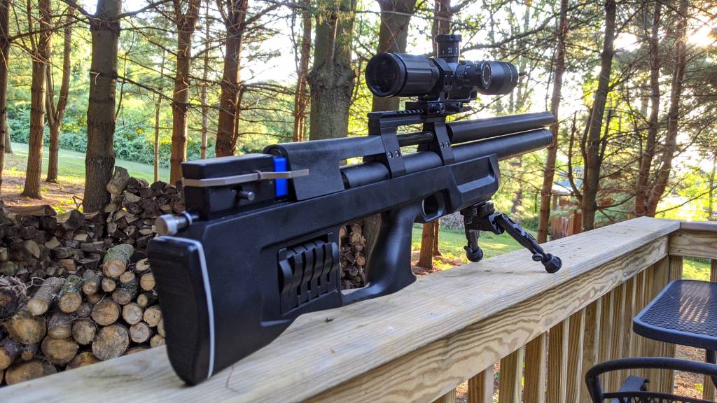

Kalibrgun Cricket II WB .22 has arrived!
The sidelever can be switched to either side, Jimmy.
Wonder is there is a set screw on both sides of the lug that mates with the linkage. I'd clean those bore threads & set screw threads to add some Vibra-Tite medium (blue). I wouldn't want that ever happening again.
Yup, there are set screws on both sides. And vibra-tite was exactly my though too in an effort to keep this from happening again. I just want to get some magazines through the gun to make sure that my linkage arm adjustment is where I wanted it to be.
And here's their page to confirm that the side lever IS switchable:
https://kalibrgun.com/weapons/cricket-2-standart-wb-cal-55-22/  (Cocking system Side lever - switchable(left/right)
I am left-eye dominant, but I'm honestly not in any hurry to change this. Having my left hand on the grip and trigger has always felt "normal" to me. No doubt that sometime in the future curiosity will get the best of me!
Matt, I greatly appreciate all of your up front and honest review work. As far as the linkage, I can't say for sure what caused it to come loose other than the grub screws weren't properly aligned or tightened. I can assure you of this, I will be double checking every Cricket bullpup to make sure that does not happen again. I think this is a small glitch in the learning process of making a modified cocking system work reliably.
I will be sending you two tuned and polished magazines to see if you think they make for an easier cocking stroke over the untouched magazines. These magazines will have the detents ramped and polished along with the center bore being polished, I have found it to make a noticeable difference here, I value your evaluation.
Thanks
Charlie Frear, Georgia Airguns

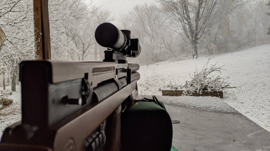

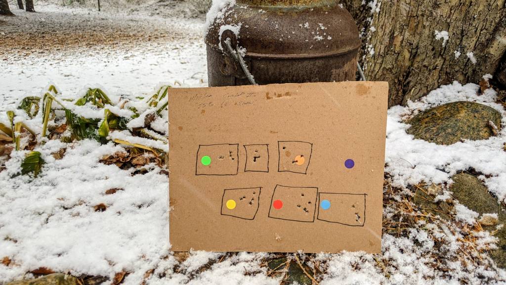

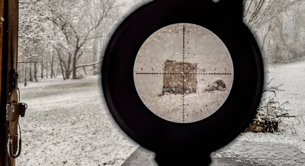

This is what 50 yards looks like in a lake effect snow squall.
It does not look as bad in the video because I placed my camera about mid-way between my bench and the target!
https://www.youtube.com/watch?v=o4PAtbH353w
The results were decent given the conditions!
