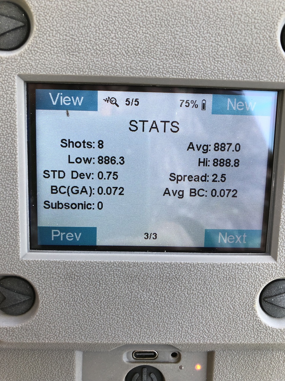

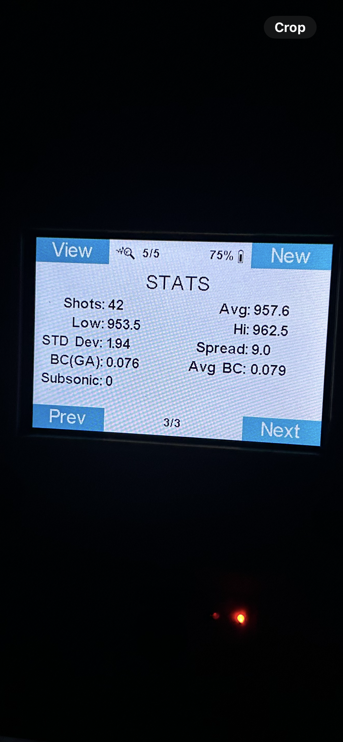

Where did the 0.076 BC come from? I think he told me the avg was 0.072. Still pretty awesome. I get about 0.066 with my Delta Wolf from those pellets. I’m curious if it’s because I’m at 885 fps and Derrick is at 940 fps. I know theoretically from @Ballisticboy Miles posts, it shouldn’t change with speed if the profile is accurate for the pellets, but G1 isn’t even close.

Yes. That has been known and published for many years. I was questioning the BC variance between “old school” speeds from 850 to 900 fps and “new school” speeds from 940 to 980 fps. I know that around 0.066 to 0.074 has been published for the Pandy with 50.5 AEA at 940 to 960 fps. I tested this last weekend with my .30 Delta Wolf at 885 fps and got the same BC. So if accuracy for the Pandy is equivalent at both 880 and 960 fps from a bench at 100Y, with the same BC and wind resistance, what is the benefit of the faster speed? I can think of many cons but no pros. Things that make you go hmmm…
