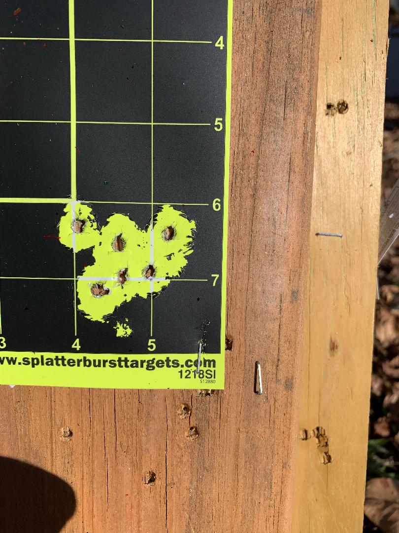

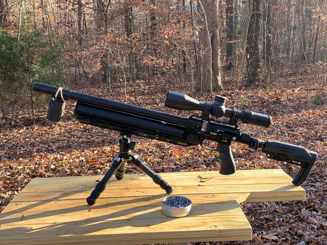

Got mine a couple of days ago and so far put around 500 pellets through It . Why Is It a Frankenstein gun you ask well the air tank and trigger are straight out of the AEA parts bin and maybe the regulator and fill prob .

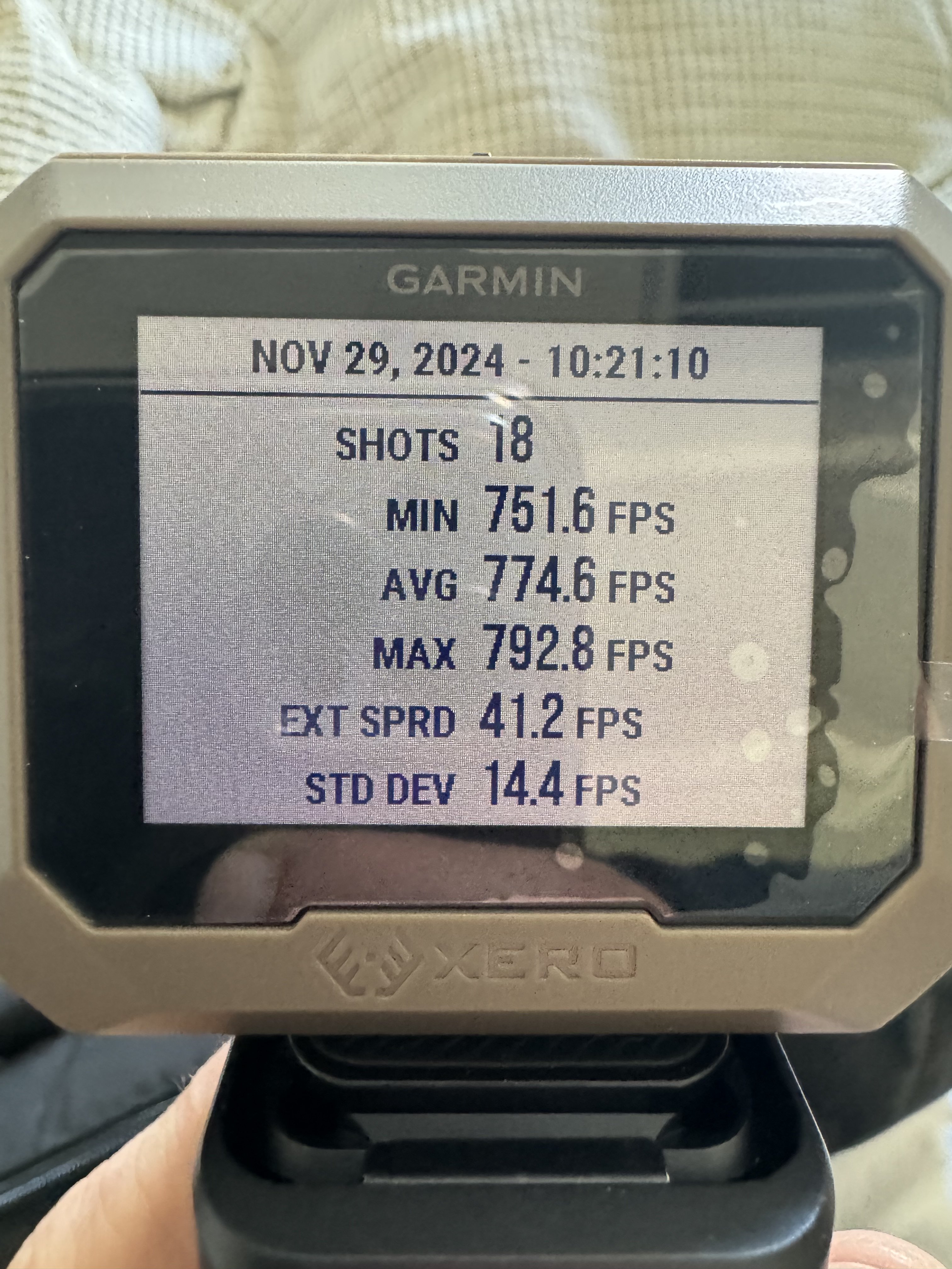

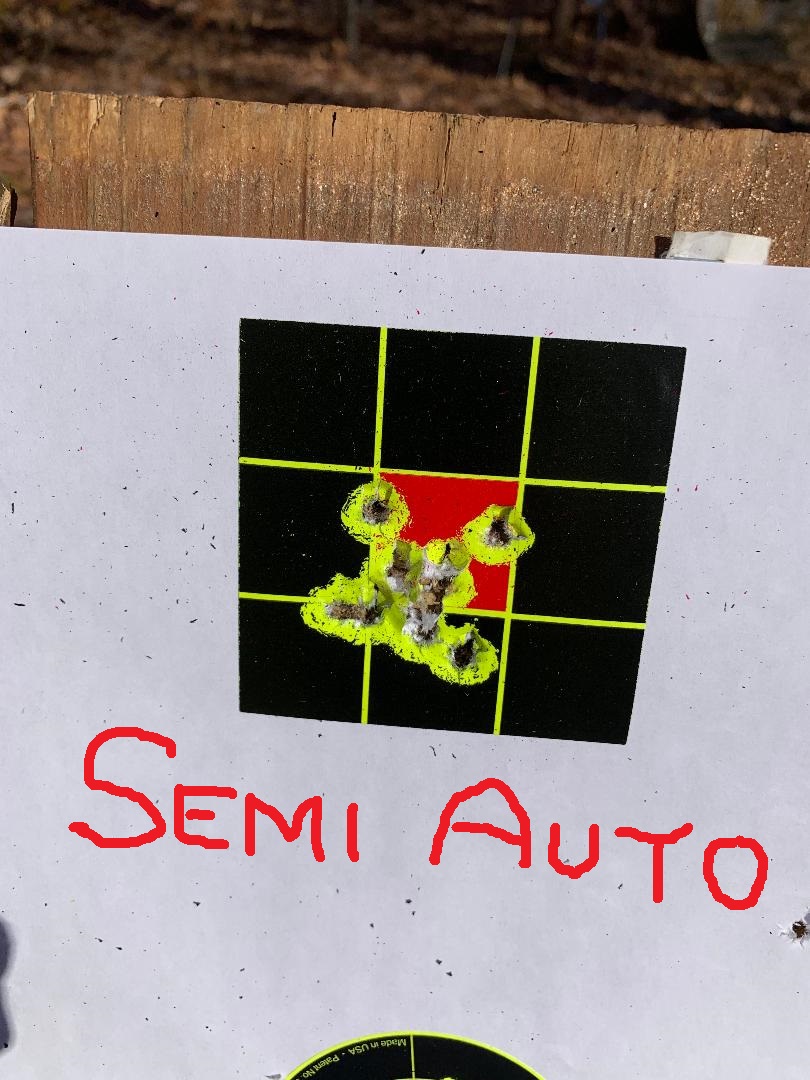

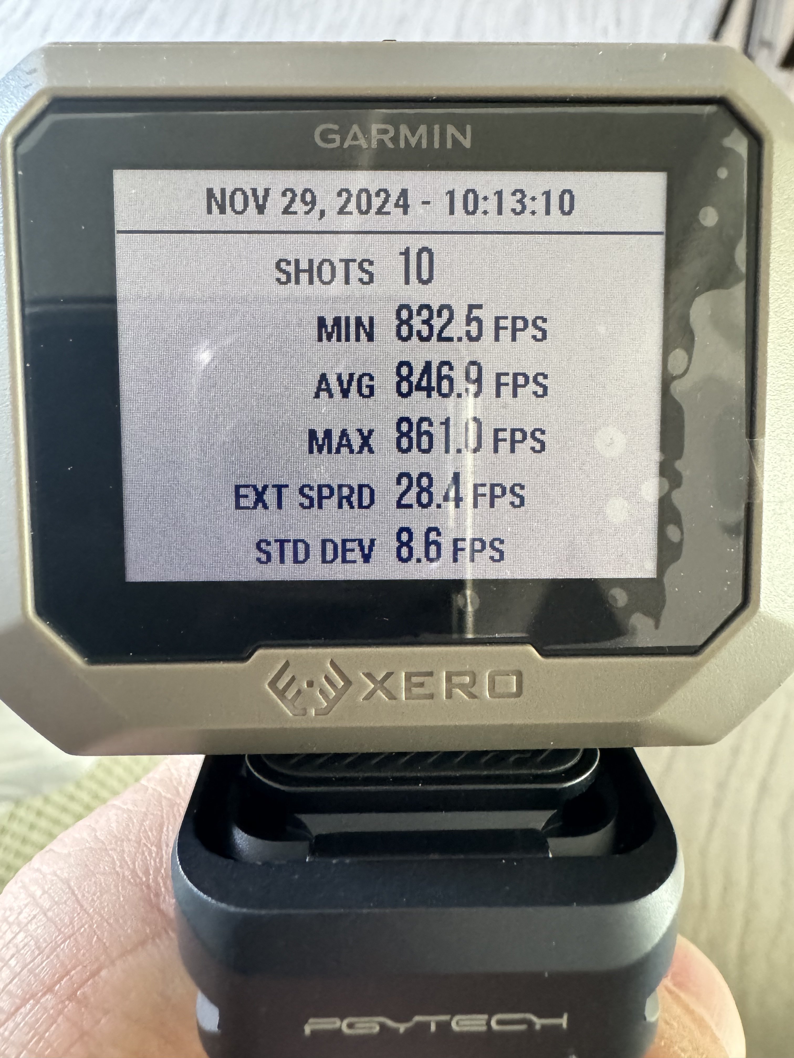

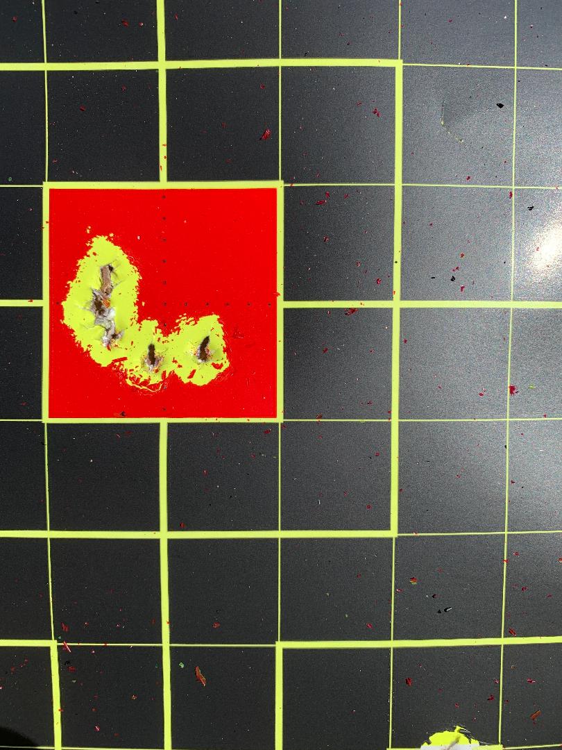

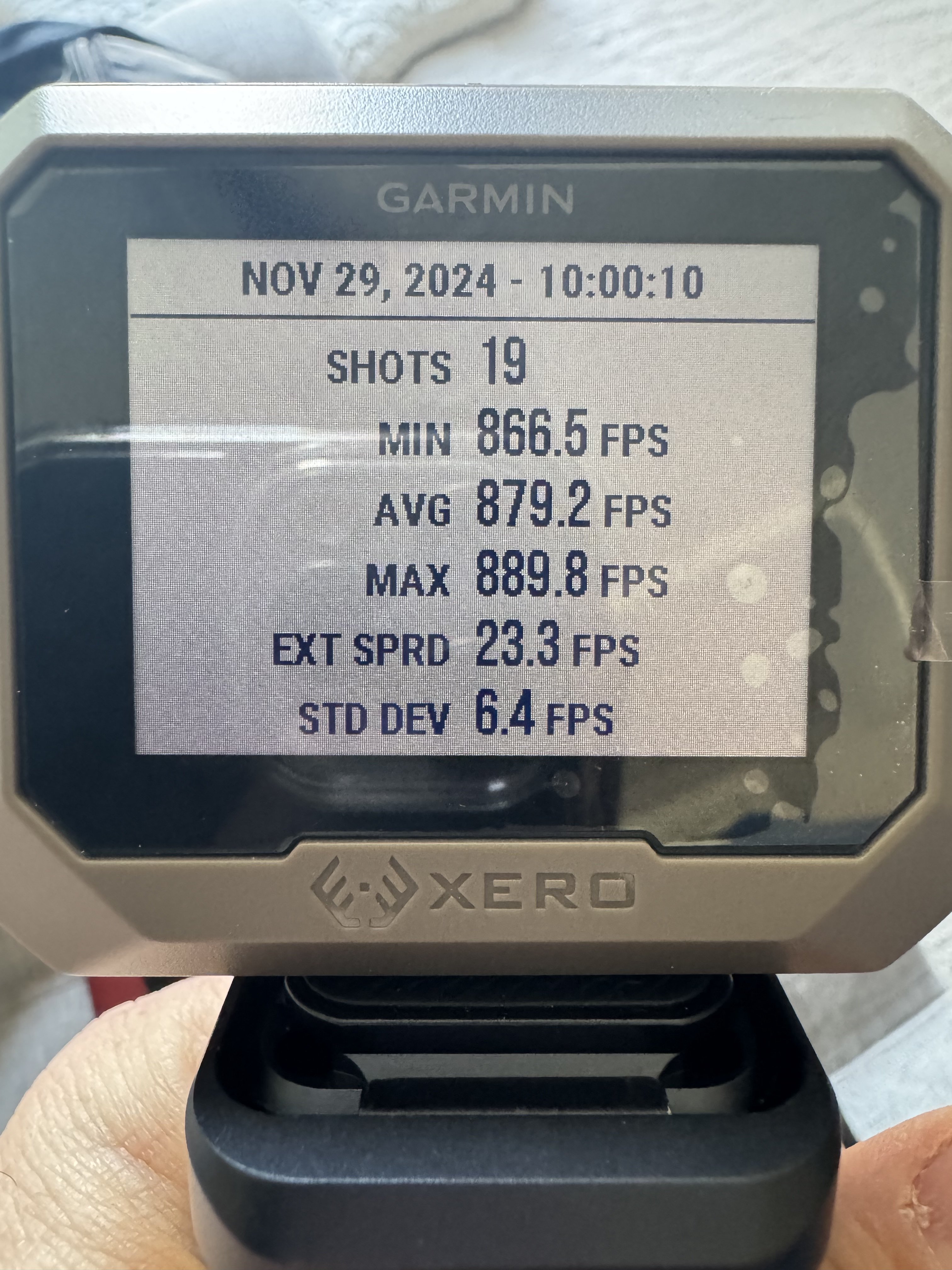

Cons ...$1400 gun and no adjustable trigger !!! wish I had know that before I bought the gun but that's on me I guess , trigger sucks no first stage maybe a 2ib pull weight like I said not adjustable , accuracy using JSB AEA JTS 18G pellets out to 55 yards no wind about a 2" group after 500 shots I would say the gun Is broken In I was hoping for better , my gun does not de-cock you have to shoot It to empty the chamber , Hammer spring all the way In or out didn't make a bit of difference to FPS , fill prob when screwed all the way In Is way below the arca rail which means you cant get a regular fill adapter on It you need an extended fill adapter ( not supplied ) , 50 shots , standard deviation 27.4 FPS 153 FPS spread first shot 995 last shot before it fell of the reg 856 FPS reg set at 2100 PSI out of the box IMO that sux . LOL don't get me started on the accuracy when switched to semi auto . Loudness Is on the edge depends on how big your back yard Is .
Pros....Erm oh yeah fit and finish Is pretty good , Mags work well , side lever smooth enough , adjustable folding stock works well ( I'm struggling here ) arca rail Is a nice to have .
I looked on Huma's web site to see If they sold a Regulator for Karma air guns but couldn't find any thing the first thing I'd do Is switch out the reg . The trigger hopefully will get better with wear If I could fix those two things I think It would be a good gun . So as of now the jury's still out .

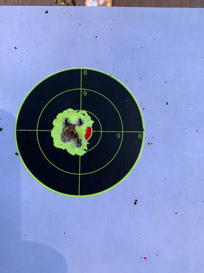

The first target Is the Karma SLS the second Is my $200 Gamo hunter pro .22 ( you get what I'm saying right ? ) both out to 55 yards .

How was Semi with those pellets?

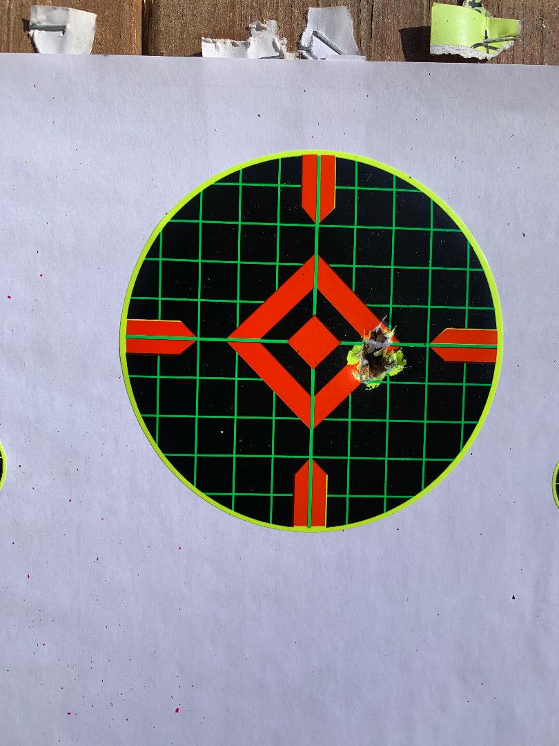

I was really happy with that group with the JSB 15g I didn't want to jinx It by trying them In auto mode , but I will maybe today .

The test target looks good and velocities were +-5fps for 5 shots. I got a scope mounted this evening and will be able to shoot it tomorrow.
