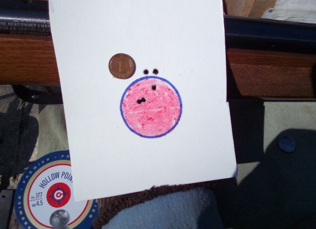

Try some white thin cardboard box . Some poke nice clean holes .

Only picture i got with " keyhole" looking holes . Its just plain copy paper and you van see how it tares to give you jat keyhole look as said above ..
You may can yry a backing of normal brown box cardboard to help ? That white food stuffs cardboard i like and yend to have plenty to use like ice cream sandwich box or dog flea drop box ( used in pic above in my first post) ect...
