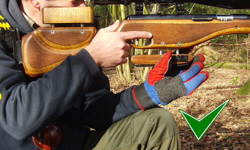

Points #4, #5, #6 in the image at the link below... Support the forward elbow on the meaty part of the triceps, not on the point of the elbow. Tuck the unsupported elbow close into your side so that it picks up lateral stability from your body.
https://www.everydaymarksman.co/marksmanship/kneeling-position/
I hope that's helpful. I'm not that good a marksman anymore.
