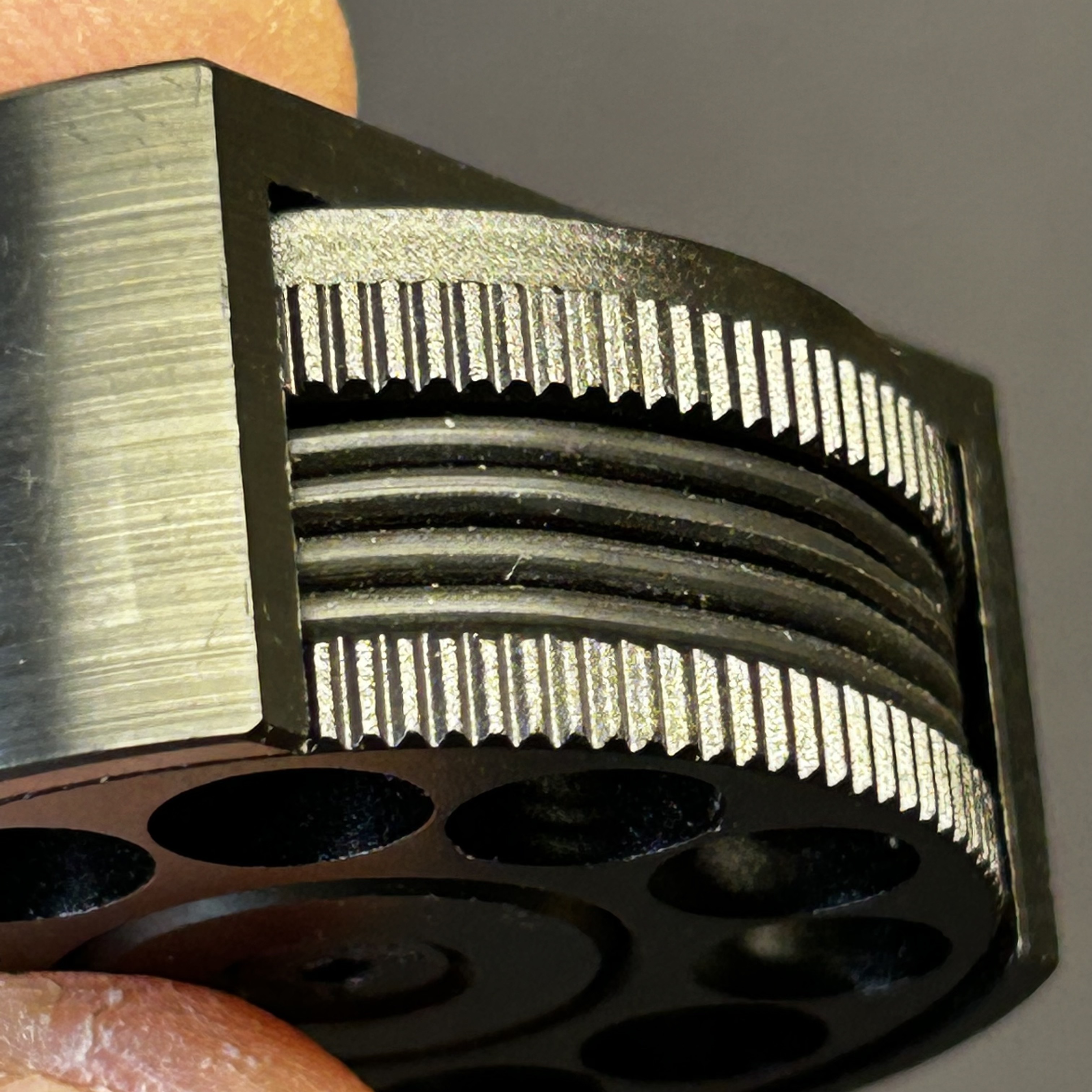

I was shooting .25cal JSB KnockOut slugs from an RTI Prophet 3. The MKII with the flared skirts.
But many slugs fell out of my OEM magazine when I simply tilted the gun at a 45⁰ angle upwards....
▪ Do the KO's just not like the RTI OEM mags?
▪ Are aftermarket mags the solution to using KO's (because I liked their precision at 100m)?
▪ What .25cal slugs DO work in the RTI OEM mag.?

Probably need a slug specific mag with 2 spaced orings vs orings right next to each other. Carms are sealed on the back so that may be what you need. I smack the stock mag against my hand after filling it to seat the ammo just a little bit deeper. Can't smack it too hard and push them all to the front where there drag and cause feeding issues though.
There is some Orion mags in the classifieds that also semi trap the ammo from the back that would keep them from backing out. $25 for 2 is not bad.

Do the new OEM mags have o-rings? Maybe the o-rings are old and not flexible enough to conform to the slug shape?
