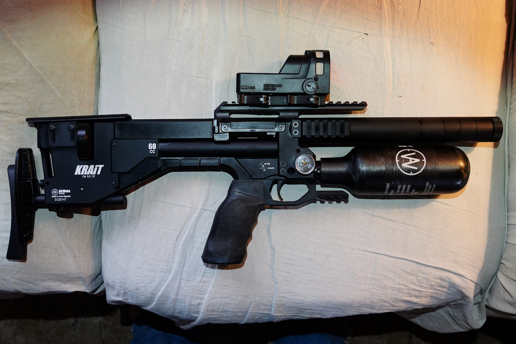

My short Krait is alive and doing well.
AirMaks did come up with a different regulator. That at least in my case...works very well. Shot to shot has very equal pressure. Letting the gun sit overnight, or a month, very minimal pressure difference. After sitting a month (on purpose), the first shot was a little low on pressure. But the following shots were well within acceptable variations, as noted on a digital pressure gauge on the regulator side.

Looks awesome!
