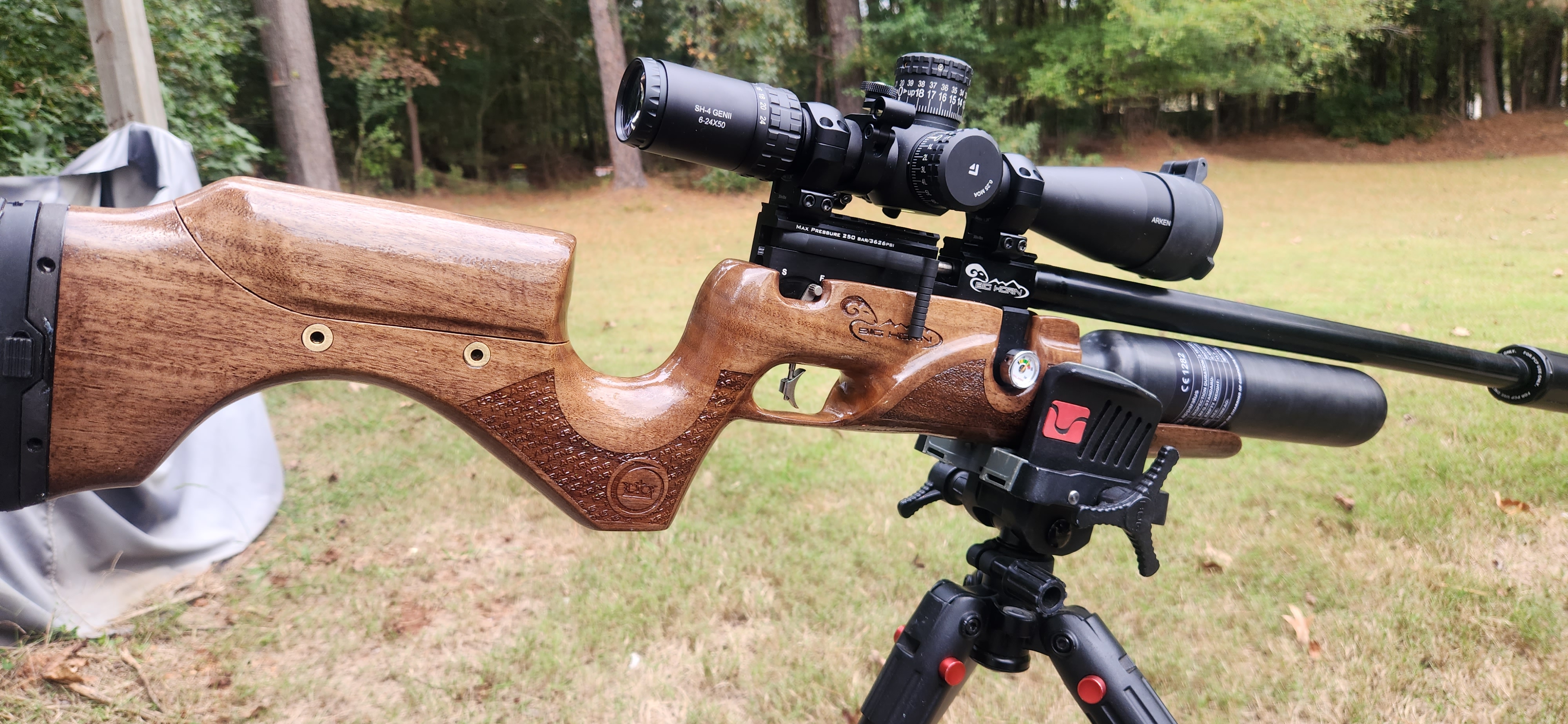

Hey guys, I've got a picture of my Kral Bighorn. It turned out a little light in color. But it's OK I guess. Now I have to get it to shoot straight. I'm shooting FX 44 gr pellets. They are more consistent than those cheap Hatsans. I've cleaned the barrel and have shot about 500 rnds through it. I'm gonna order another barrel soon. Anybody have suggestions on accurizing it? Thanks Ya'll.

I have the Kral Bighorn .30. I shoot both JSB's and Slugs. The barrel handles both very good and the accuracy is amazing. Depending what type of power you're looking for ...African Air Ordinance sells the best kit for these guns ...but not cheap.
I ordered a .35 cal bighorn barrel some time ago and fitted it to my JSAR Raptor.. accuracy was very poor until I removed the choke and recrowned the barrel.
I cut about and inch off the end to rid it of its choke but it worked wonders!
After it shot JSBs really well and NSA 79 grain slugs almost as good.
