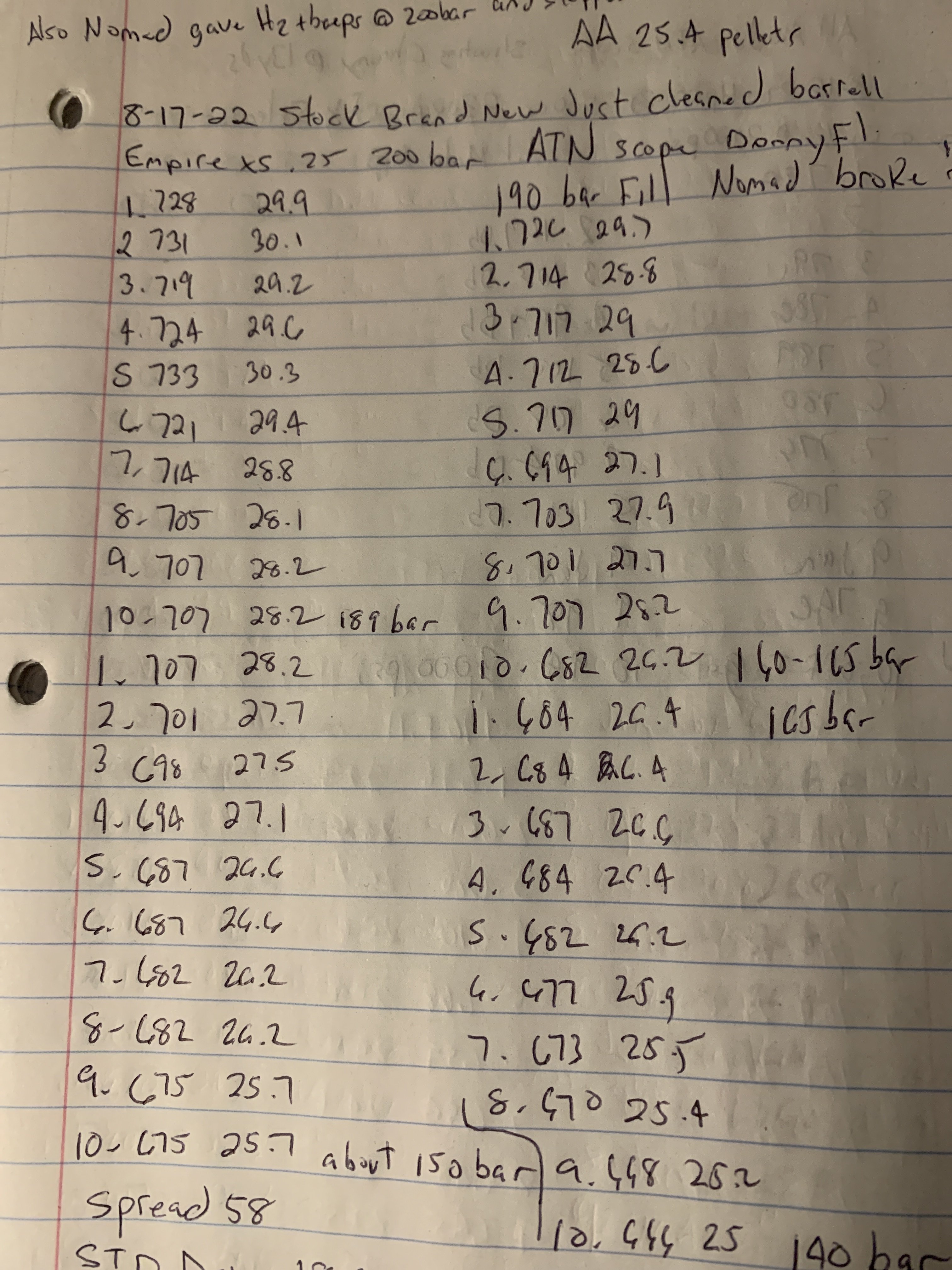

I replaced the factory power adjuster o-rings with 2.5 (ID) x 1.5mm (CS) 70 D ones because the power adjuster was difficult to turn. With that and a replacement hammer spring, the NP03 is shooting 16 grain JSBs consistently at 820-830 fps without a steep drop off.

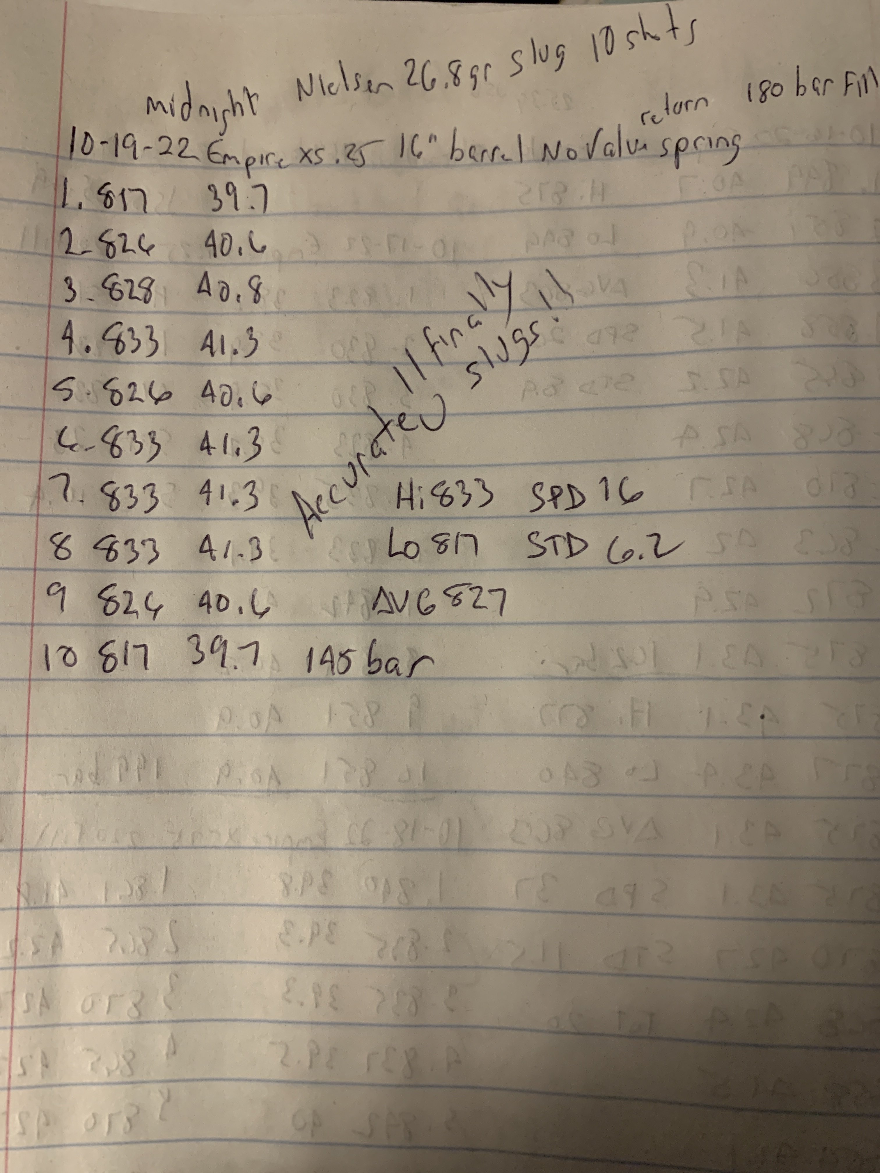

I am starting to get my NP03 figured. Still working on finding the ideal fill pressure but it is now shooting groups barely bigger than a .22 JSB at 25 yards. The best one measured 0.09" ctc. Not bad for a budget gun.

Absolutely love my xs.25 I ported all ports (transfer, barrel, and action) to a little under 5mm or so stock spring maxed np03 16” barrel made a new shroud still work in progress, but happy so far.
