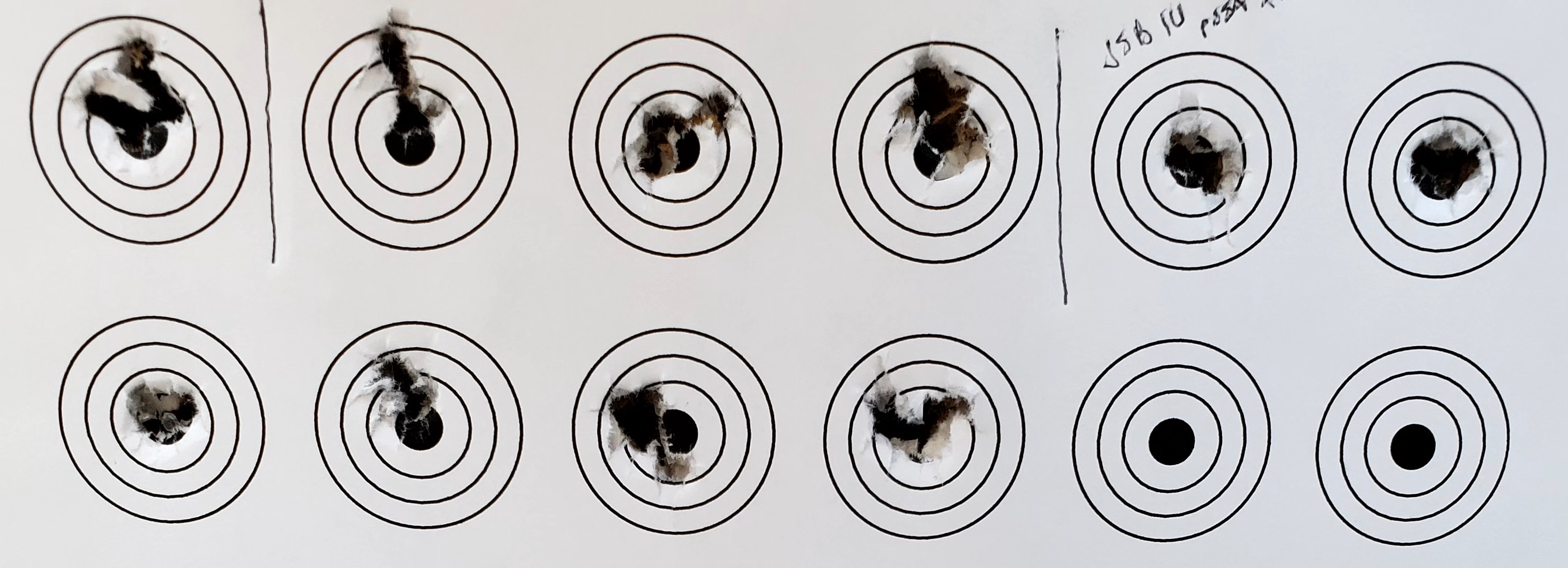

After a few weeks of tweaking, I now am getting 30 shots in the 810 fps range with JSB 15.89 with 20 fps spread. I cut the long factory hammer spring a bit but with stock porting it maxed out at 730 fps.
Accuracy was intermittently very good and the barrel needed frequent cleaning so I shot some slugs coated with JB bore paste.
My NP03 is now much more consistent. The below 5 shot groups at 25 yards demonstrate the progression of accuracy after fire lapping. The first four groups are shot through a dirty barrel before fire lapping. The second six groups are after. The last few groups opened up a bit due to wind picking up but are still fairly tight.
Definitely improved.
Fire lapping ? I just learned something I didn’t know. !

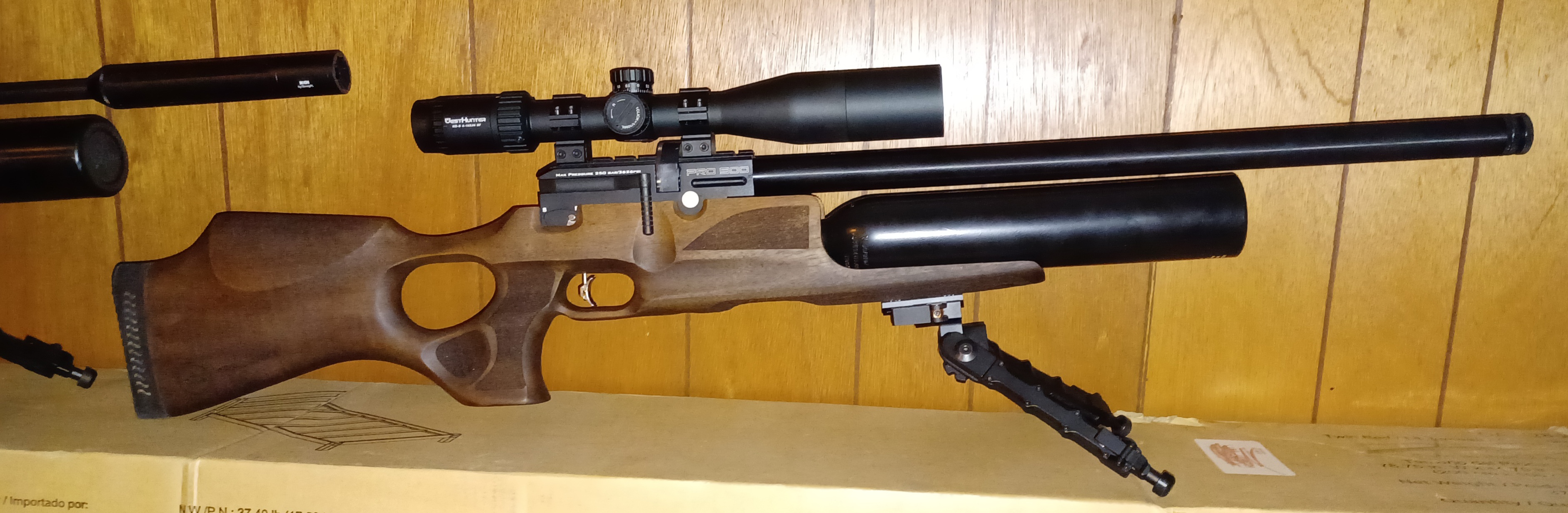

What optic are you running?
My NP03 is using a 20 year old Bushnell Elite 5-15x40 I took off an old FX. Haha.
I read about fire lapping on this board. Figured this barrel needed some kind of refinement when I realized it got dirty so quickly.
