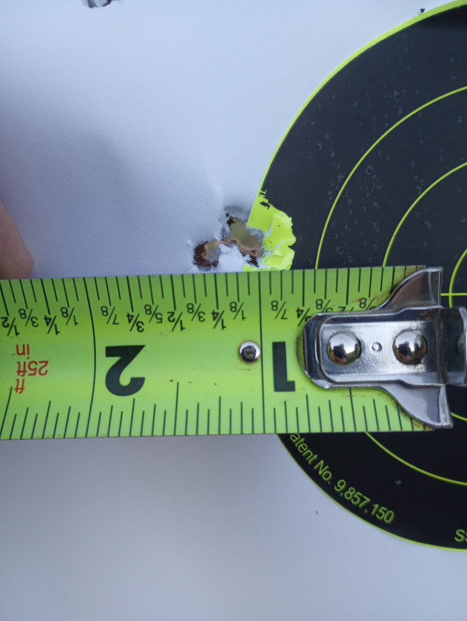

I've started doing some testing of my Bighorn .25. First up was to see what effect with and without the shroud and suppressor had on accuracy. The most accurate configuration was no suppressor and with the shroud on. Here's my best 5 round group at 50 yds with King Heavies Mk 1, no wind from a bench. Maybe you can tell where all 5 shots went, I can't. ;)
Impressive group!

82+ fpe. It’s tempting.! 👿 Especially with less than .4 inch at 50y groups

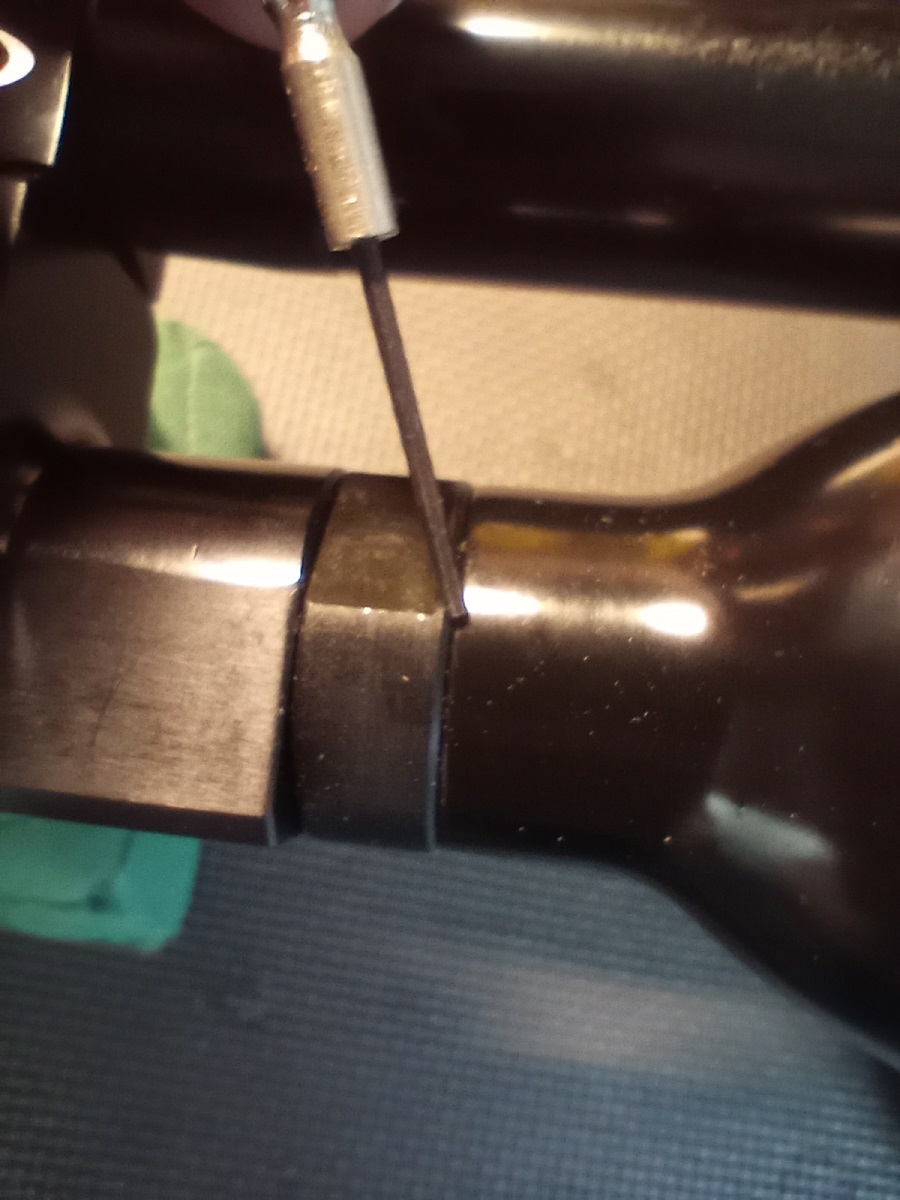

I want to replace the aluminum bottle on my Bighorn with a carbon fiber one. But I'm having a devil of a time getting the old bottle off. I'm pretty sure the bottle ends where I'm pointing in the photo and that part to the right should twist off, correct? The bottle is depressurized and I tried holding the part to the left with an adjustable wrench. It's not budging. Advice?
