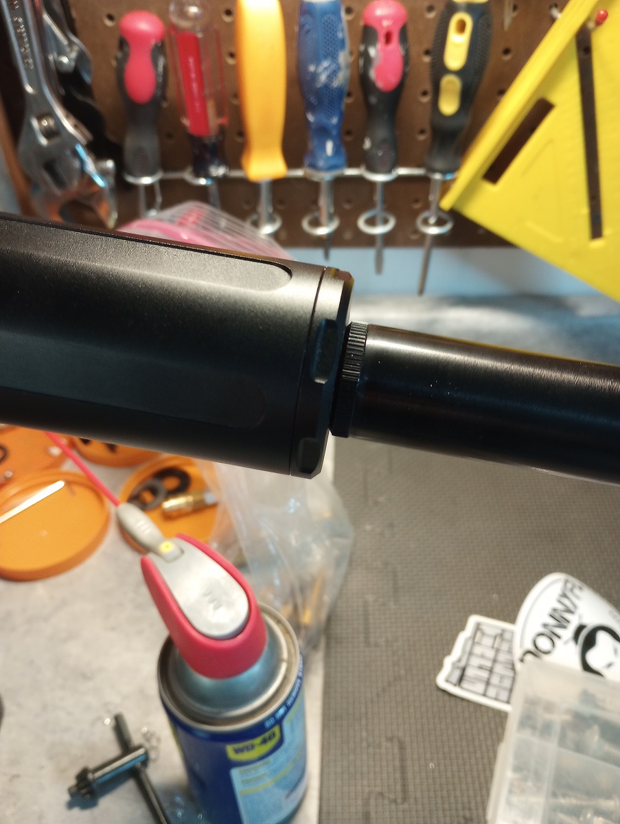

I don't know if this is true for the other Kral's, but I needed a bigger caliber moderator than I do with other rifles. I tested with no moderator, a .22/.25 Sumo and a .25/.30 Ronin. With no moderator I will get sub MOA at 50 yds. With the smaller caliber Sumo it becomes a scatter gun. But with the .25/.30 Ronin, it's back to sub MOA but with a POI that is 4-5" lower.
Hey Stretch I think it’s a moderator issue more than a Kral issue. I’ve got 6 Kral barrels and have had a few more. If I use a Donny I go up in caliber per their recommendation, If I don’t I have poi shifts.

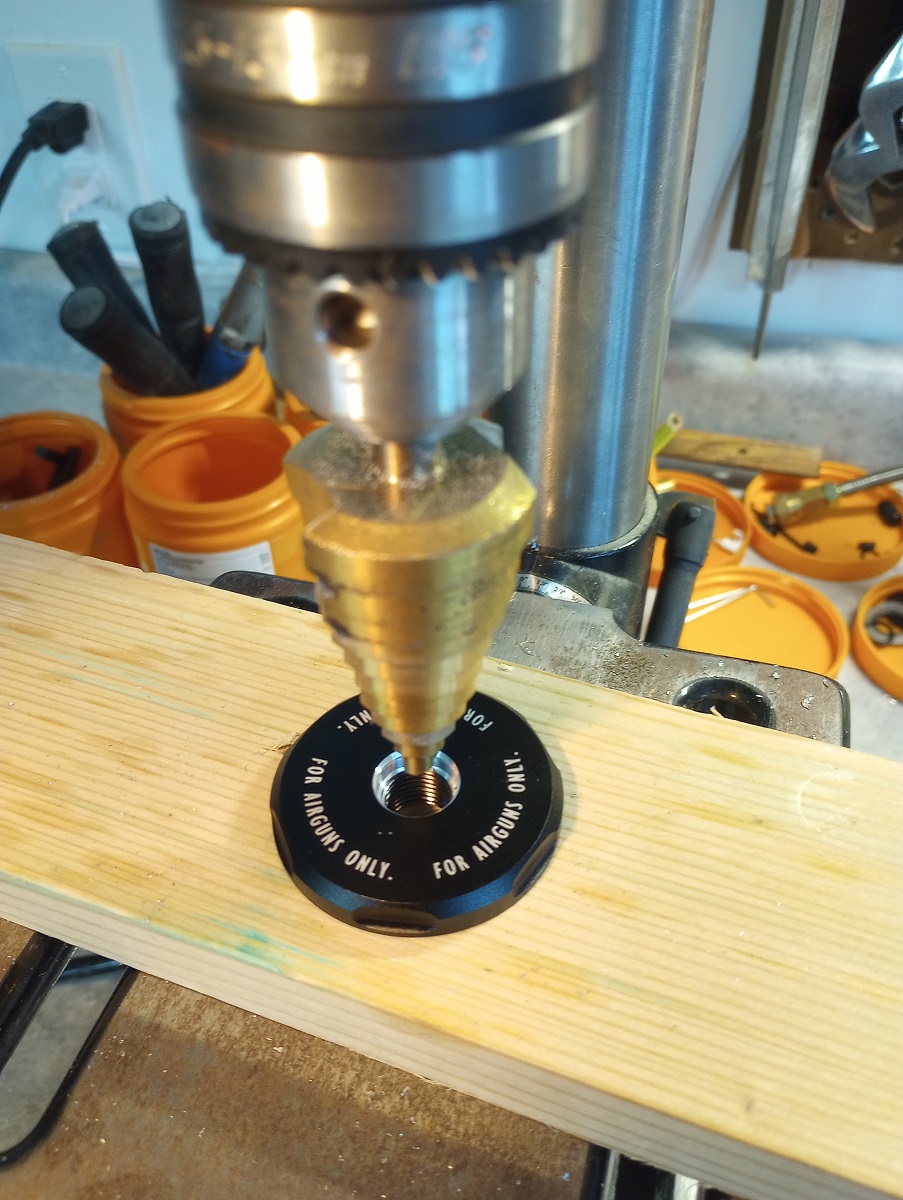

I fixed the fitment issue with the Ronin. Some careful measuring and use of a step-drill and it now fits perfectly.

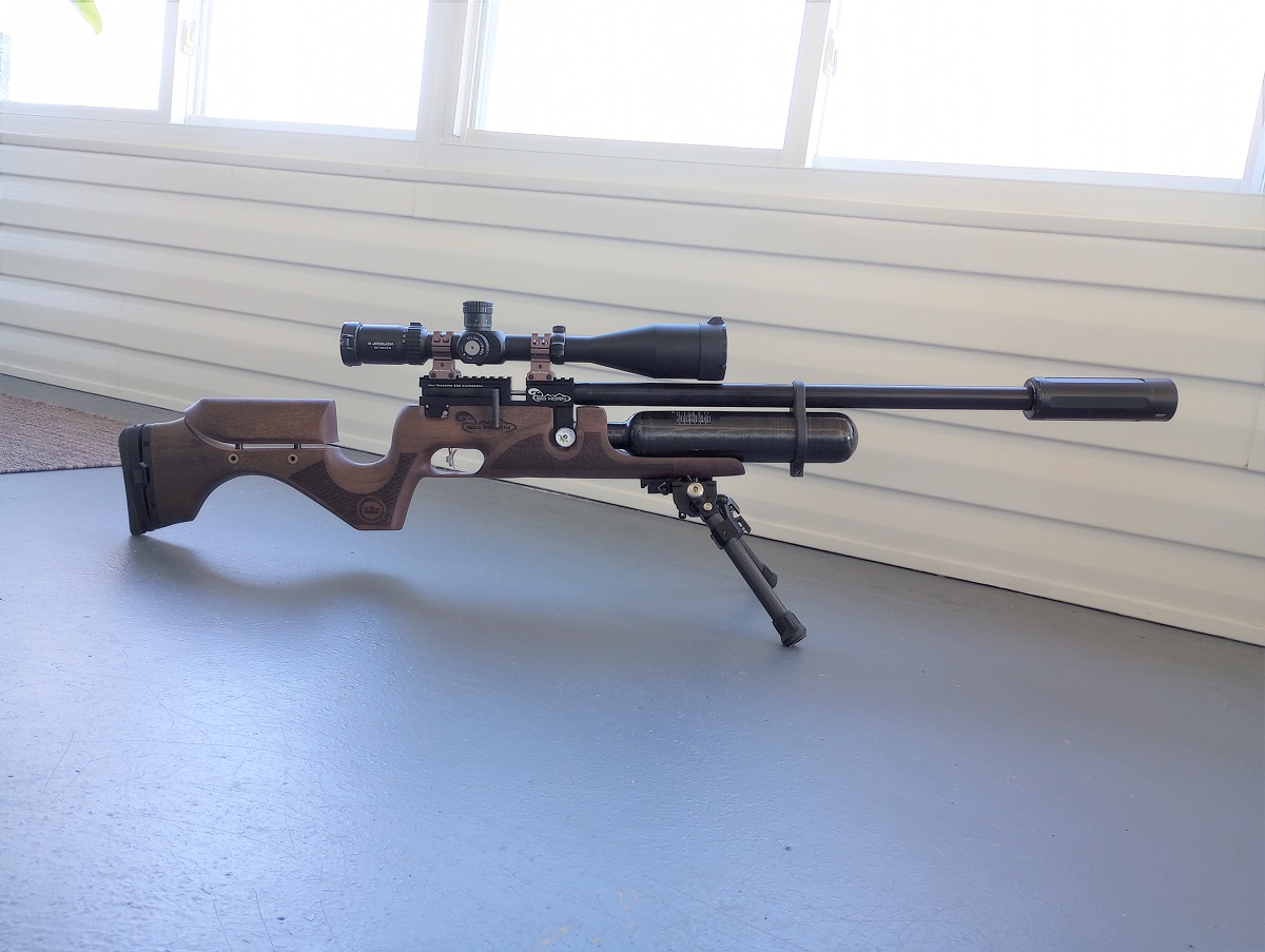

I swapped the aluminum bottle for a carbon fiber one I had and installed a barrel band I had made. The CF bottle really lightened up the rifle. The barrel band didn't fit exactly right, so I had to modify it with a dremmel. Too soon to say if accuracy improved, but POI went up about 6" (about the same amount that the suppressor moved it down) so that's an improvement. Accuracy definitely isn't worse, but I won't know what effect it has on fliers until we get a windless day to test.
To answer some earlier questions: Yes, the stock bottle uses a standard thread (M18x1.5). No there isn't any "anti-tamper" device. And yes, they really torque the heck out of the bottle, it was a real bugger to get off.
That looks tits !
That scope height is very low to me. Is that better for long distance??
My breaker has a very high scope mount otherwise it will kill your neck lining upto it
The general rule for scope mounting is to have it as close to the bore as possible. Not so much for long range but closer range is where it might make a difference.
