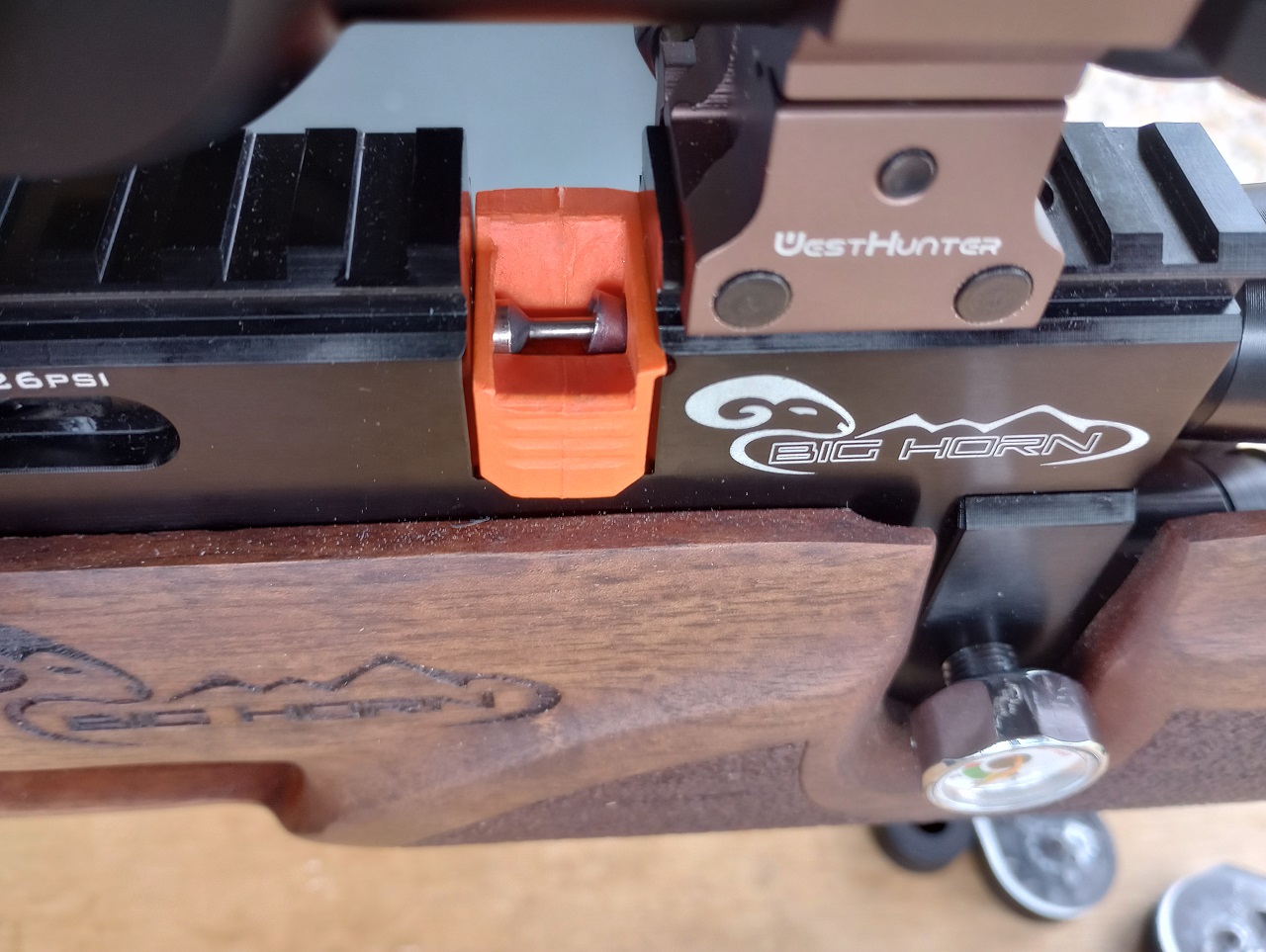

Thanks Roachcreek, you gave me some ideas to look out for. The breech end of the barrel sits flush with the receiver and looking at the magazine design, it looks like that's how it's supposed to be. I tried loading pellets using a single shot tray Troy gave me and the same thing happened. What I'm seeing is that as the probe pushes the pellet into the breech, the pellet tips tail up and won't enter the bore.

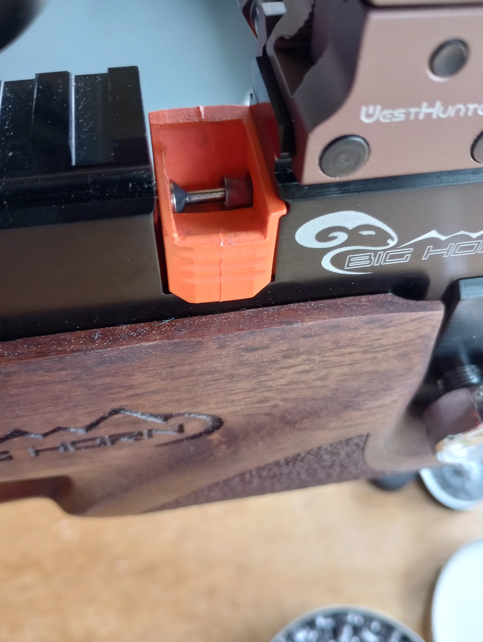

I managed to take some photos of my pellet loading issue. I'm using a single shot tray so you can see what's happening but it happens with both a single load tray and using a magazine.
Here's a photo of a pellet loading correctly:
And here's a photo of the issue. As the head of the pellet enters the breach, the tail of the pellet tilts up and then jams. I thought it might be caused by friction in the loading ramp so I carefully polished it. That, unfortunately, didn't fix the problem.
Ideas? Suggestions?

I had a similar problem with one of my Priest barrels, in my case I was able to increase and polish the chamfer at the pellet entrance. In my case, there was zero bevel where the pellet entered, and judging by the condition of the magazines that came with the gun (used), the previous owner was never able to shoot with this barrel.
I think that's what I'm going to have to do as well. I'll have to be careful, though, because there isn't a lot of room between the end of the barrel and the breach o-ring.
