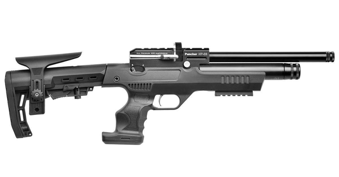

Wait. That’s a .25 cal you’re talking right. ?Canadashootingsupply.ca has the shorter np01 and np02 barrels in stock if anyone is interested.
Np01 barrels are 10.75"
Np02 barrels are 12.6"
They will still make decent power with the other mods, and you can tuck the barrel in the np03 shroud and add an air stripper and Mrod baffles. Adds no length to the gun, but will lower power a bit.
I did use a 12.6" barrel on my first go at my kral jumbo, and still made 840 fps with JSB 25.39. Just had porting and a heavy spring.

Yes I was using a 25 cal. They have them in 177, 22, and 25 both barrel length.Wait. That’s a .25 cal you’re talking right. ?
