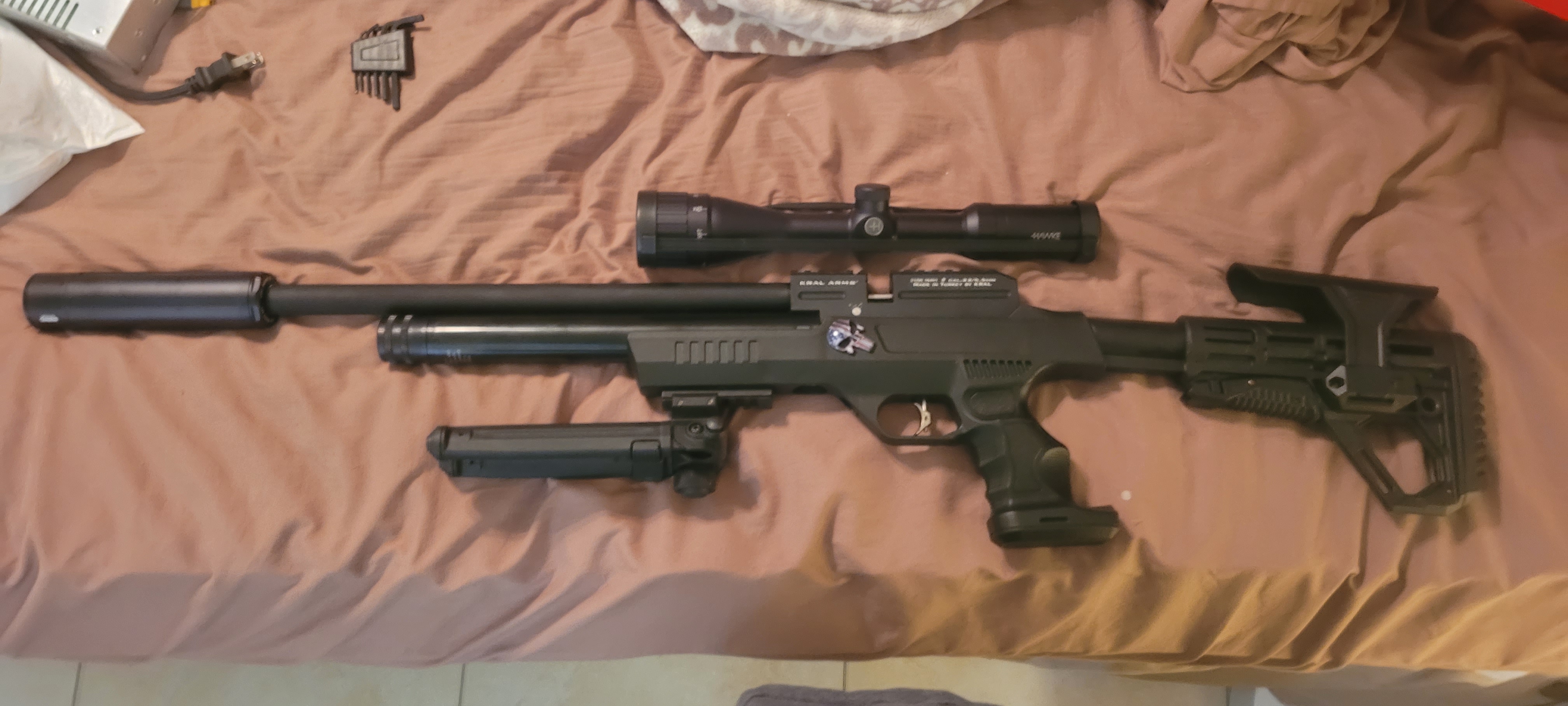

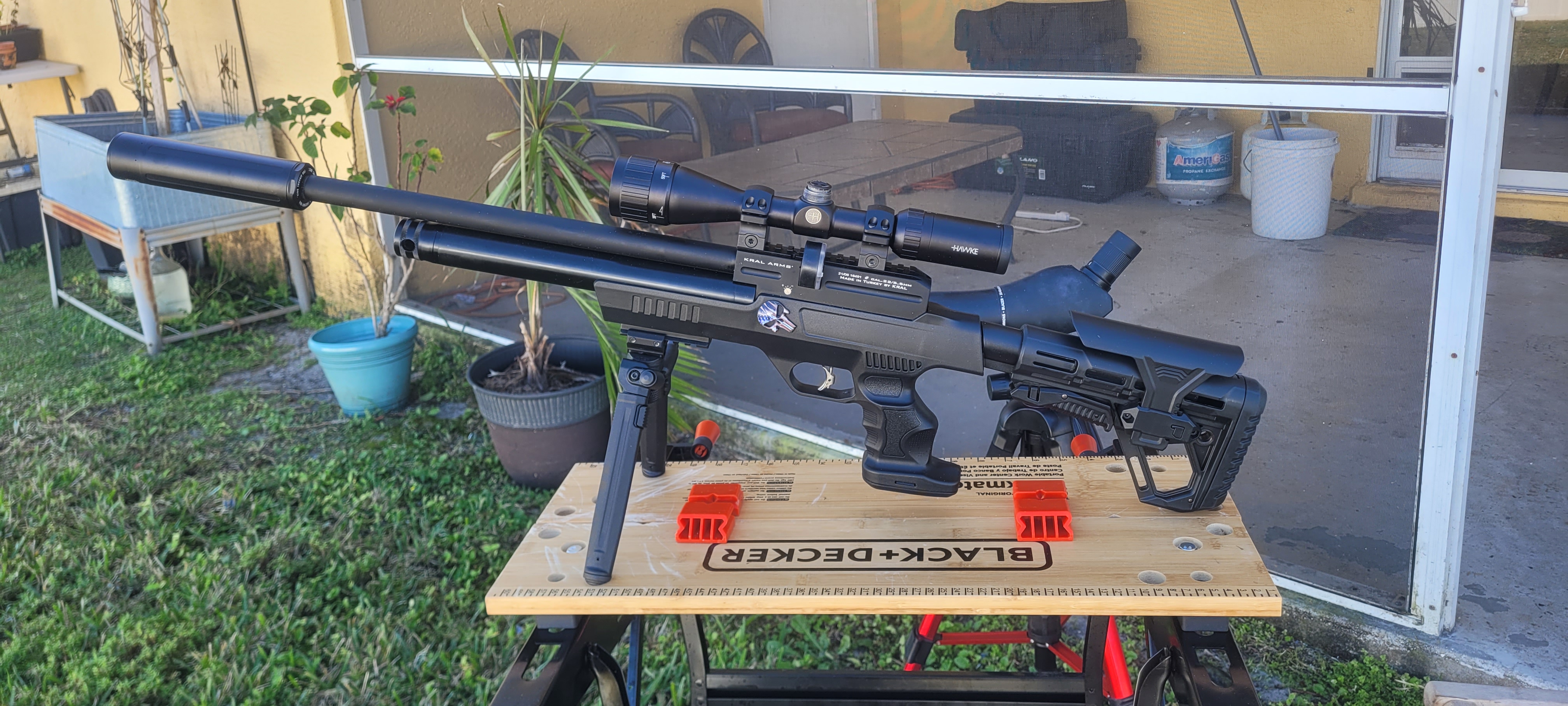

My 10.5 lb spring arrived with a bunch of other stuff not messing with the spring yet based on the above. No scope rings yet but I can see it's nice and balanced with that 3-9 × 40 . This is the sumo installed. Wouldn't want to go bigger and doesn't feel as nose heavy as I thought it would
The bipod is magpul
