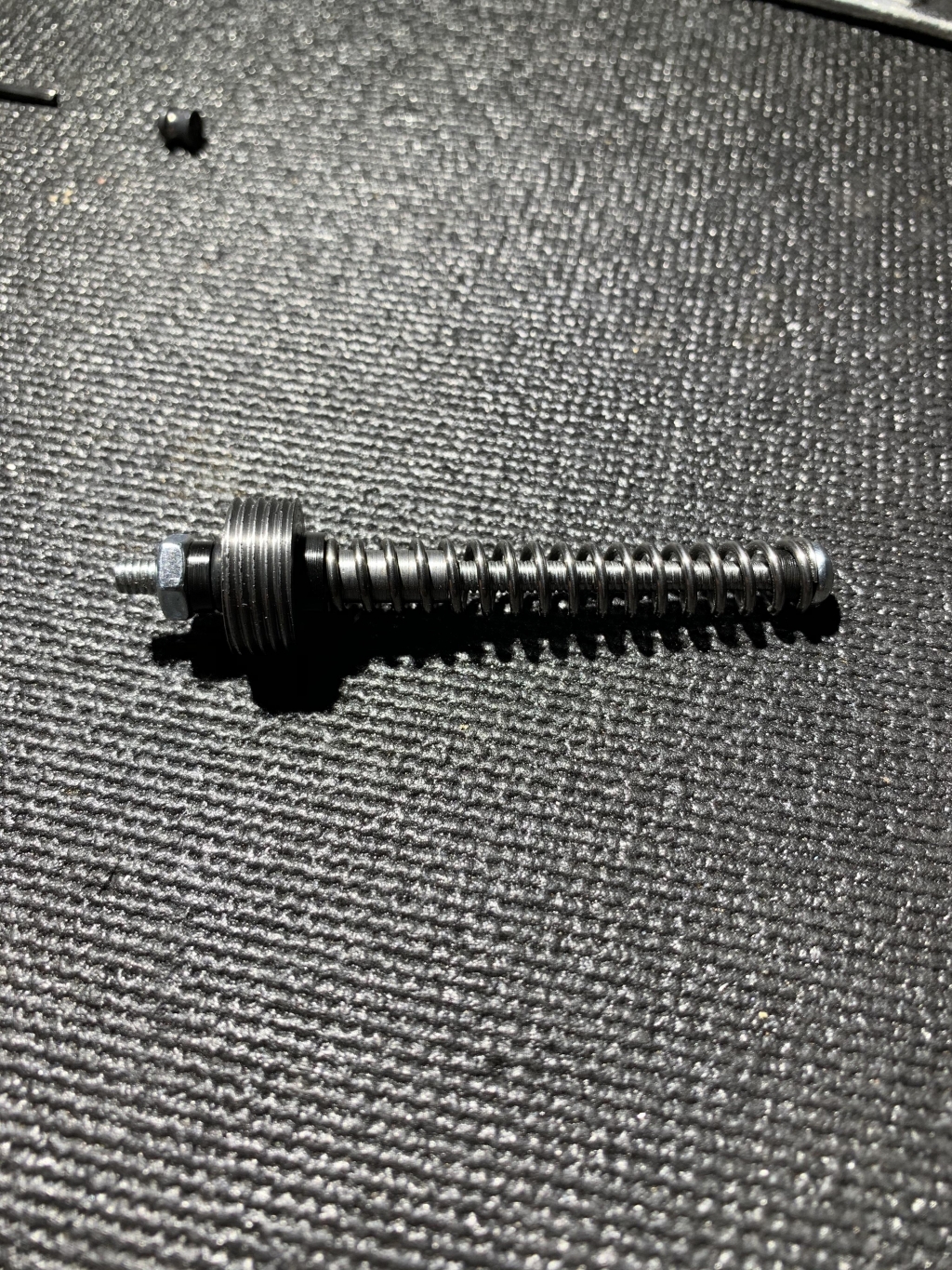

Here is the SSG. I think this is the stock spring out of my P15. The stocker wasn’t going to cut it.View attachment 100816

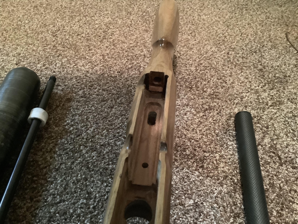

Here is how it looks in the gun.View attachment 100833
Hey I’ve been reading your posts about the jumbo ! I have bouncing hammer too .. it’s at 50 grams now it used to be 63 grams. Tried a short stiff single spring it helped but now I’m digging into it my .25 jumbo again! “Tinkering” so I’m gonna try a ssg just like what you made there. Can you tell me.. how far does the rod stick out when it’s cocked ? Here’s mine I made up

I sold the gun to my buddy a while back. I didn’t use the stock spring so I’m not sure how much shorter the one was that I used. What I do know is my SSG when cocked didn’t require a hole that was so deep that it poked out of the stock.
