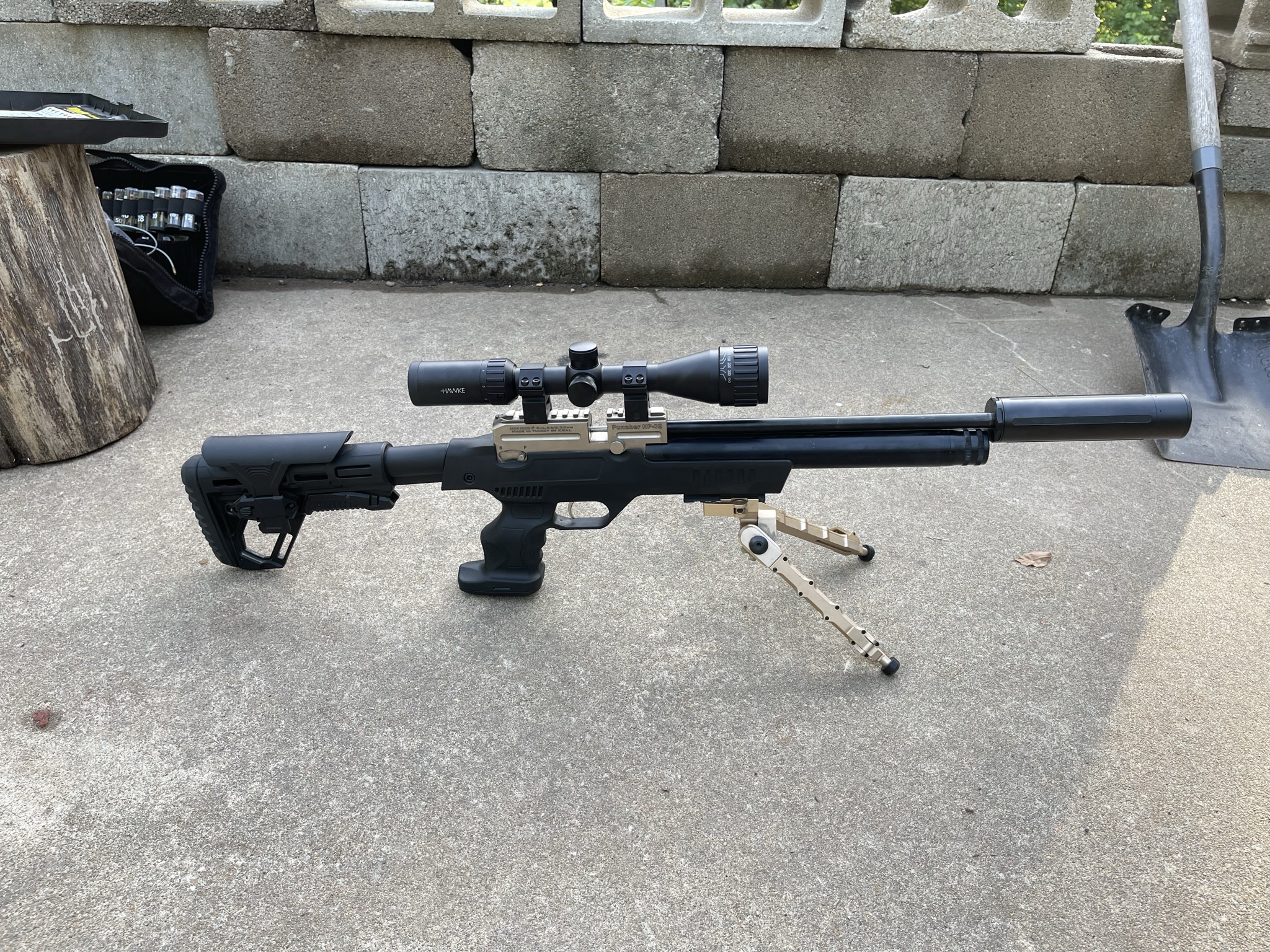

I don’t have a PP750, but I do have a PP700 and the build quality of the 700 does not match that of my Krals. No one who tries a NP03 has a bad thing to say about them. Mine is in 22cal and it goes to work with me on low power to shoot birds inside our shops then comes home and it’s my 10 year olds squirrel gun. He’s killed squirrels out to 60 yards with it. Excellent little gun.

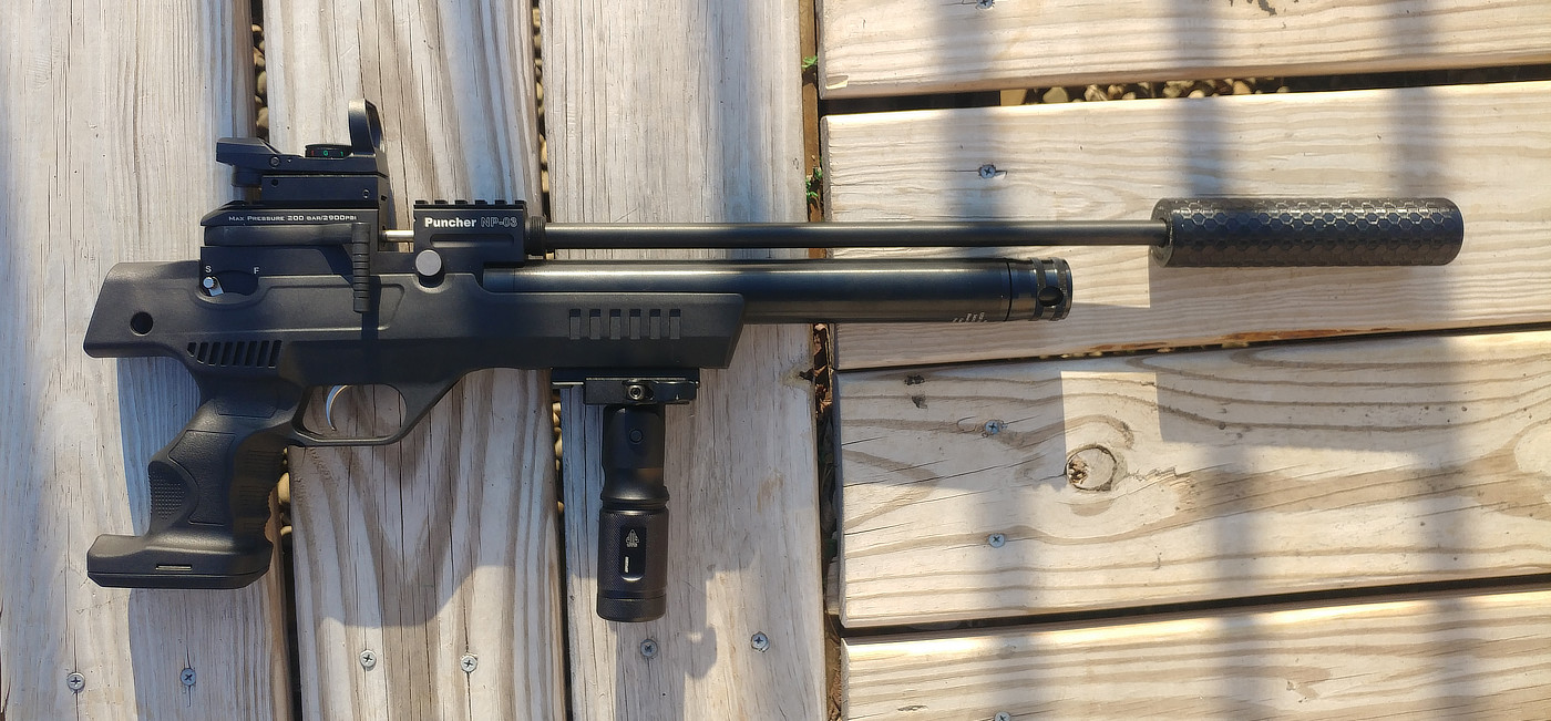

Never shot the Artemis but I have a Kral NP03 in .25 and it kicks butt. Built very well and very accurate with a variety of pellets. If you put a fore grip on the picatinny rail it's pretty easy to use in pistol form with the butt stock removed as well.

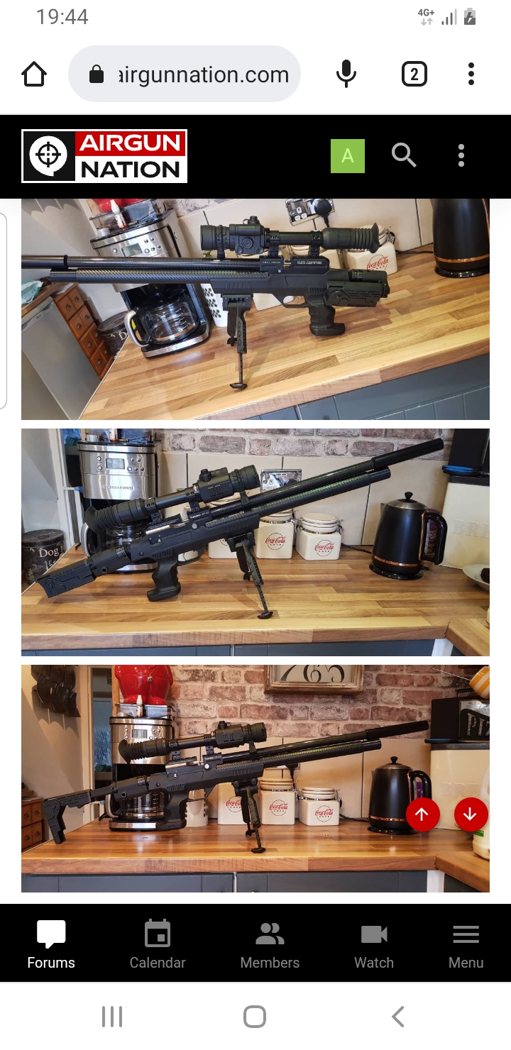

I put a lw barrel into mine for slug shooting and put 2 orings on the probe and a biathlon lever to aid cocking and folding stock .
