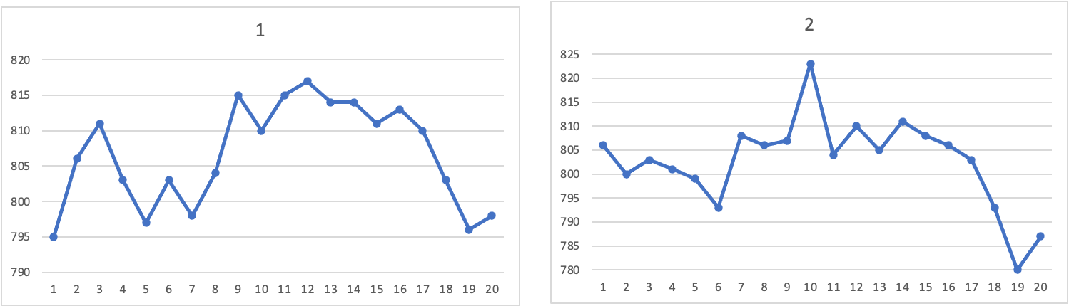

Awesome thank you so much. I have a Kral Puncher Breaker .22 cal roughly 4 years old since I bought it. I have been shooting JSB 15.39g and Crossman 14.3g, which were shooting okay until recently. I ran 20 pellets through a chronograph last week and found the STD is 7-9 fps per shot, the best group seems to be 11-16 with a STD of 2.44 fps from starting at 200 bar on the gun.
Shot #
1​
2​
1​
795​
806​
2​
806​
800​
3​
811​
803​
4​
803​
801​
5​
797​
799​
6​
803​
793​
7​
798​
808​
8​
804​
806​
9​
815​
807​
10​
810​
823​
11​
815​
804​
12​
817​
810​
13​
814​
805​
14​
814​
811​
15​
811​
808​
16​
813​
806​
17​
810​
803​
18​
803​
793​
19​
796​
780​
20​
798​
787​

Your gun looks very consistent fps wise being unregulated " so it's not that causing the problem.

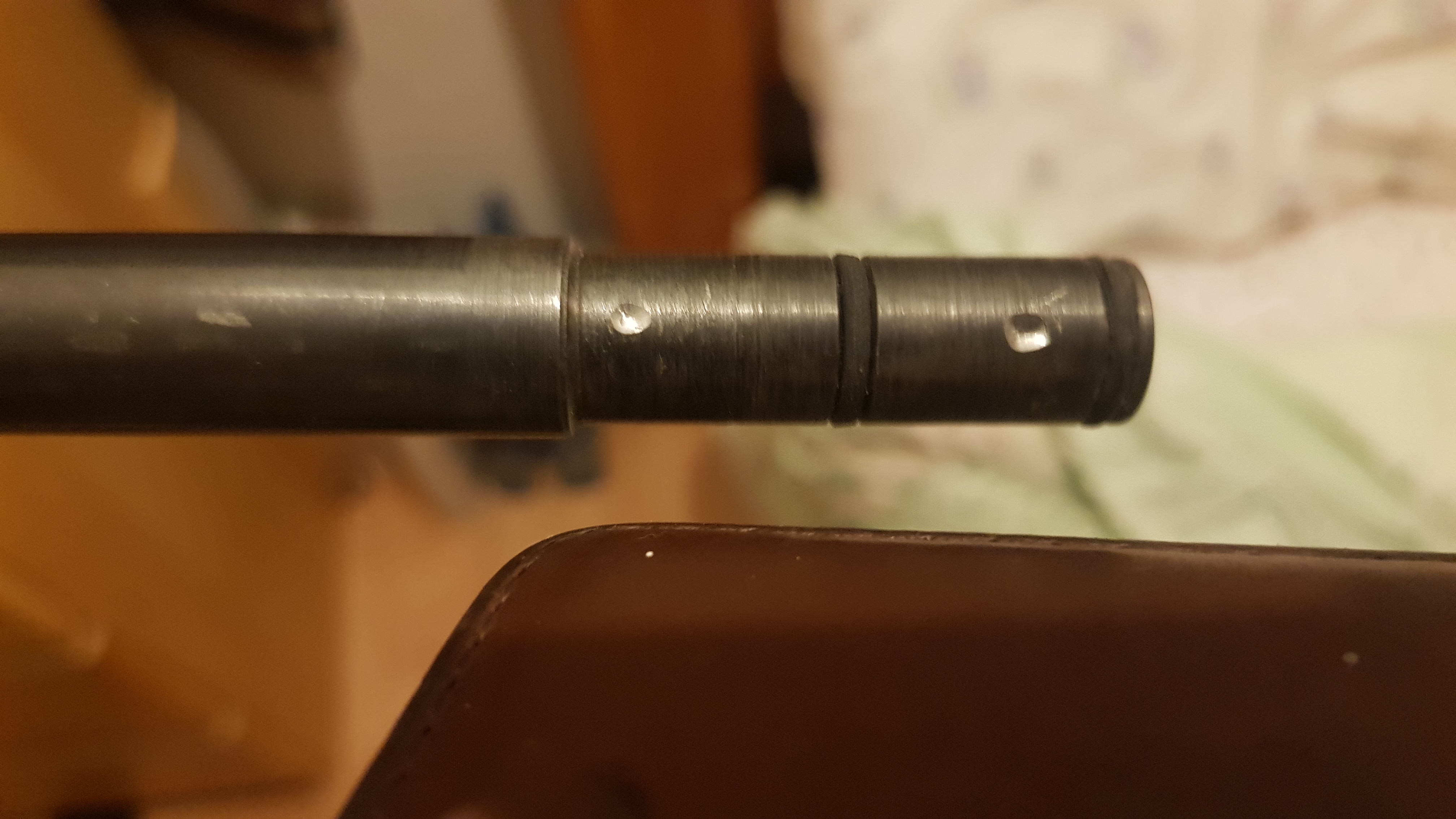

Do you know how to take the barrel off, I took the two grub screws out on the top of the gun and the barrel is stuck on. I have the entire tank off too, and used vise grips with duck tape and rubber to try and turn the barrel without scratching it but it's not budging. Is it safe to use penetrating oil? I put a couple of drops of Ballistol down the screw holes and between the barrel opening (where the o-rings are holding the barrel), but the darn thing is stuck on. I'm following a couple of YouTube videos and both show relative ease in taking it off.

I was finally able to get it off. I first heated the receiver block barrel section with an electric heat gun, then placed the receiver block upside down in a vise while pulling the barrel straight out while wacking the receiver block's air tank holder with a plastic mallet. It took 1h of excessive force (hammering/heating) to remove it, thankfully nothing got damaged. :) It's really weird why this darn this was on so tight, there's no glue I'll have to measure the tolerances. The O-rings are in good shape, except where the transfer port and screws were as it nicked off some rubber so I'll have to replace those.
