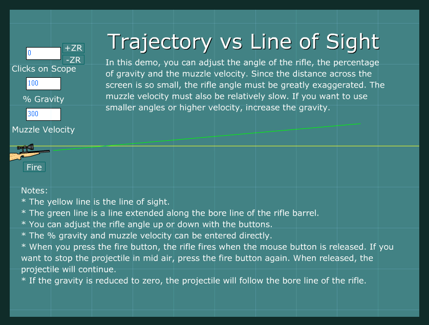

Trajectory Dynamics -Click on link for use-
