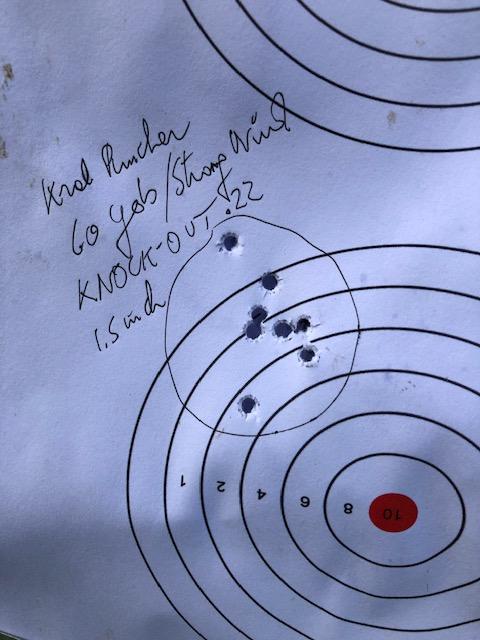

I have started shooting some JSB knock-out slugs out of my new .22 Kral Puncher Maxi, unregulated and not yet fully shot in. The Maxi is similar to the Mega but has a shorter (53cm instead of 58cm) barrel and a smaller cylinder (280 instead of 330cc). Opened up the ports to 4.5 mm but left the 2mm valve inlet port alone -- enlarging that might mess with the flat unregulated shot string ? Interested in THammer's take on that !
Fairly strong wind (around 20mph) and arguably a tad too slow at less than 700 fps. But I like the 40 shot count, therefore not too keen on messing with HST ...
This was my first group at 60 yds from the modest Puncher with the gorgeous walnut stock (400 Eur from Balistas, probably even cheaper Stateside). As I wrote somewhere else, those low cost KOs slid into the Kral breech snug and easy like suppositories 👄. Think about what a slightly higher speed and better shooting conditions could do ...
Got some .25 KOs as well from Balistas in CZ to try in my 58cm Jumbo but have not had time yet. Agree Troy's point about better accuracy for pellets as compared to slugs. The JSB Jumbo Heavies gave nearly hole-in-hole groups out of the Maxi under the same conditions as described above. The parrots are petrified ... 🐦

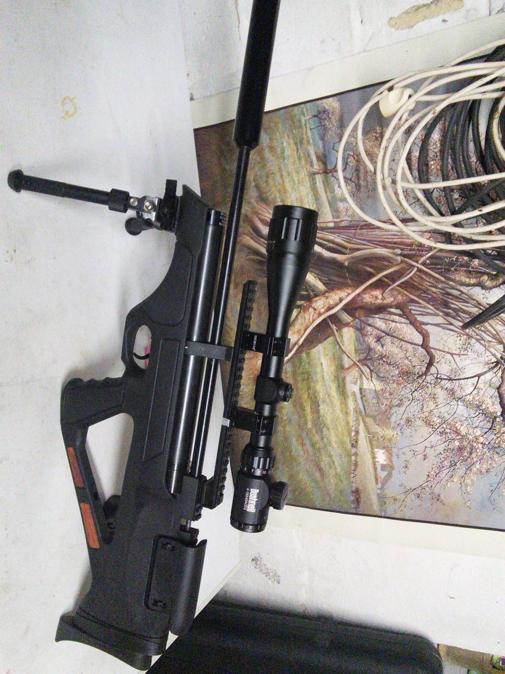

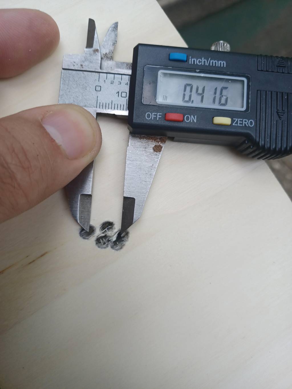

Alright. Again limited experience with slugs. I did a super Jumbo recently for a customer. Ported, hammer and spring mod plus my valve internals. 580mm barrel and got really nice results at limited range. Shooting .217 JSB knockouts at just over 900fps. 5 shots at 40 yards. The Big Max had never been anything but a Jumbo with two bottles in the past so not sure what would be different in the Big Max X to add that additional power stock. They had always used the same barrel but that might have changed. I thought the super Jumbo already had the 580mm barrel but those are two guns not currently imported so I rarely see them. Barrel specs should be the same so you should see no real accuracy difference with the same power and projectile.
Thanks for the quick reply!
This choice has honestly really been bugging me, because I liked my Avenger and decided to upgrade because it simply couldn't keep up with my expectations. I almost went wit a major build upgrade on it but decided against it.
So I don't want to waste my time and buy a gun that won't meet my standards again.
A 0.416 group at 40-50 yards is good, but I keep seeing these YouTube videos of sub moa groups with slugs at 100m with bigmax X's. The gun simply has a lot of power and a nice mid-range barrel.
But 900fps out of you build is tough competition relating to power. And in my experience that is what most slugs require.
