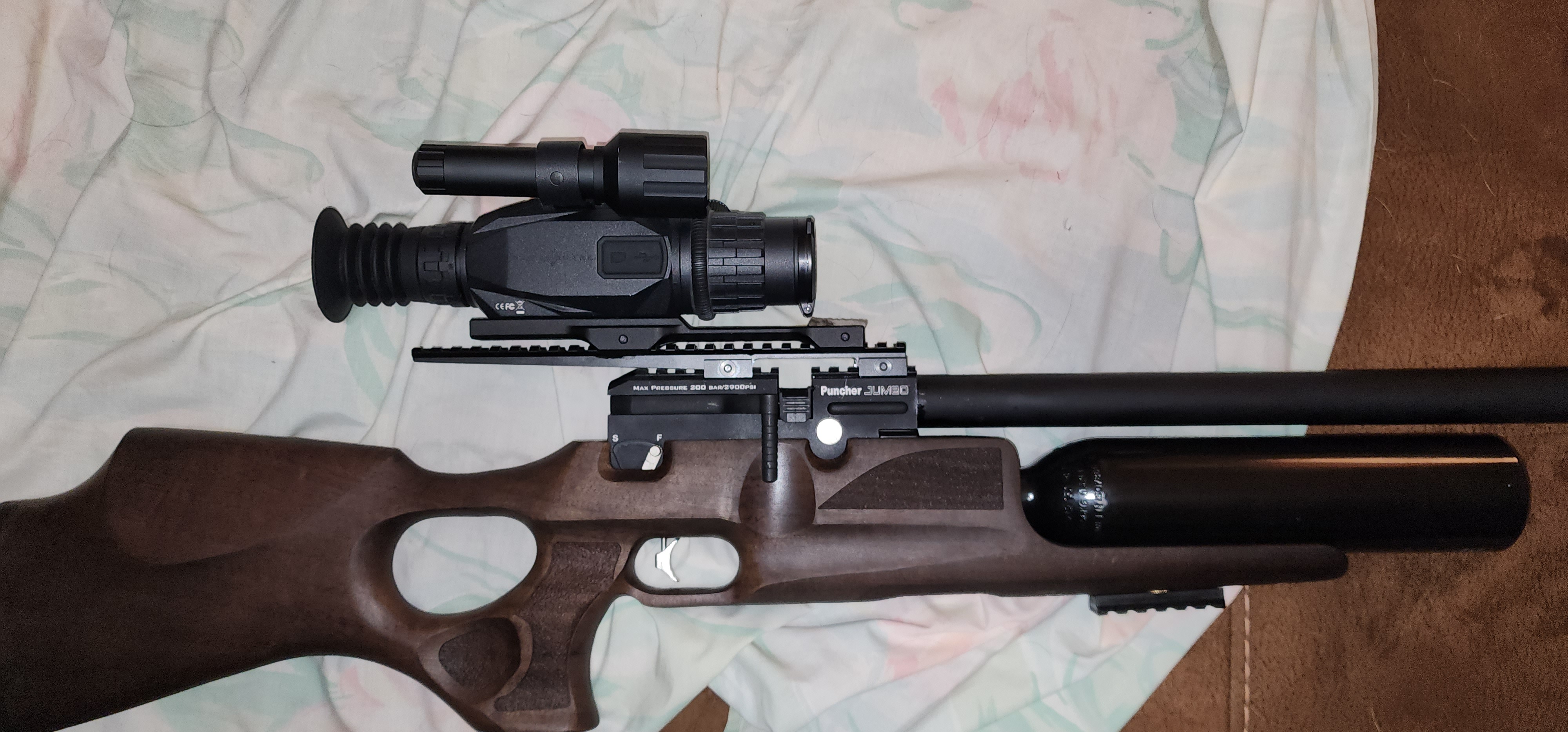

So I just received my first PCP gun the Kral Puncher Jumbo in .22 cal. I borrowed my friends Sightmark Wraith HD scope and the mounts I bought are too low to allow the mags to be loaded into the breech? My buddy’s scope has an elongated mount installed to get the proper eye relief I assume but it just doesn’t work on my gun. I got this picture online of a very similar gun and I am wondering where to find those two mounts they used?
Here is my gun. I used the single shot tray just to get a feel for the scope and gun and was shooting amazing groups at 45 yds. In minutes. But the single shot tray is just a party killer. This worked but is far from optimal or anything really useful. Any help would be highly appreciated. The rear section of rail mount on my guns receiver is 70mm long which seems to be the problem? I much prefer the setup on the Kuzey gun above.
The top picture you show has this mount. Buy that and a small riser.

Thank you Florida Man I didn't think to look on the Sightmark site for that mount. I still need to find a mount to raise the scope and mount high enough to clear the mags like what I posted pictures of? The Eagle Vision mounts are nice and pricey but they are all picatinny. I tried just mounting the borrowed Sightmark directly on to the receiver rail on my gun but it is too wide so the receiver is 11mm dovetail underneath the narrow pic rail above. Kind of hard to describe.

Something like this
Ulightfire 46mm Low Profile Rail Adaptor,20mm to 11mm https://a.co/d/81njABZ
HAIYANG 2pcs Scope Mount Rail Adjustable Adapter 20mm Picatinny to 11mm,Mini Rail convertor Aluminum Alloy Lightweight https://a.co/d/8AkVFuT
