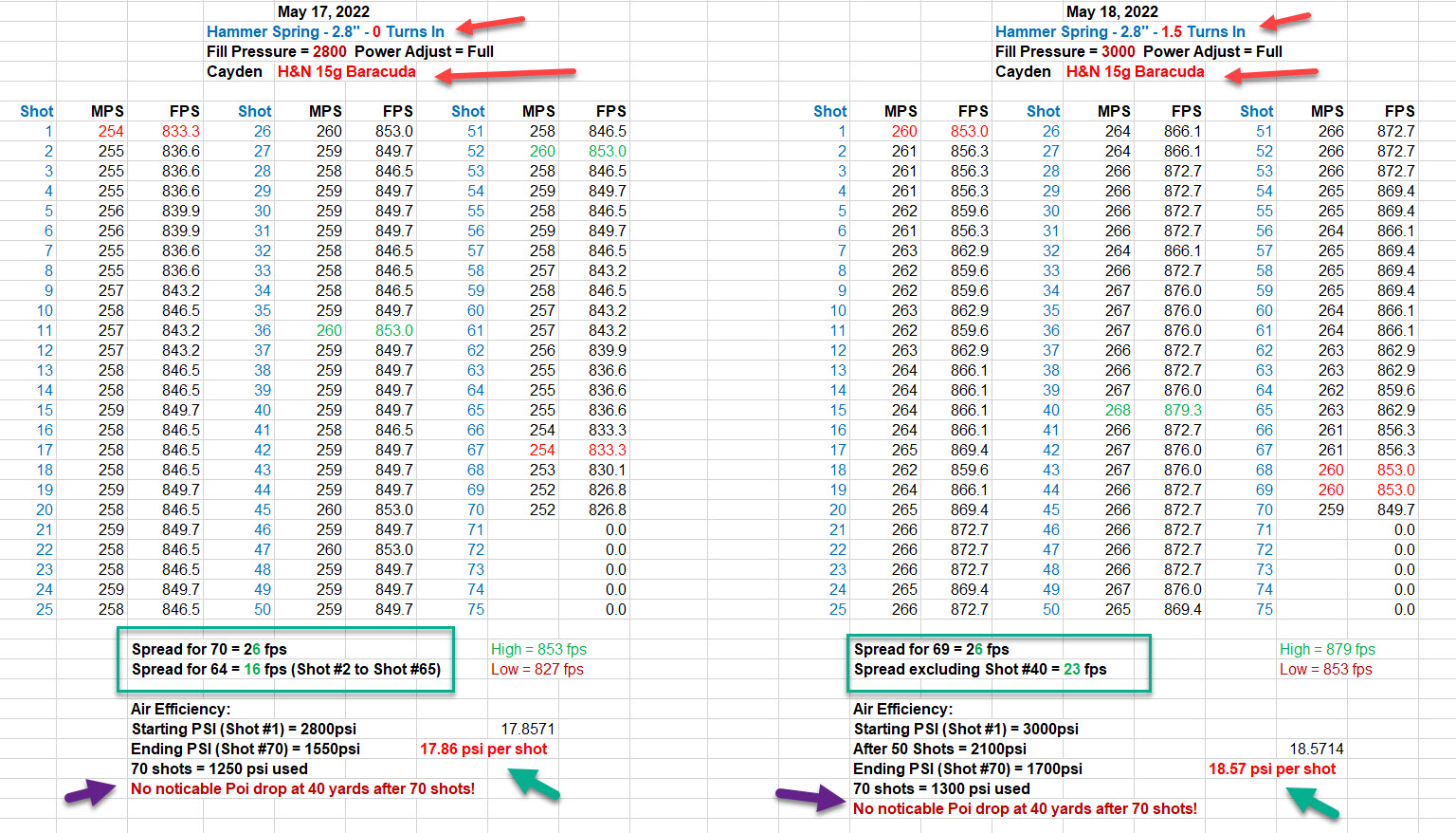

As your Kratos is a .22, you will need to cut your stock hammer spring from 3.5” down to 2.8”.
The rifle is massively oversprung from the factory - resulting in poor efficiency (air usage) and a steadily declining shot string.
Once you cut to exactly 2.8”, you will have shot strings like the ones I’m showing for my .22 Cayden - only better because the Kratos has a much larger air tank.
You should be able to get 100+ shots with a spread of 25fps or less - once you cut the spring. Probably fill to 2,700psi and shoot down to 1,600psi.
I have a friend who is testing his .22 Kratos with 2.8” spring this weekend - I’ll ask him to run a shot string.
The only real difference between Cayden and Kratos is the Cayden has a slightly longer barrel and the Kratos has the bigger air tank.
-Ed
-Ed
