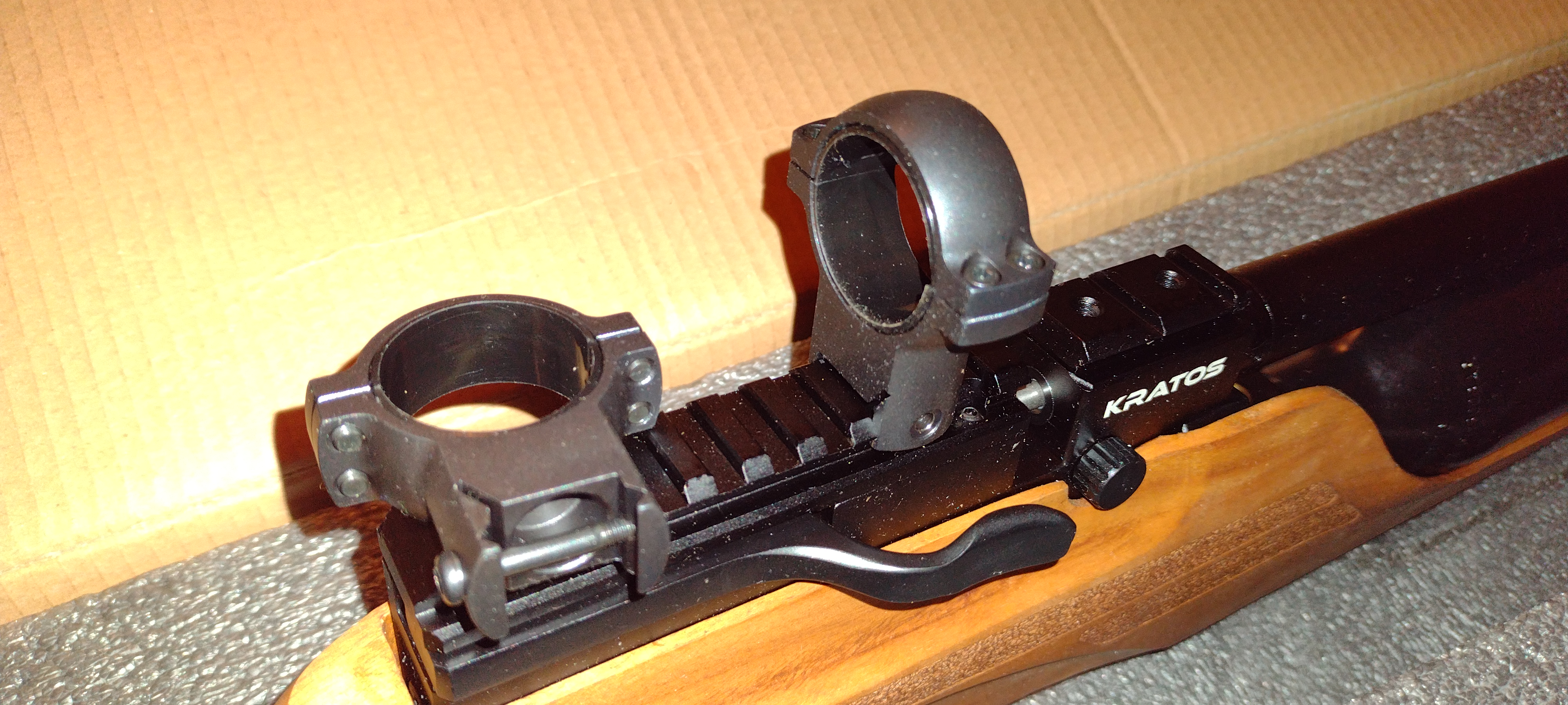

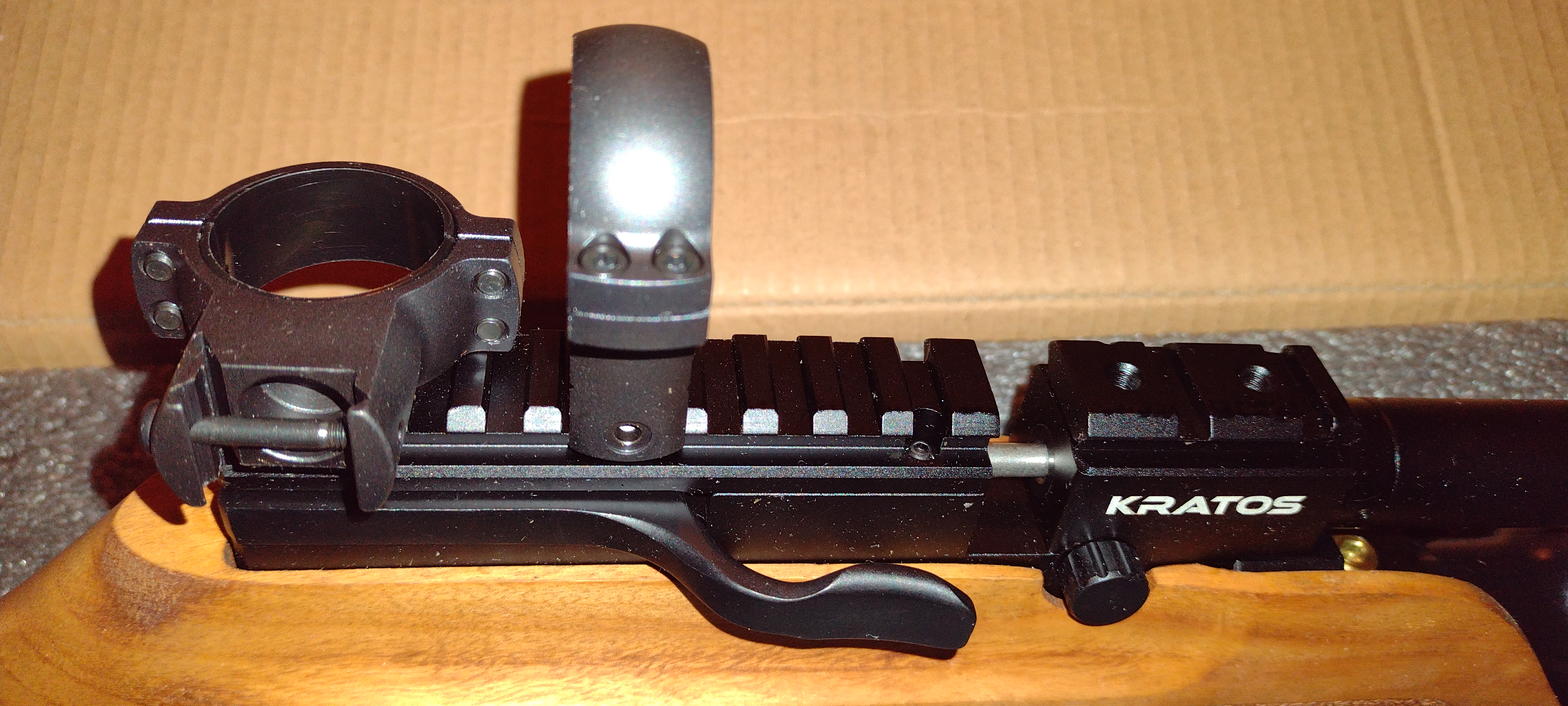

Hi,
I have a Benjamin Kratos that is new.
The problem is the rings will easily slide over the rear rail section but not the front section of rail north of the magazine.
I've tried buris signature and weaver rings and one other brand.
The dimensions of the rail in front are .010" wider than the rear.
Has anyone else had this problem?
Thanks.

you used the word "slide" to describe trying to fit the rings to the rail.
which says to me that maybe youre incorrectly trying to slide on picatinny rings like you would slide on a dovetail ring.
make sure you have the base screws loosened enough for the clamp to fit over the rail.
a picture would greatly help us diagnose the problem.
Ok here you can see the ring installed on the rail by removing the screw and sliding it on the dovetail. The front is a no go because of dimensional differences. You can see the geometry of the rings. Super high quality - used on long range precision rifles commonly.
I didn't put the screw back in - but it fits fine and does not interfere with the rail slots.
Thx for looking!

I have the rounded pegs on the utg rings sorry, these seem to be weaver/picatinny.
