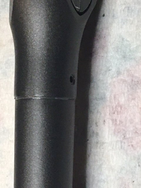

The grey color of the JB weld matches the color of the pistol pretty well, so I was less concerned about the glue squeezing out at the barrel/slide junction ... it could be smoothed to form a blend between the two parts.

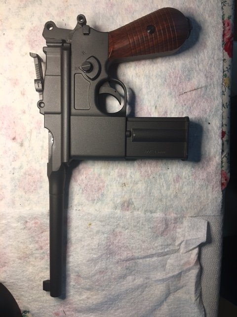

Here's the M712 barrel shroud. Glued in place with a liberal application of grey JB Weld.
The color isn't a perfect match but it does a reasonable job of closing up any gap.
Best of all, it's rock solid now.
And the accuracy improvement is remarkable, so much so that I find myself switching back to semi-auto a lot more.

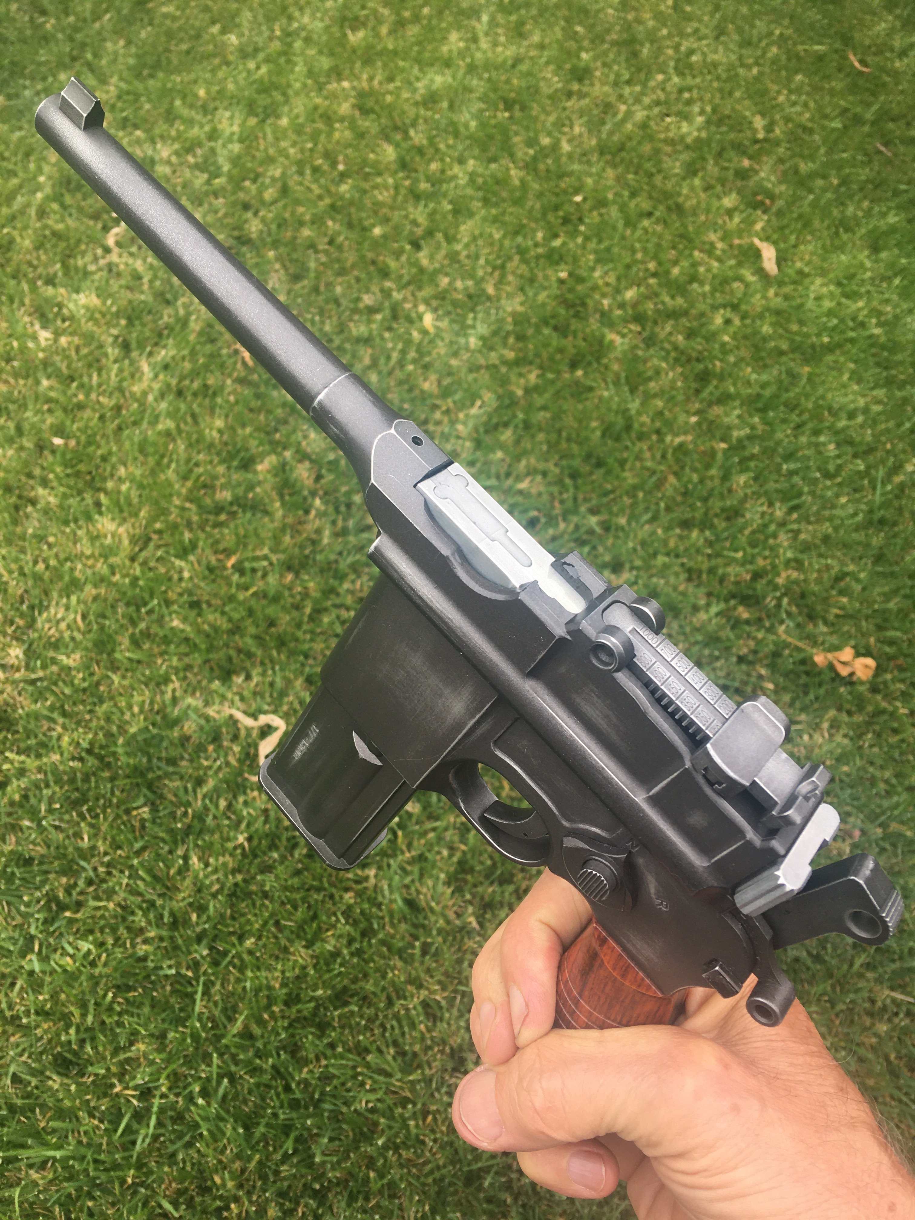

And it really comes to life after a treatment with “fine” steel wool … it polishes the matt finish to a smooth satin lustre that both looks and feels more real. I pushed it further for a more worn look, going to the bare metal in some places. Dipped the bolt in paint remover since the real C96 I’ve seen appeared to have a bare metal bolt.
I’m a bit surprised at the lack of interest in this versatile little airgun, especially given how inexpensive it is.

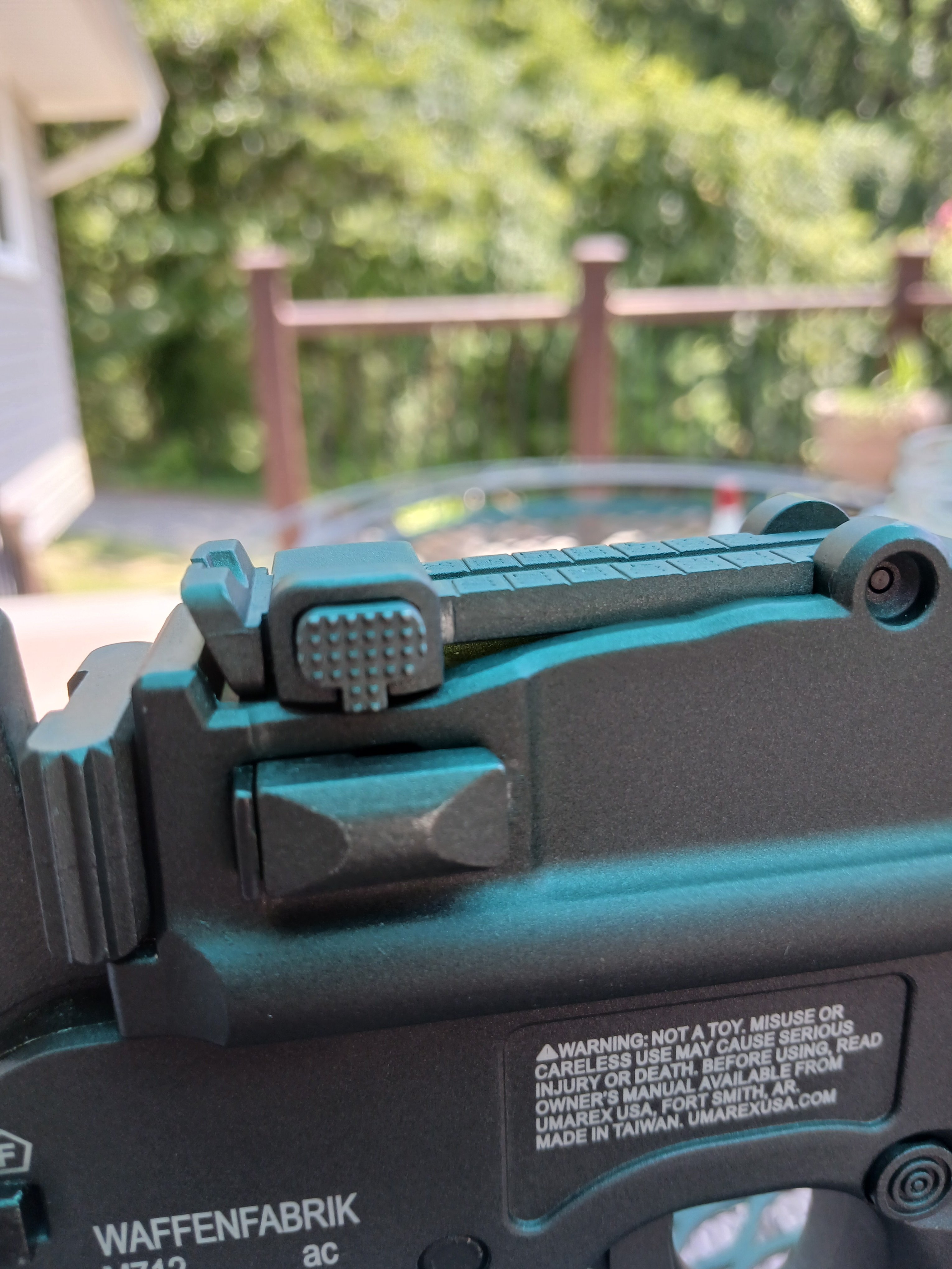

Oh … one more thing … when I got mine, the rear sight seemed a bit loose (side to side). I pulled the sight (knocked out the pin) and filled the holes in the sight with JB Weld. Then re-drilled the hole (through the JB Weld) very slightly undersized to the pin. This made a light press fit when it all went back together and now the sight has zero windage slop.
Reactions: megiddo65
If you think it’s more accurate now, just wait till you add the shoulder stock 🙂
Thanks! Good to know. I noticed the side to side movement on the rear sight last year. May have to take your advice if I'm seeking more accuracy.
Reactions: borne2fly
What I've done in the past to check whether iron sights are moving and affecting accuracy is attach a different sight, (scope or laser), and see if the groups tighten up. If they do then you know the sights are a problem. You don't need to mount or zero the test sight really well. You can use zip ties or tape so long as it stays put well enough to fire a couple of groups.
