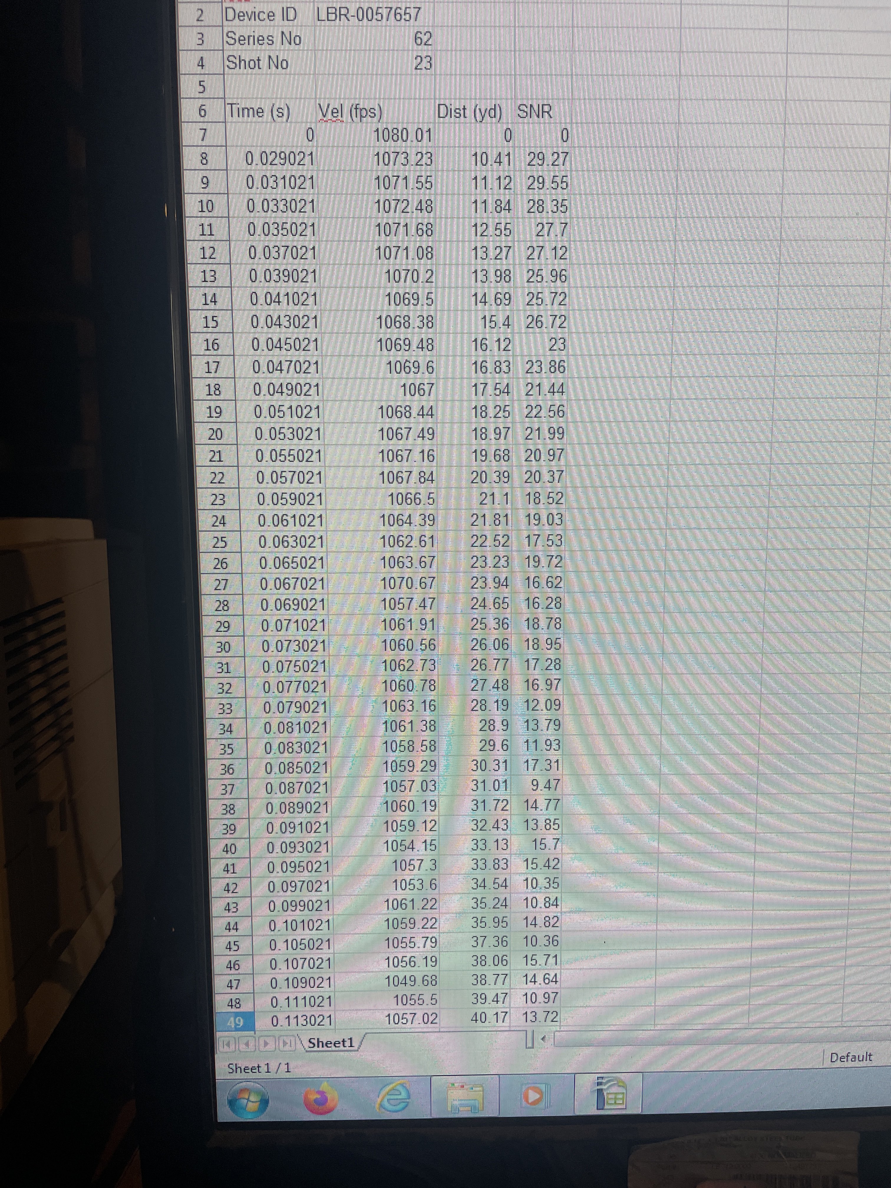

There are now a number of <$1000 Doppler radar chronographs available. They all display a refined subset of the tracking data, but only the Labradar gives me access to all of the tracking data. I can access the tracking data out to 100yds, in .002 second intervals (approximately every yard).
The built in apps for the various chronographs are all pretty good about refining the data to display in a simple to understand manner, but most are too simple. If you are interested in the most comprehensive ballistics data or are developing drag models, you’ll want the Labradar. Do any of the other Doppler chronographs give me access to that information?

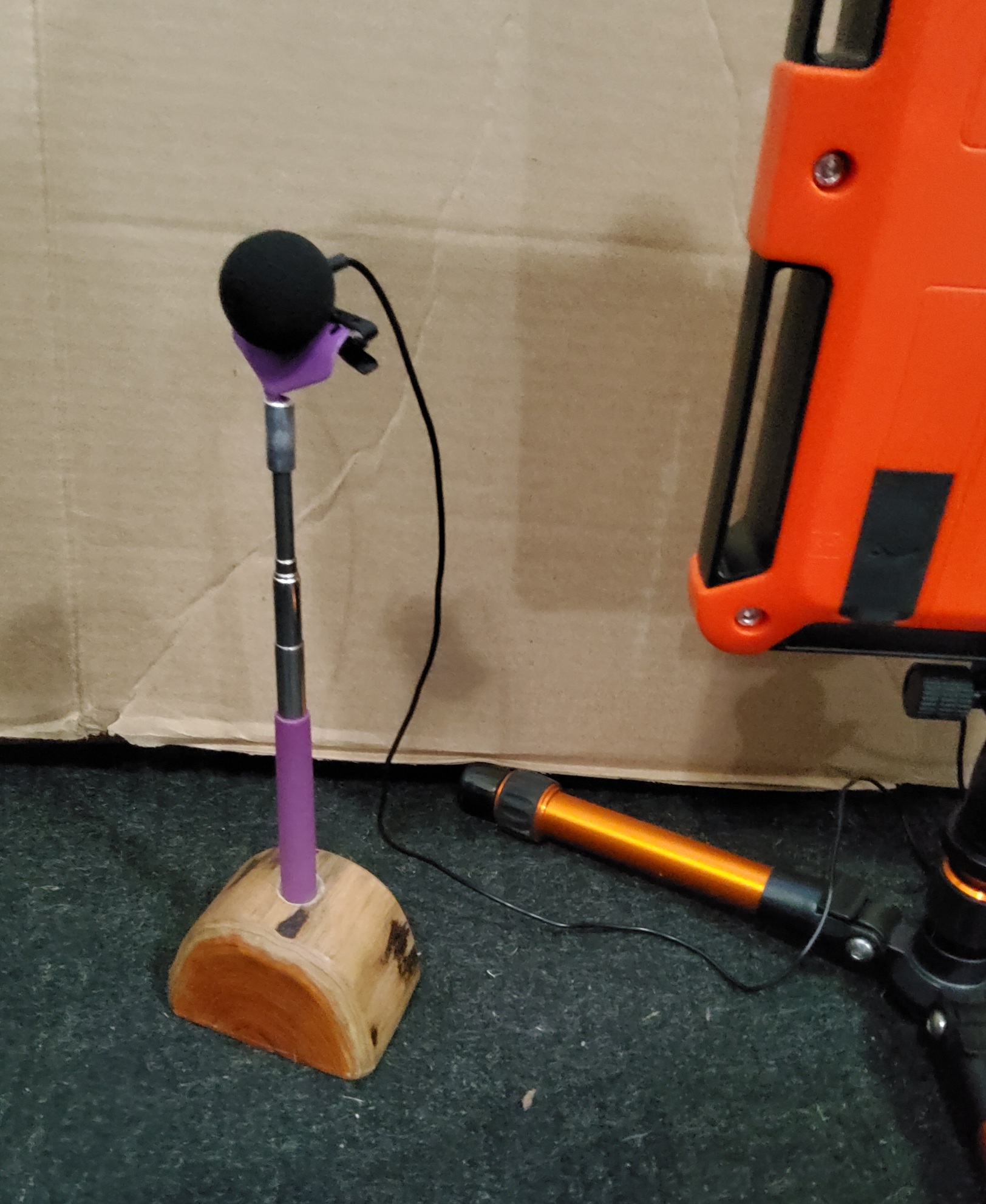

I use one of those telescopic "back scratchers" (available from Amazon for a couple of bucks) mounted in a wood base as a stand for the microphone. Takes a couple of minutes to make and seconds to adjust.
Cheers!
