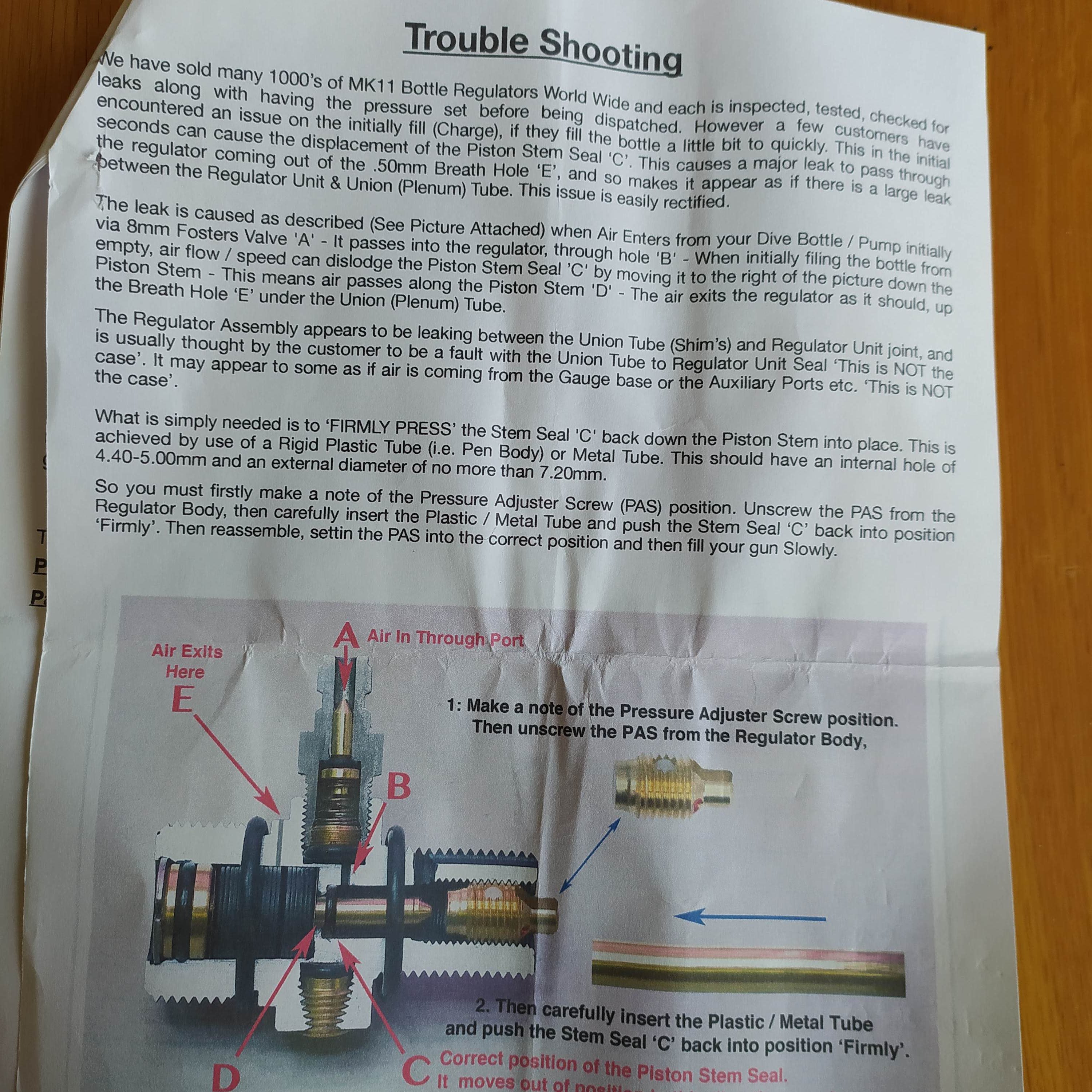

i have fitted a lane airbottle regulator,can somebody explain the filling process with any advice as im not getting the procedure correct
Have you read the Lane instructions?
I'm guessing, stem seal C is displaced, it just needs pushing back into place.
That's what the piece of plastic pipe in the kit is for.
