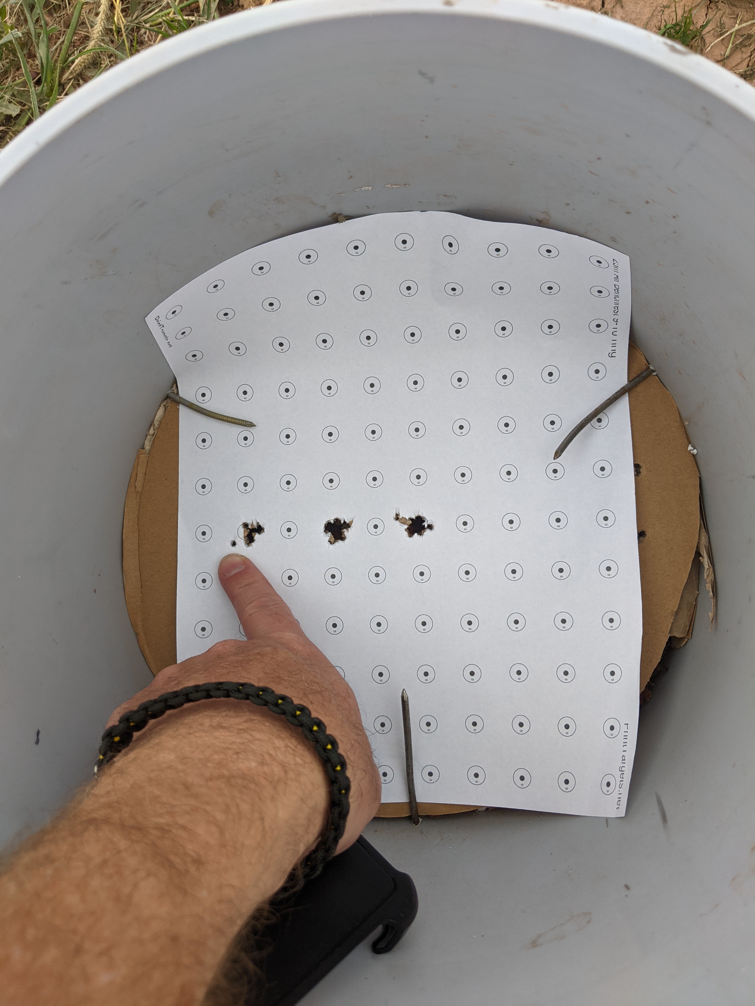

Here are some ten shot groups taken @ 30 yards without much wind from the carbon fiber wrapped poly barrel in the .177 Vet. Circles are 5/16"
I shot another couple 10 shot groups on that row and the rows above and below it after I took this photo. All 15 or so ten-shot groups looked about like those 3 above (pretty decent).

Here are some ten shot groups taken @ 30 yards without much wind from the carbon fiber wrapped poly barrel in the .177 Vet. Circles are 5/16"View attachment 285568
