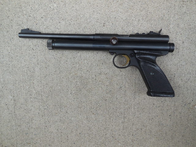

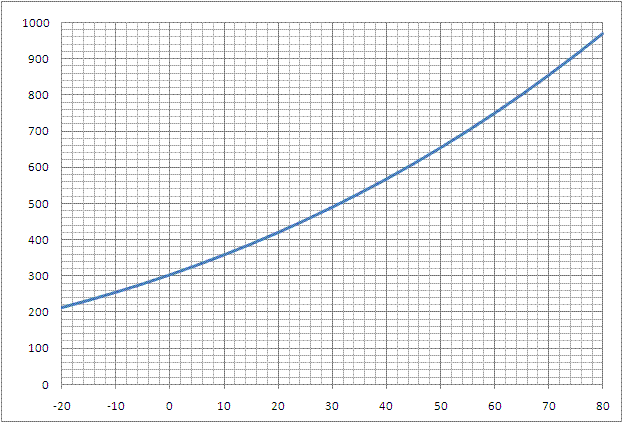

Back in the day I used to shoot lead balls out of a Crosman 1100. I remember the velocity as being a little over 300-fps with an 18" barrel. The balls were .355" in diameter and weighed (I think) 80-grains. They weren't very accurate but it was entertaining. Here's a chart of co2 pressures at various temps.

The 1100 is fun
