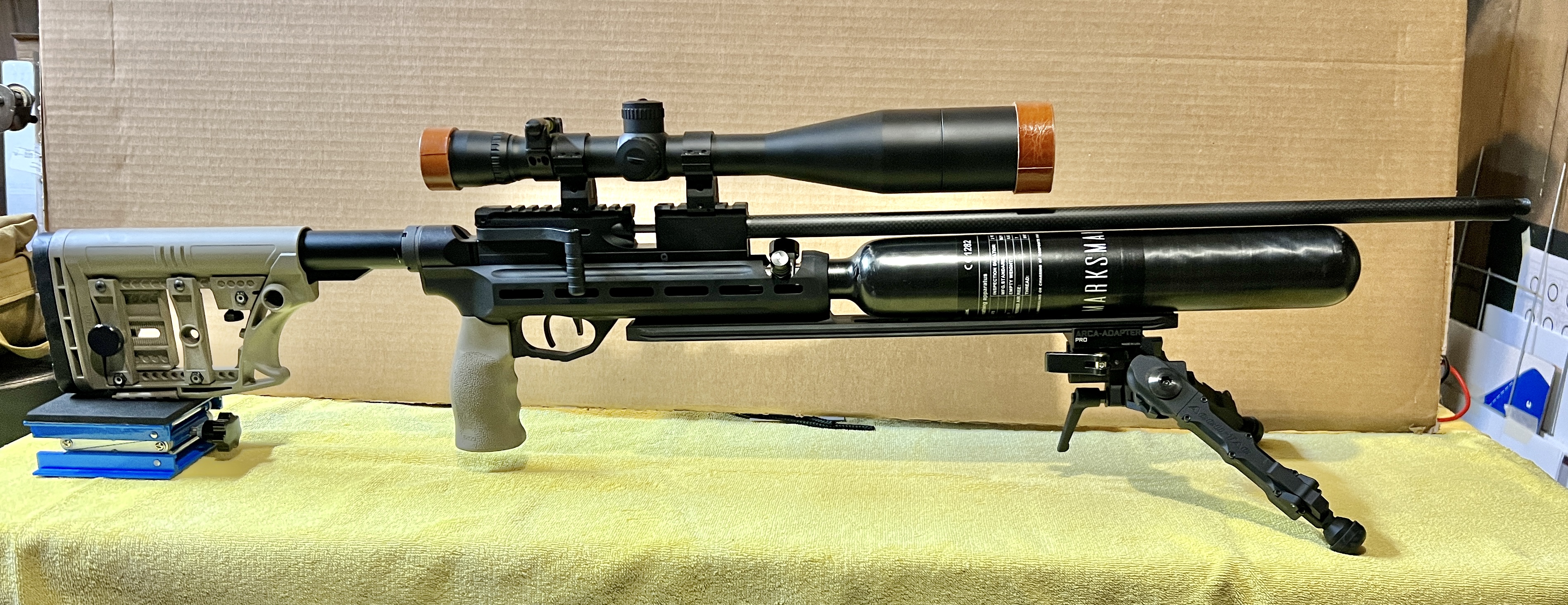

Larger capacity bottle for RAW HM1000x
you can keep looking on amazon for a Tuxing or Acecare bottle.
not very expensive, i picked up a 700cc bottle for 141..took a bit of waiting for a good price. I see they are up to 161 now
works, no problems.
they say not DOT, but this is not going to be recertified nor filled at a shop where that matters
18x1.5 thread

Apparently the tuxing bottles on aliexpress are sources from the same supplier fx uses. Ive bought a small one for one of my guns and it's solid. 18x1.5.watch the dimensions on that venue, they sneak stuff up on you.

All my aftermarket bottles on my guns come from AliExpress. 0.5l, 0.7l and 1.1l. The 1.1l requires a drop block regulator, I use the Huben Power Universal. You could put as big as 2l (Acecare not Tuxing) if you shortened that bottom rail and used the drop block regulator.

Did your bottle have the valve already? I am new to PCPs and am looking for a larger bottle for my Maverick.
The bottle i purchased did not have a valve included. I have seen bottles with the valves for sale at Arguns of Arizona, Utah Airguns, and Topgun-airguns
I just removed the valve from the previous bottle with a hex key
