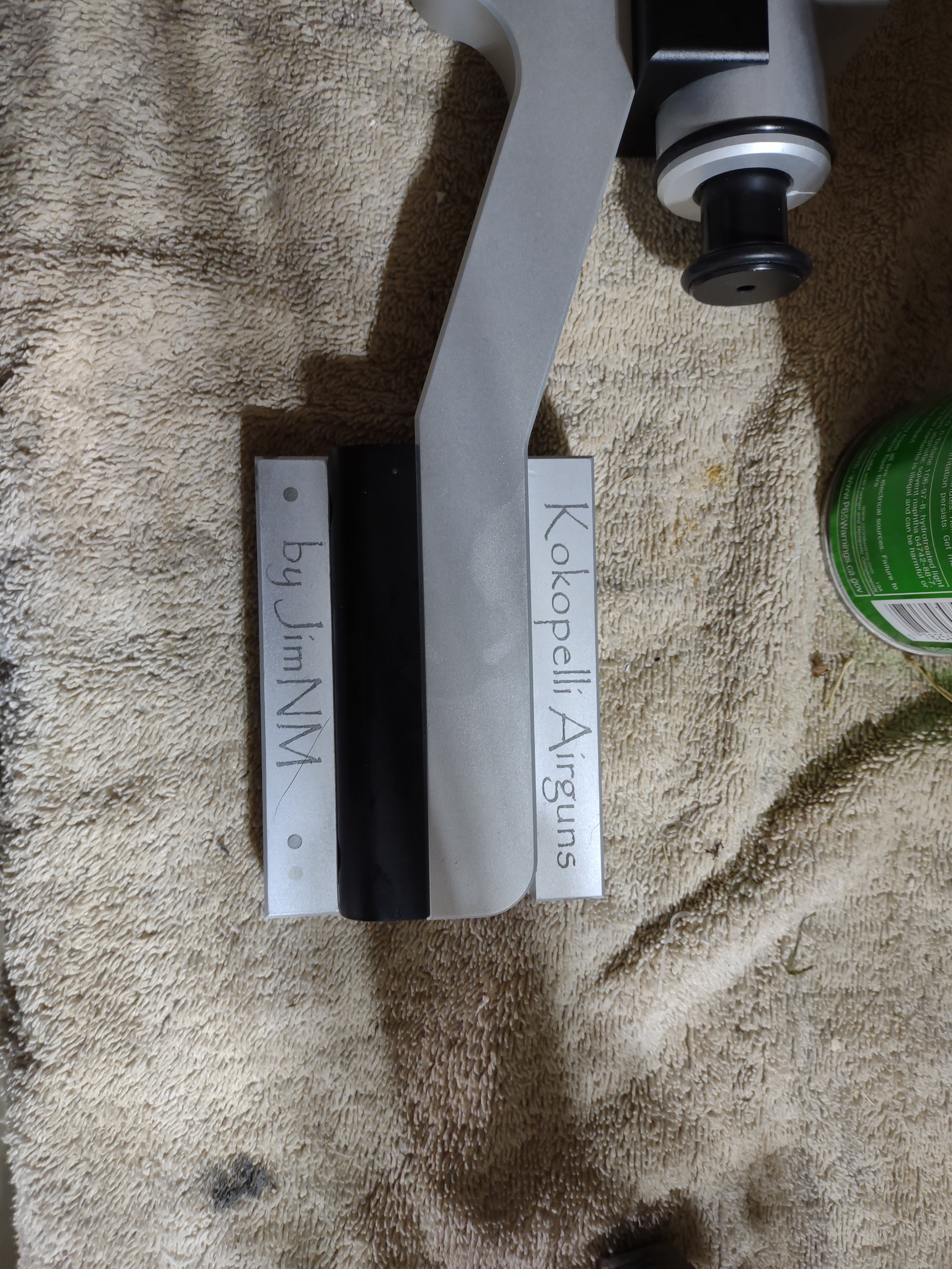

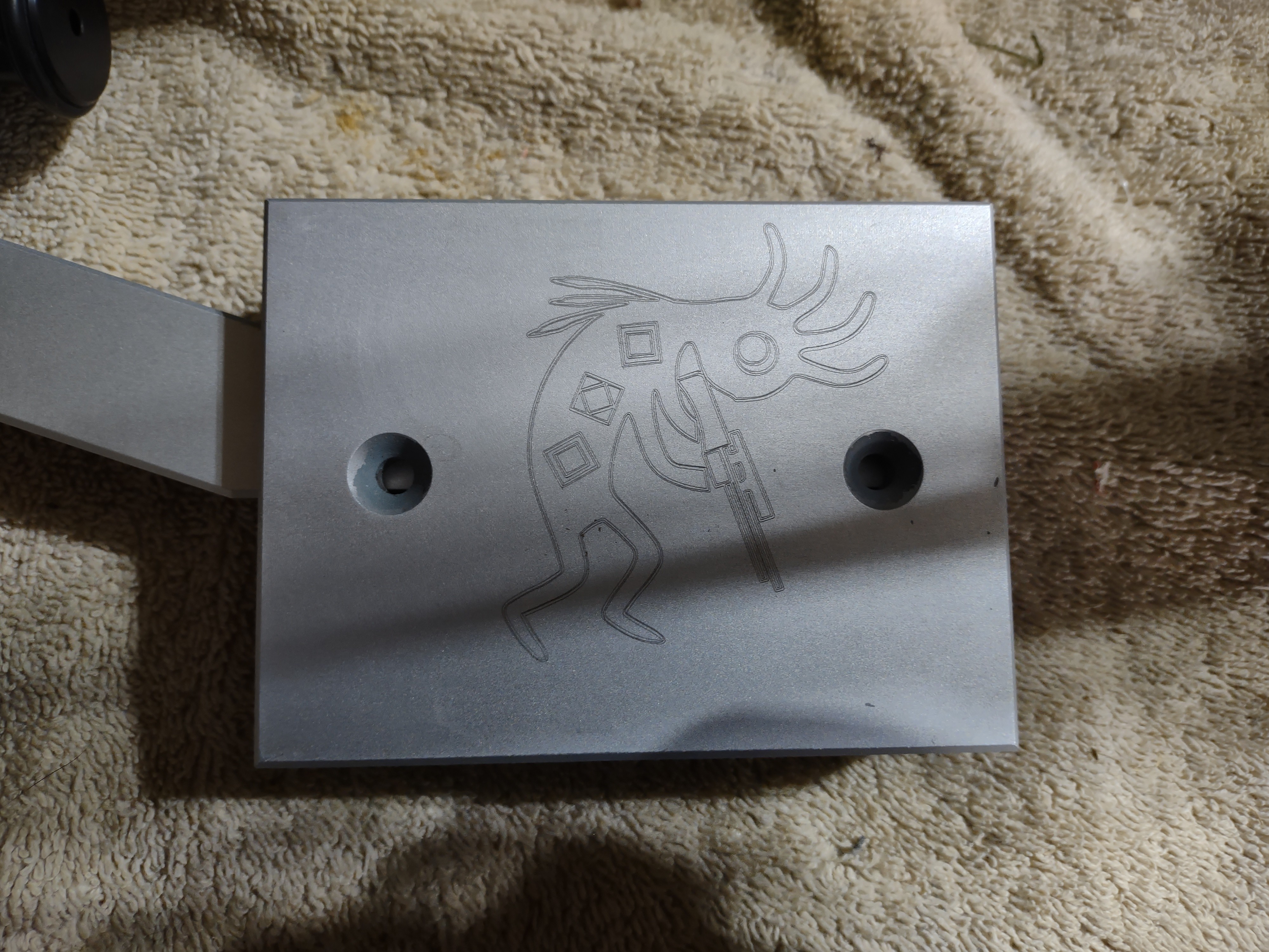

Had this done at a local laser engraving.
The magazine is aluminum, the black is color anodized. The laser removes the surface color and the raw material shows through. At least with my laser set up. The color of the aluminum can be from silver to white to amber, depending on how long (and hot) the laser is on each spot.
On plane grey anodized, I spray a coating on the piece and burn through.

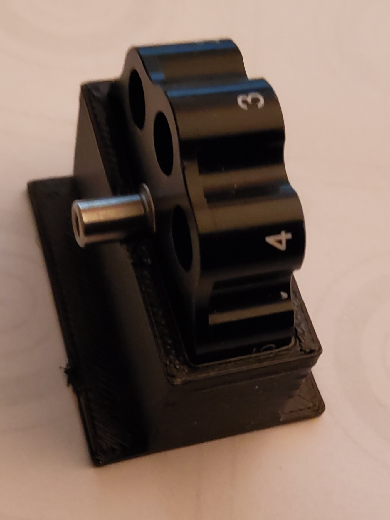

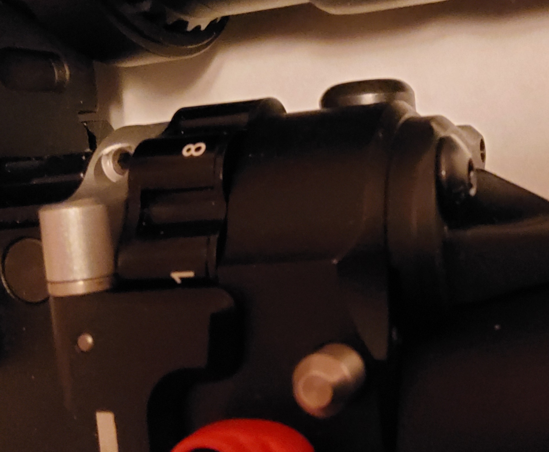

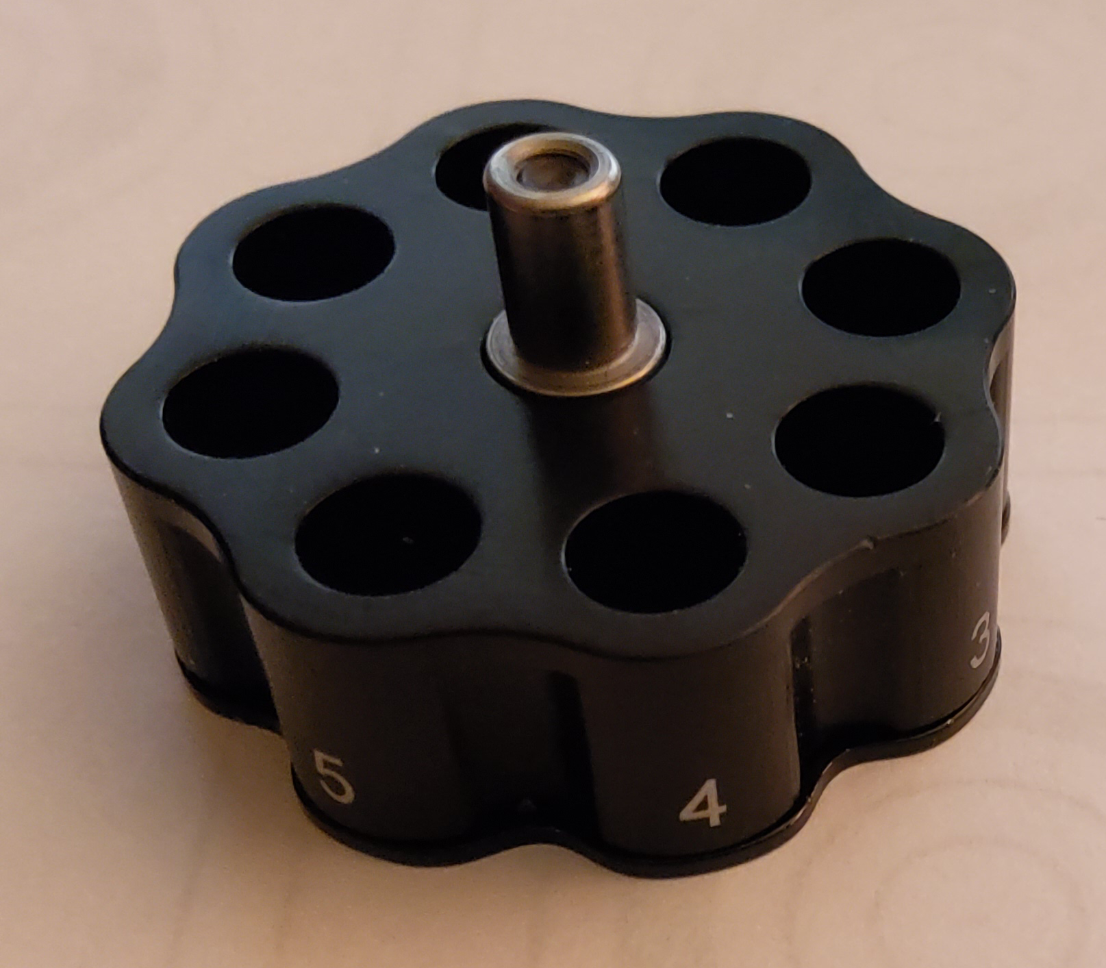

You don't get 'color' from a laser, it just removes the anodizing showing the base material. A shop need to be able to index the mag to do it correctly.
I removed the mag so it's easier, but looking into it some lasers can apply color just not the one my buddy has it's proper term from what I see is "marking" it adds that color to the area desired.
Reactions: Quad82
The color is an ink that is applied later then wiped off. They etch it deeper. I stand corrected, the technology has passed me by, along with a few decades. The process is interesting.
