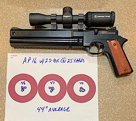

I recently lost an Ebay auction for what I figure was the best hunting scope for my much-beloved Ataman AP16; however, more recently found a new pistol scope that matched the specs, including the critical (for me) eye-relief. The 2.5-8X Crimson Trace pistol scope arrived today.
Of course I wasted no time confirming the quality... and eye-relief. It seemed to meet my requisites quite well, but required a bit higher scope mounts to clear the cylinder/magazine. After plugging the new scope height into the trajectory calculator, 25 yards seemed the best zero range for my purposes. So I set about zeroing the new combination with serious sand-bagged accuracy testing, for the first time at less than 50 yards with my AP16.
Don't know how closely I approached the guns abilities, but the results are gratifying enough for my (hunting) purposes. Three consecutive five-shot groups at 25 yards with 15.9 grain FX branded JSBs at 665 FPS/16 foot pounds-
(All 15 shots would have gone into .50" center-to-center)

Huh, that's all very informative. And a comparison that likely didn't leave anything lacking! I figured the CT would be a bit heavy. But as stated, may aide the accuracy of that, some-what light-weight pistol on rest. 👍 I'll be honest, though. BDC reticles irk me, lol. But can definitely be more useful than weaver. Overall it looks like it's of pretty nice quality, and the price aint all too bad either.

For its length, I consider the weight and balance of the scoped AP16 very good, Hawk. More specifically, a good balance between heavy enough for good rested shooting, but light enough for offhand hunting shots. And the balance is neither too front-heavy, nor too far back.
Shooting a long eye-relief scoped pistol well is not easy, and downright wishful thinking with too heavy or poorly balanced rig. Finding the best magnification for shooting any particular scope-pistol rig helps, but it's still quite a challenging proposition. All that said, I can do good offhand work with the scoped AP16 for somewhere between a few to several shots before my concentration starts failing me.
