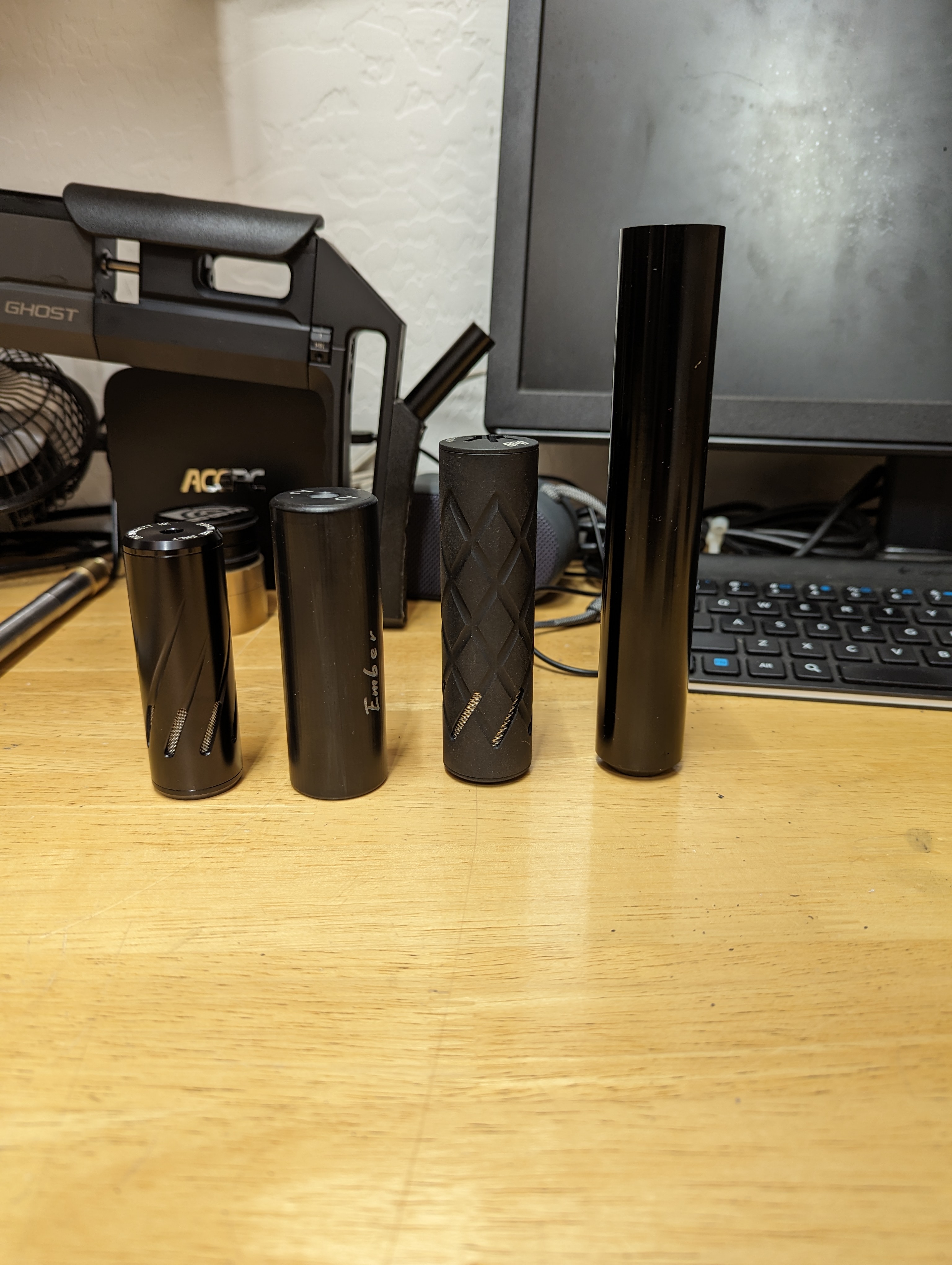

I recently received an Old Spook, “Ember” moderator designed for .22 caliber, and a carbon fiber shell. Construction is top notch, literally beautiful. To date it’s been used on two completely different rifles, for over a thousand rounds total and with similar results. Very noticeable sound reduction, looks great and most importantly, no loss in accuracy at all.
Two photos. First the Ember on a .22 BRK Ghost. Second shows the Ember on a new .22 FX King.
It’s the same moderator in both photos. The logo was installed on the moderator to be correct on one of the rifles, but we’ve been testing the moderator on the other rifle too. It works very well on each rifle, which shows the versatility of the design.
I’m certain the logo can be installed any direction a person wants, or even by the customer themselves.

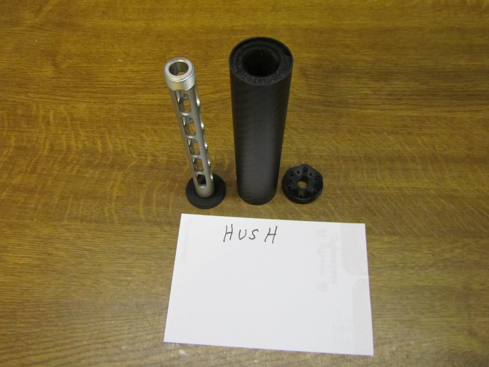

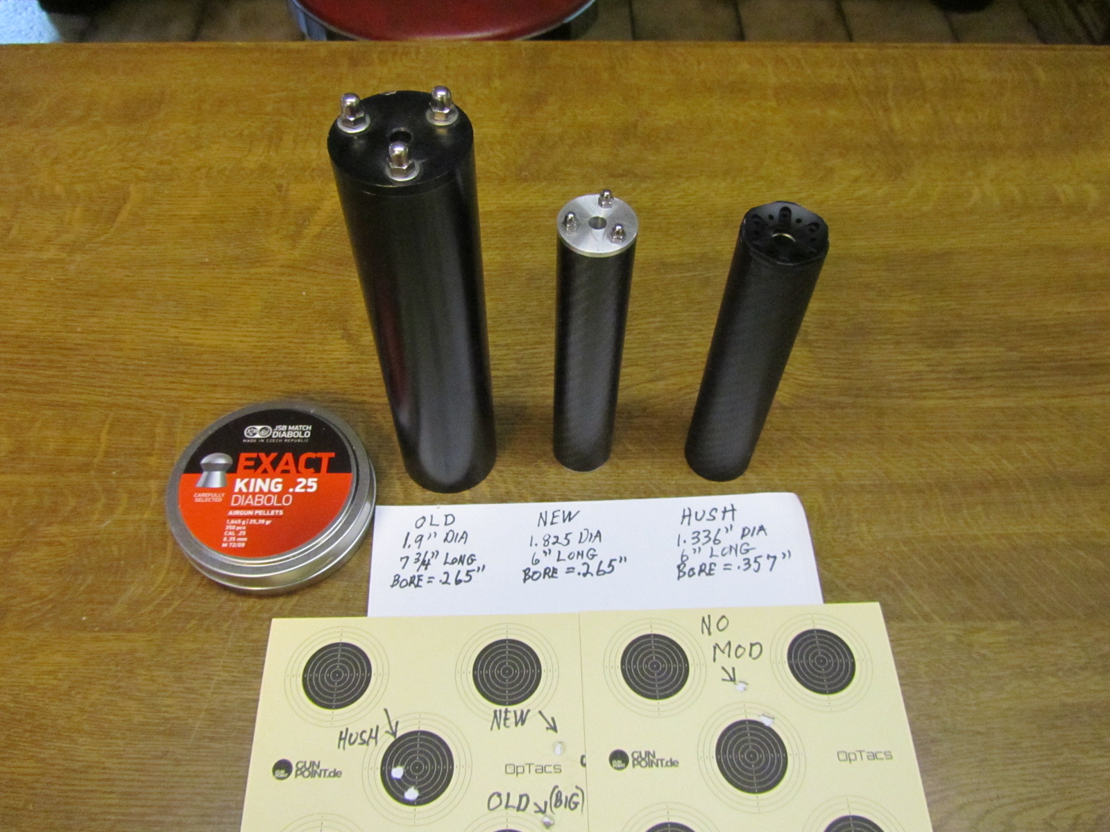

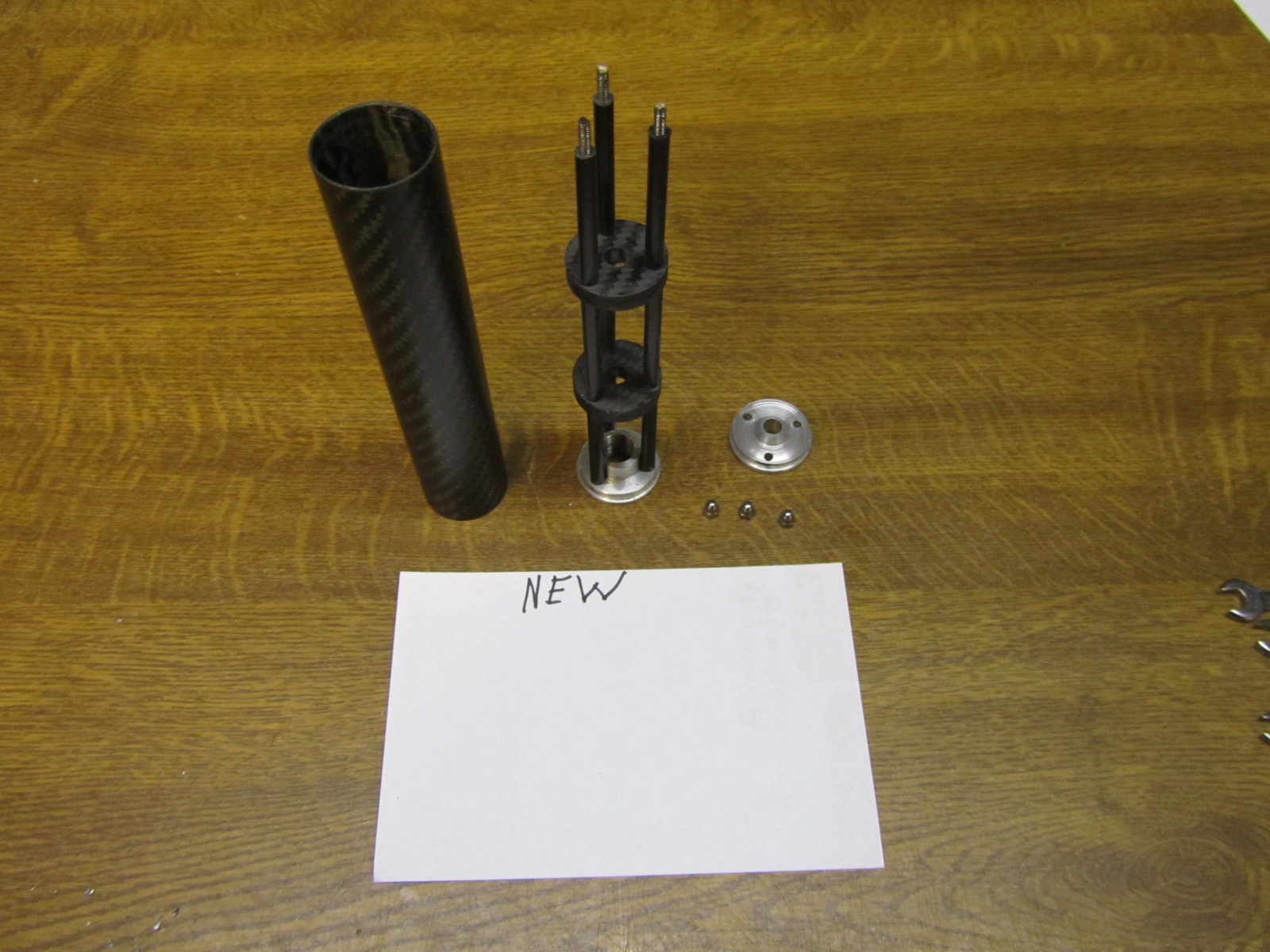

So, show your mods disassembled. Here are two of my latest along with a new Hush that came with my new GK1(which does nothing). Please note they are all shown with dimensions. Both of mine work well in my tests. I have sent one of the new 6" Mods to the HUBEN gun shop in Spain for their testing and evaluation as my opinion is both biased and subjective. The old design is all aluminum and has inverted conical baffles. The new 6" model has aluminum end caps , carbon fiber outside tube and carbon fiber flat baffles. Both style baffles work well, but the conical baffles are superior. The older 7" design uses 5mm stainless compression studs and stainless acorn nuts along with a small stack of Belleville spring washers on each stud. The new design at the smaller diameter uses stainless M3 studs and stainless acorn nuts without Belleville washers. I also included two alignment gauge rods in the shipment to verify correct barrel to moderator bore alignment one in .22 and one in .25. Note: the diameter is not 1.825 that is a misprint. It is 1.185". It weighs 180 grams.

I'm not demanding anything nor am I insulting you or your efforts. Since most folks do not have the facility to compare or accurately measure the sound of a moderator, I have asked you to show your mod disassembled with dimensions. You asked me to do the same. I included the photos originally included in the GK1 mod thread here on this thread for your convenience. You have not done the same nor have you linked the thread where you have done this in the past. I have not said that your mod is better than mine or visa/versa. You should be proud of your work as I am mine. Why not show it off?
It would be great if there was a unbiased special testing facility available where all these moderators could be tested against each other, but there is not. I sent my mod to the HUBEN gun shop not just for evaluation and unbiased feedback, but because the HUBEN mod adaptor design issue which allows the adaptor to skew out of alignment with the barrel. That is why I also sent two alignment testing rods as well. Hopefully they can convince the HUBEN factory to change the adaptor design.
