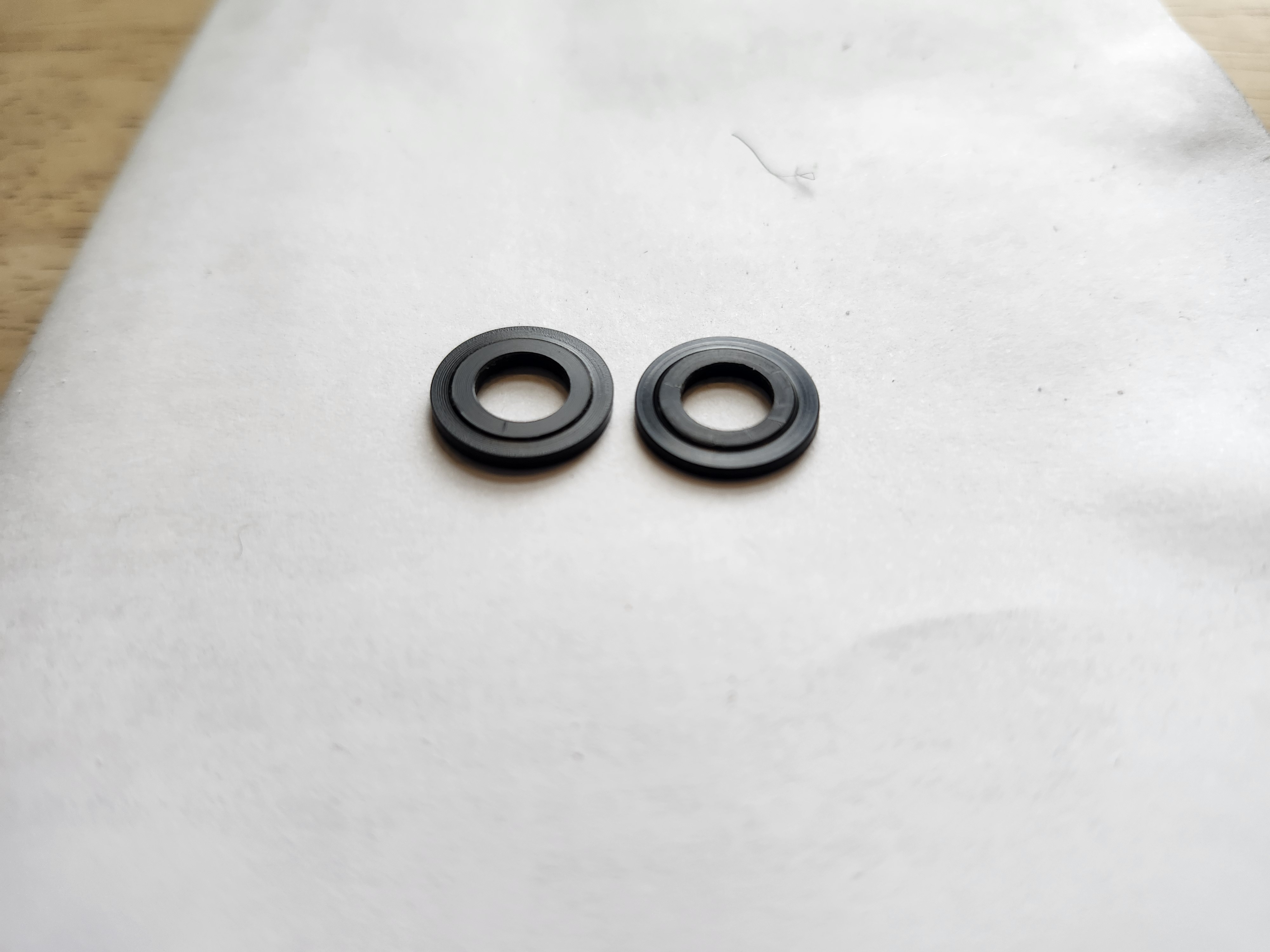

I need a valve seat made for my rifle out of Delrin. I have seen a lot of talented people on this forum and figure I would ask here to see if anyone if interested. Below is what I need.
Part number 73 is the valve seal.

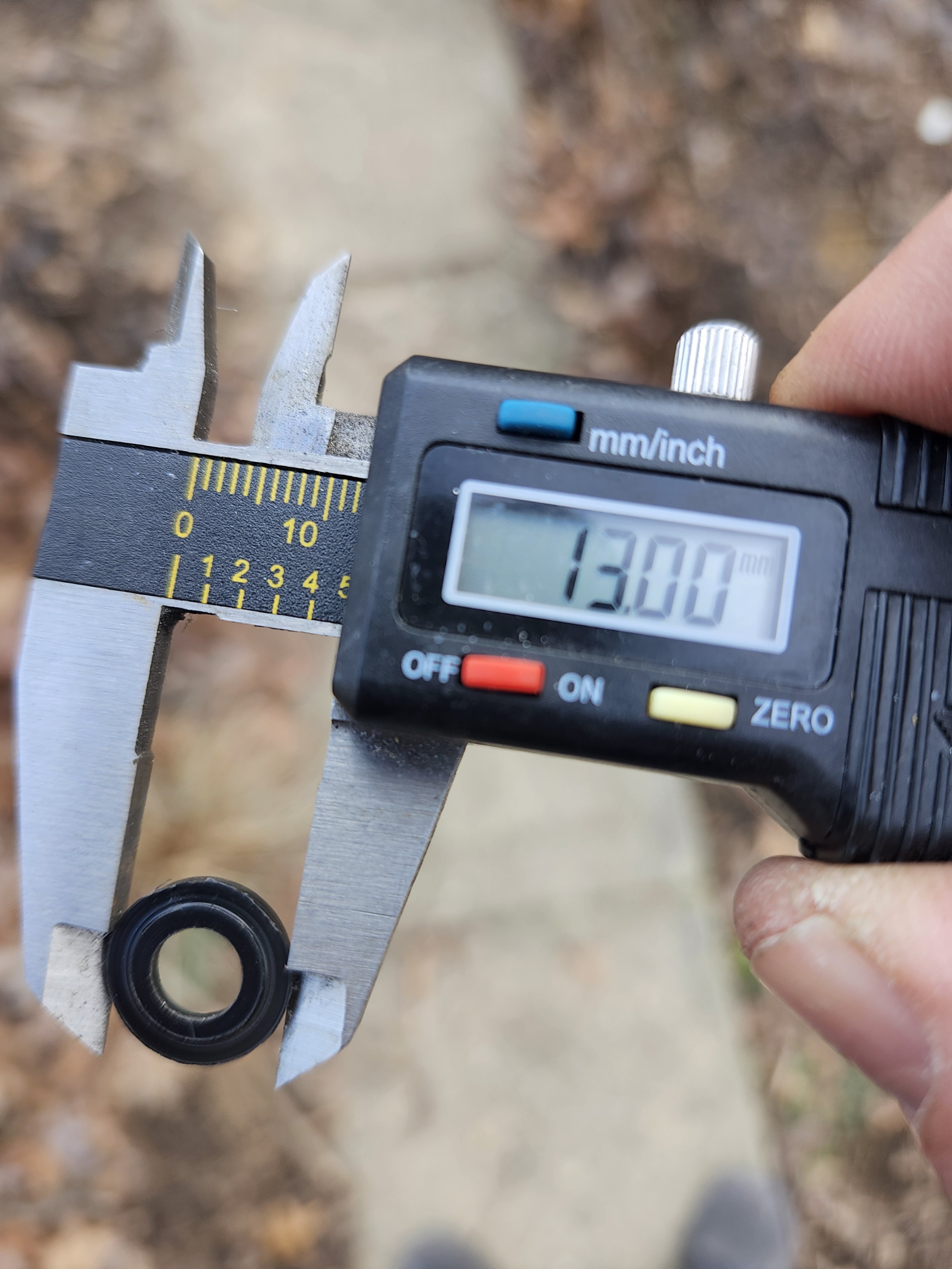

The outside diameter is 13.00 mm

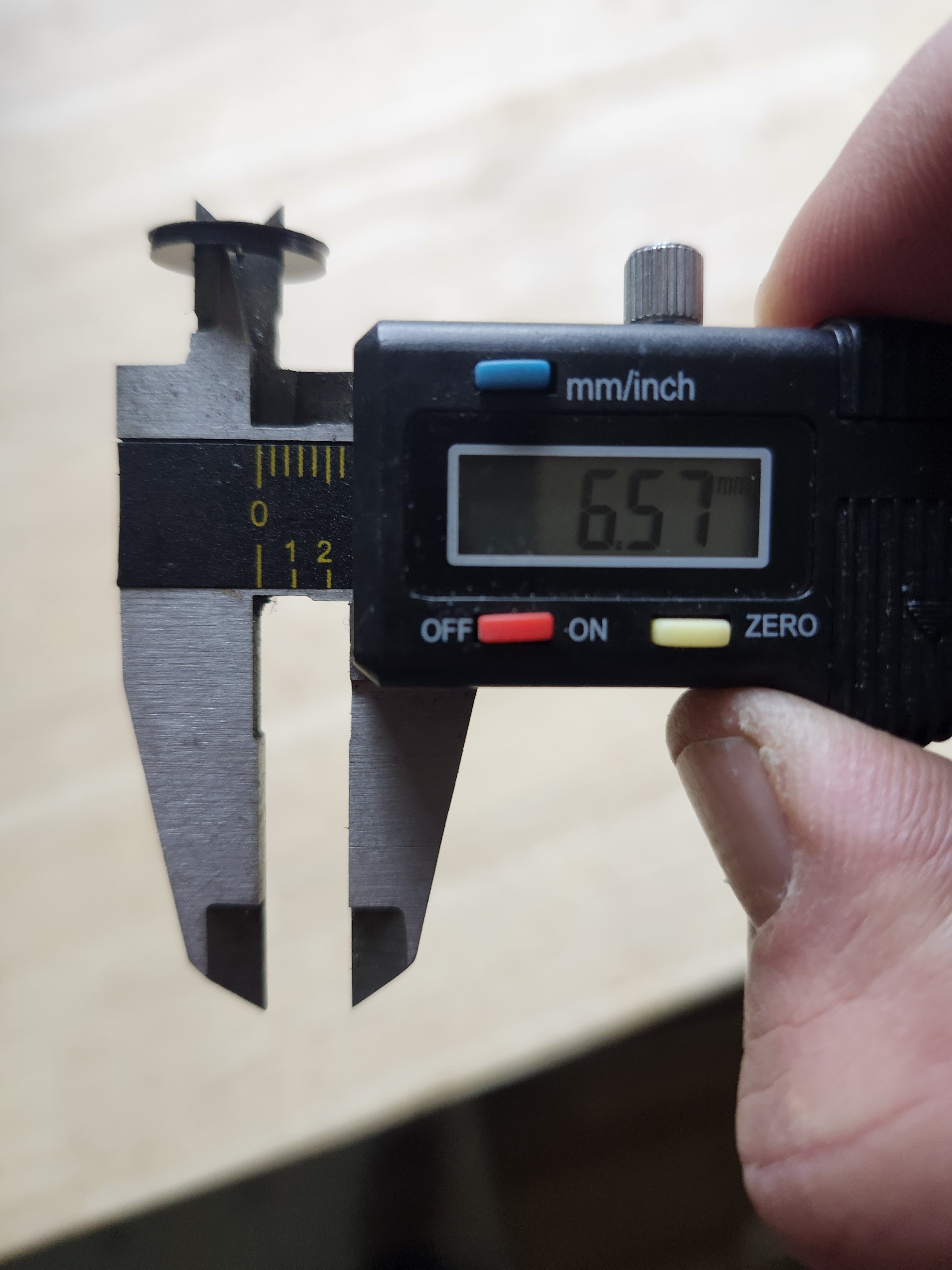

The inside diameter is 6.60 mm (this is the hole in the seal)

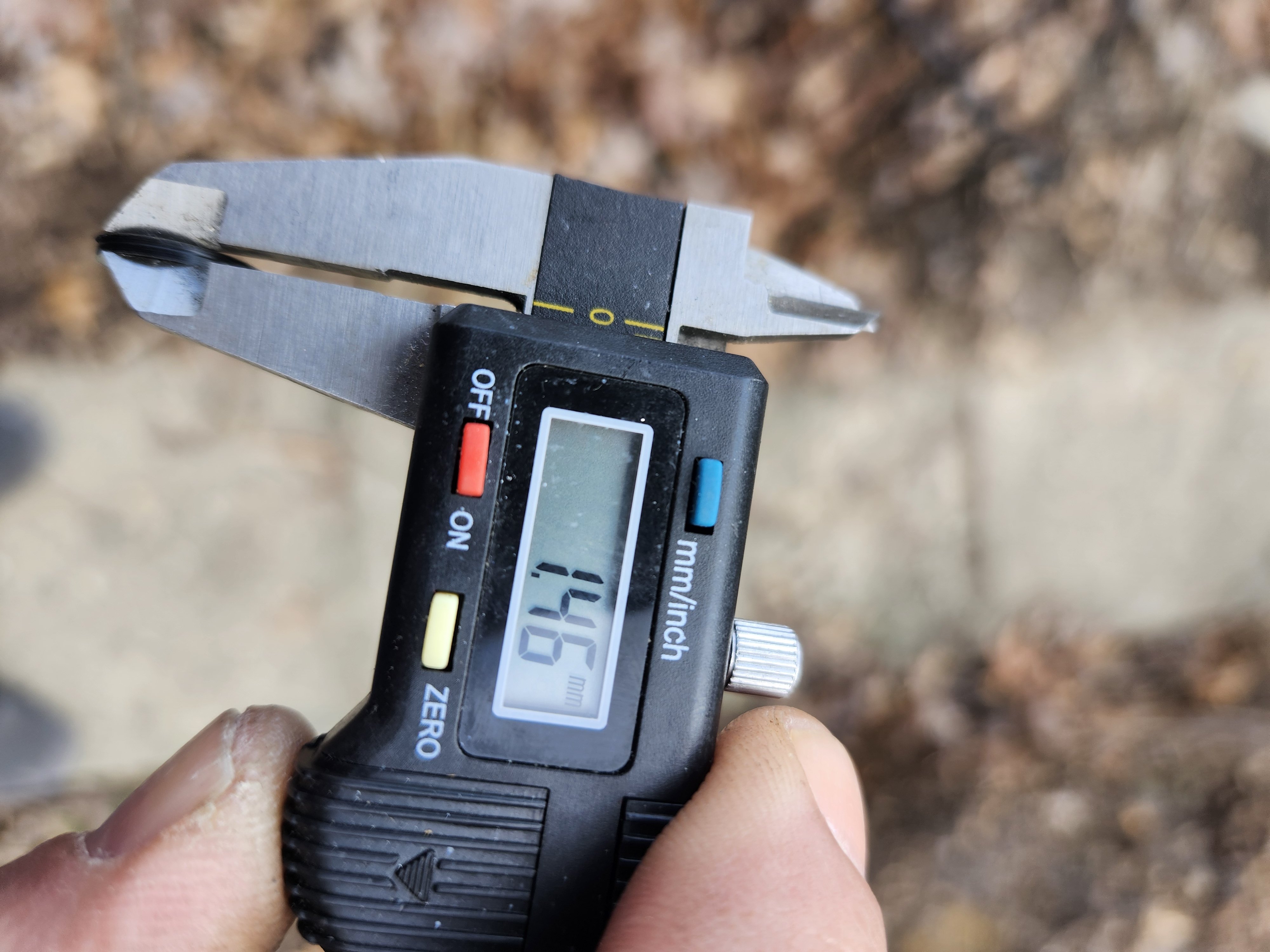

The outer edge thickness is 1.45 mm
