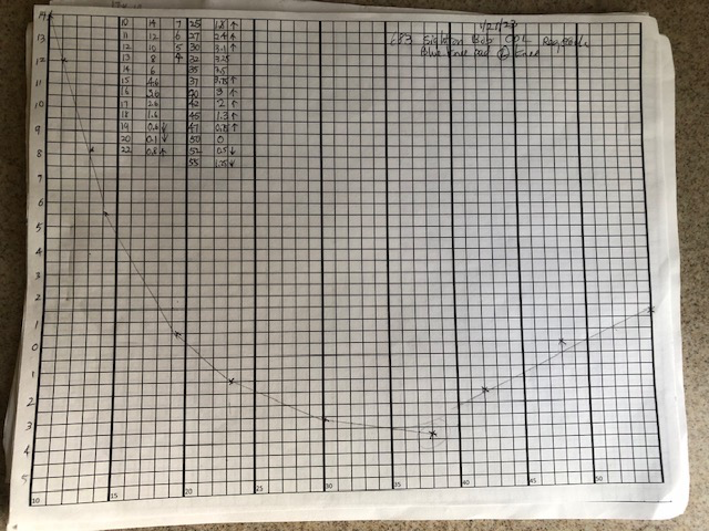

1. calibrate my scope/parallax wheel from 10-55 yards.
2. minimally I shoot 5 distances to construct my dope sheet.
3. graph the results from #2 to extrapolate information for other distances. (too lazy to learn or use a ballistic app)
4. shoot the in-between distances and use the graph for POA to verify actual POI
I try to do items 1 and 2 in one sitting.
Sometimes I'll do item 1 separately as it's the most tedious part (1 hr minimally?) I've calibrate my scope at my office parking lot during lunch time and got some strange looks ....a guy with a scope (NOT mounted to a rifle) in his car ...yardage tape and paper targets...hmm someone call 911. I was at least dim witted enough to leave my rifle at home during this process.
item 3 can be done at night or leisurely at home ...4 is done whenever I have time
The graph below is the holdover for my TX/Sightron combo shooting CPL from 10-55 yards (The only thing missing on that dope sheet/graph is the Chrono/FPE information. I cheated on this one and shot 11 distances).
I've tried doing a paper graph, but some of my gun/scope combos appear to defy physics. Chairgun is easier, but I don't use Chairgun to extrapolate dope. I use Chairgun to record real world dope. Then, if I am trying a gun/scope combo from the past, I can pull up the Chairgun file.
