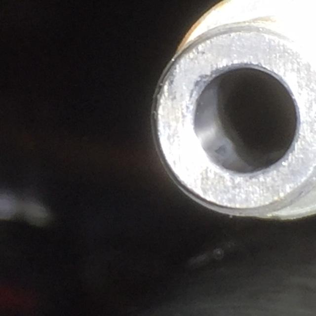

Well, I got it off (Thank You BenSeager). I believe I've discovered the accuracy problem: No Rifling! Will be calling AOA tomorrow.
The LCS Barrel is Lothar Walther and it is rifled however the lands are extremely soft. The breech is back bored to allow for proper ingress of pellet into the rifled part of the barrel. Like a funnel.
Do you think this is a Lothar Walther Rifled Barrel? Mine is on the way back to AOA and is scheduled to be delivered on Monday. I hope to hear back shortly thereafter.
