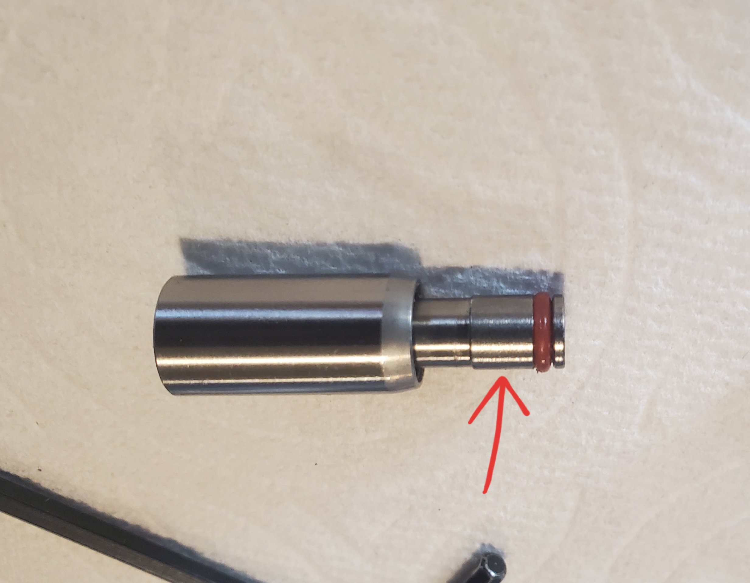

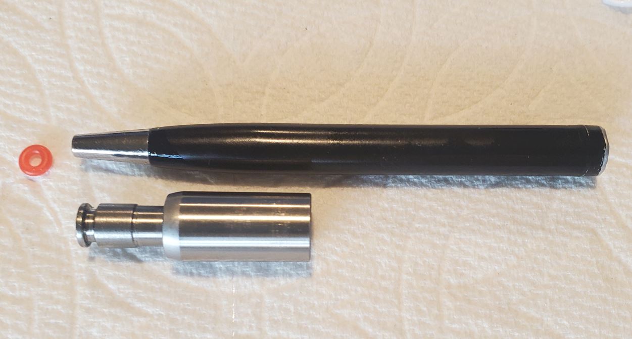

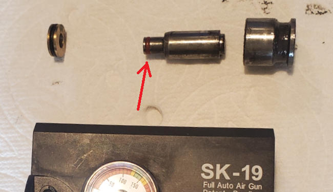

I finally got to it today and fixed it following Nate's Youtube video. I am posting pics on how to replace a red o-ring, which is nearly impossible to replace. I broke one trying to use a pick tool. So, I had to make a tool. Fortunately for me, I had the perfect sized pen for the task. I used a chop stick to load the pen tool, then the pen tool to install the o-ring see photos.
This is the culprit:

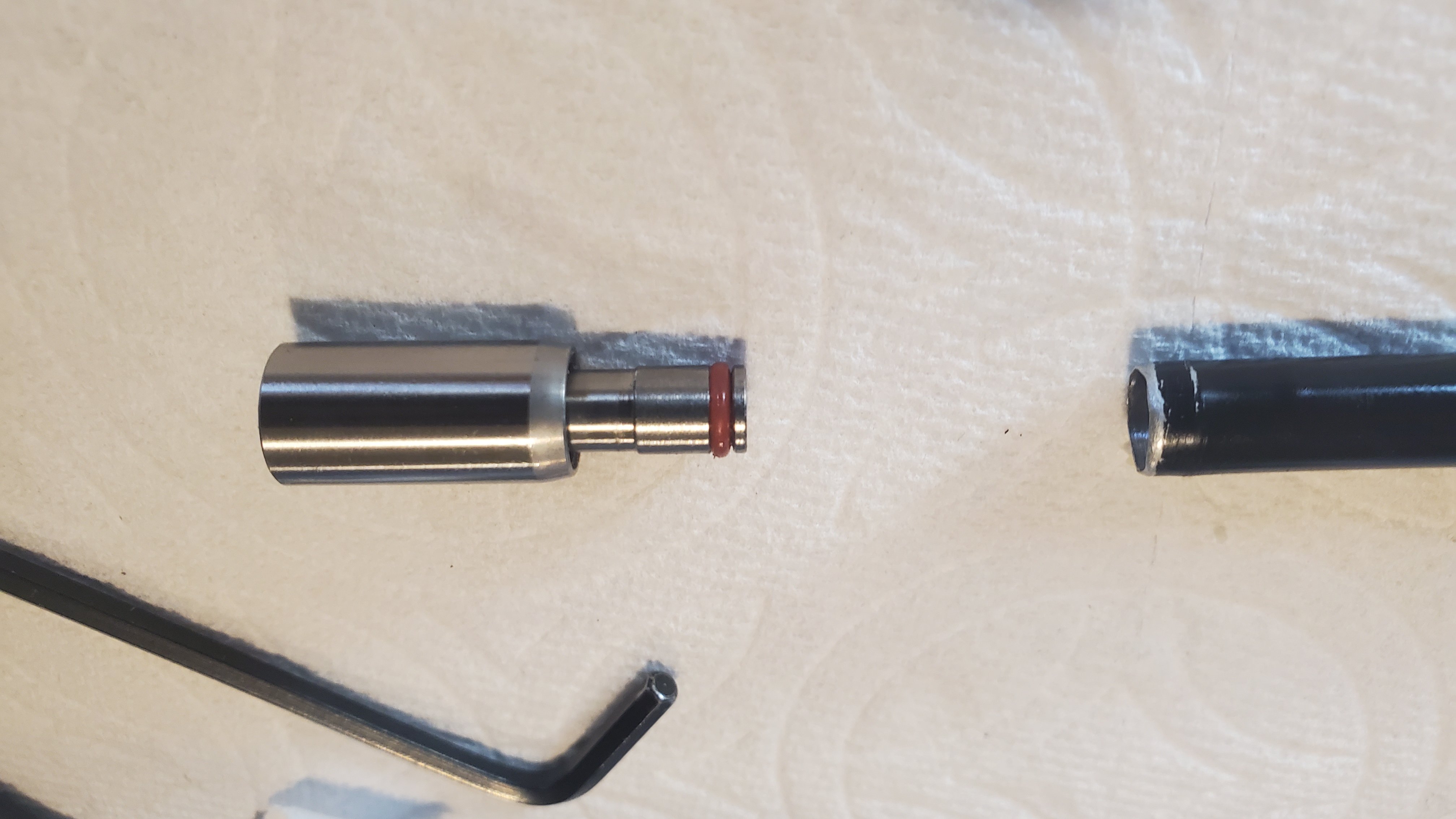

This is the tool, made from an aluminum ball point pen body:

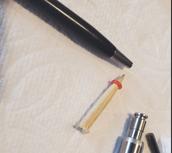

I had to use something to load the o-ring onto the pen tool:
The pen body was perfectly sized to allow the receiving part inside thereby allowing the o-ring to slip onto it:
Success!
Hope this helps anyone with the same problem.
