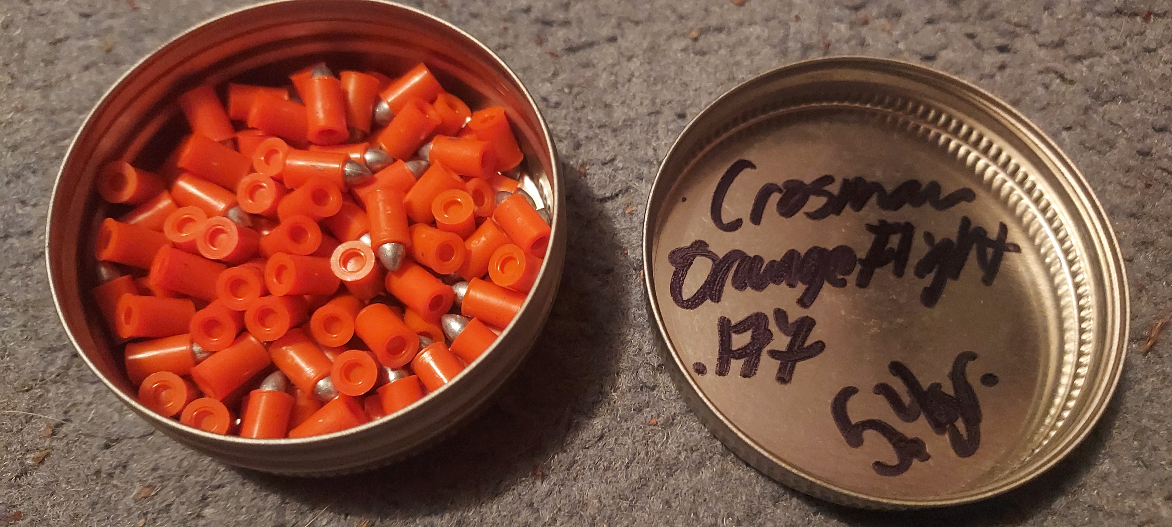

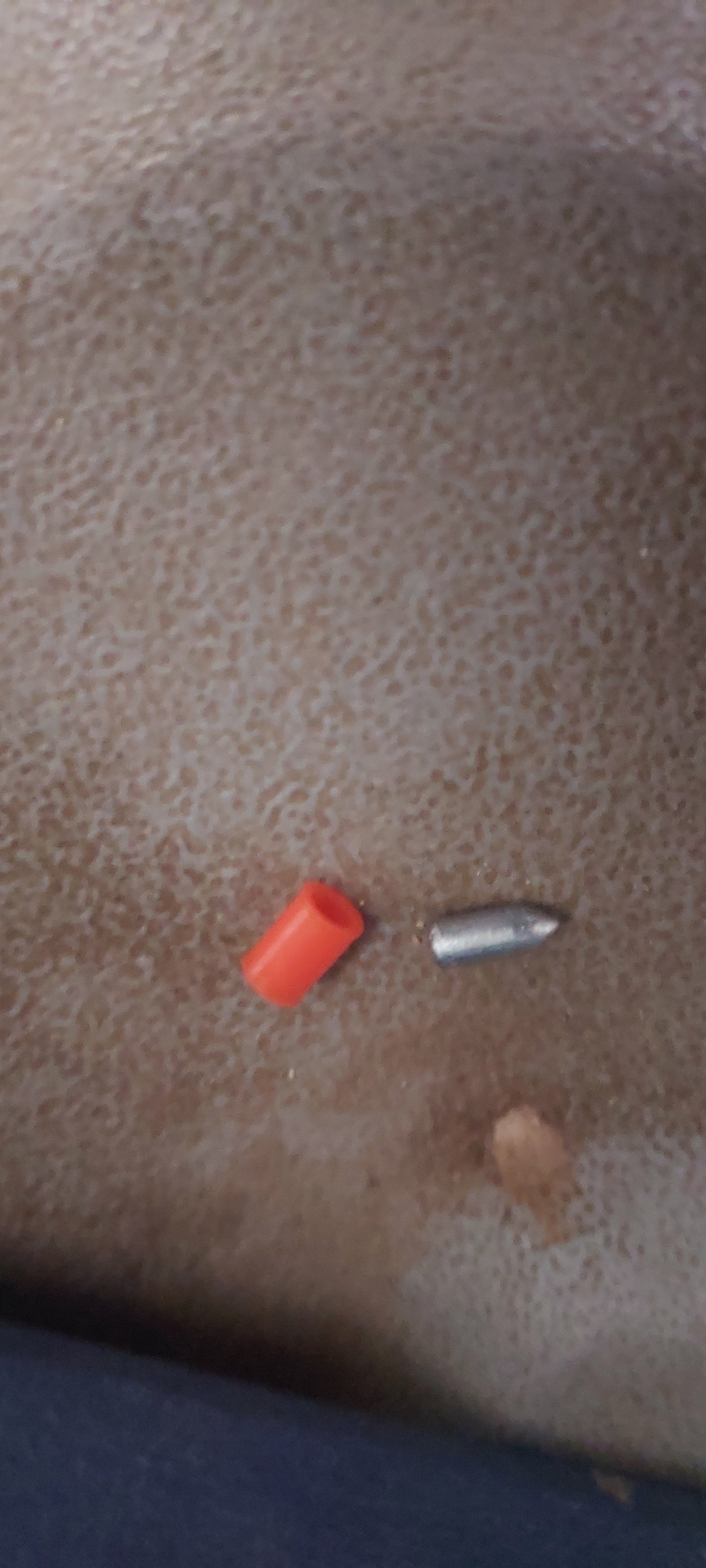

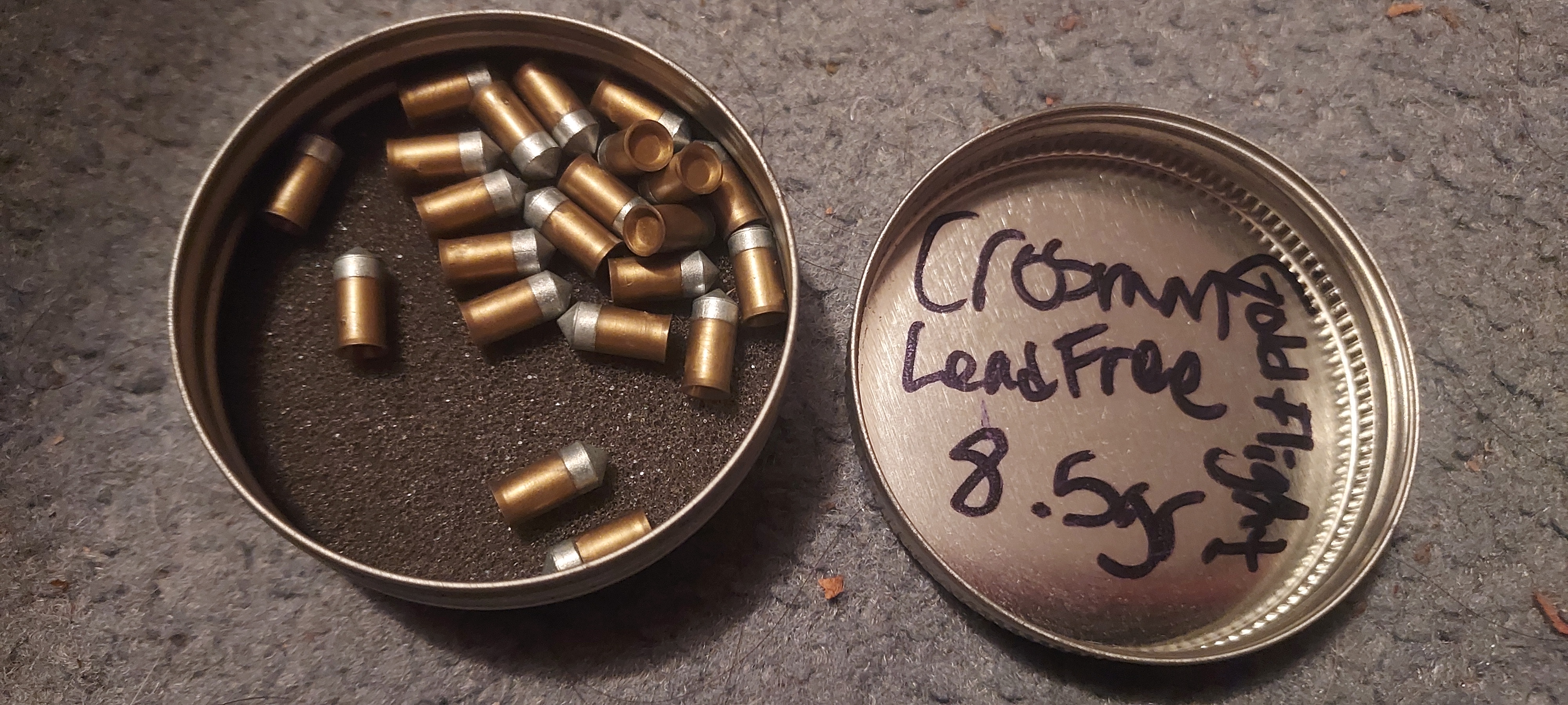

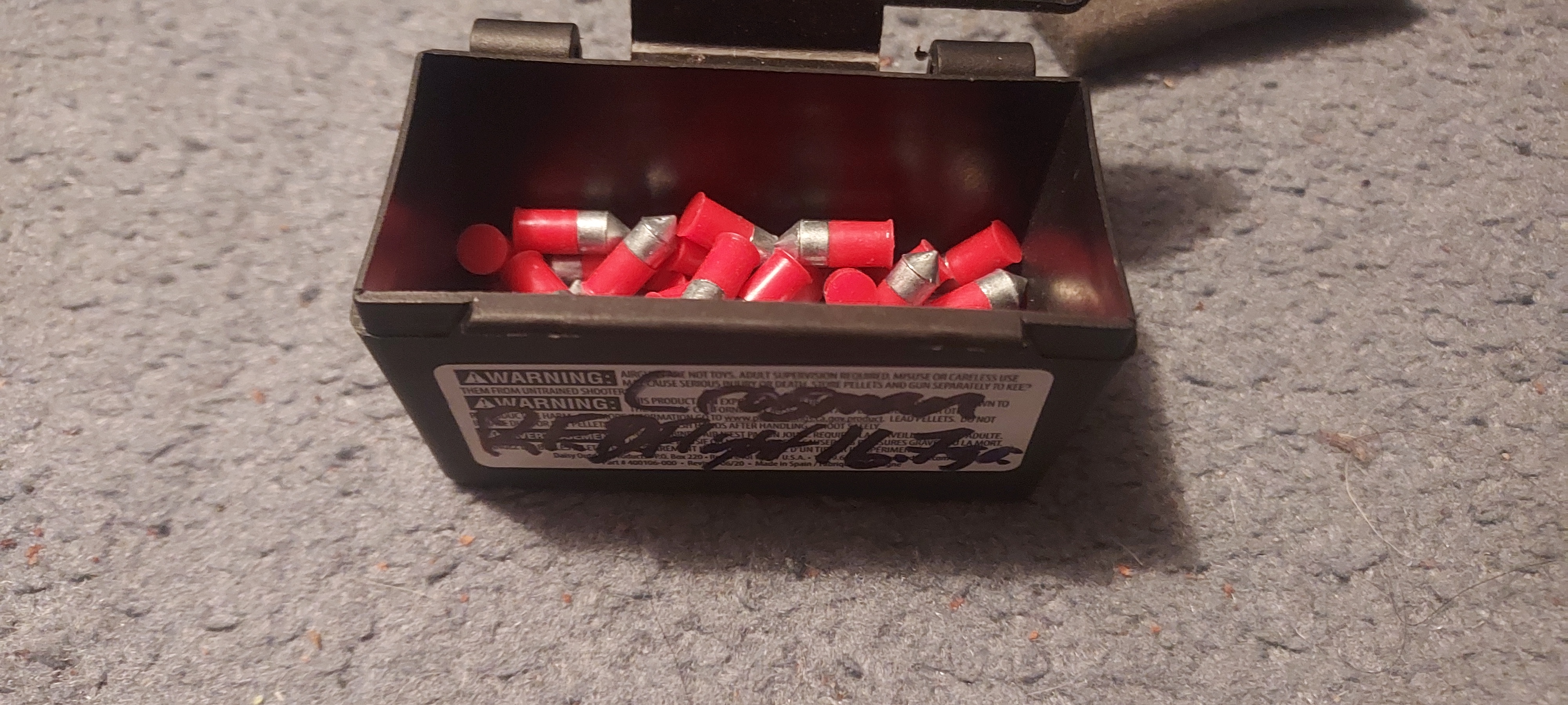

Some time ago I made these .30 cal sabots for 3D printing, which could be used with either .22 or .25 cal. lead free slugs or pellets... Here's the link:
