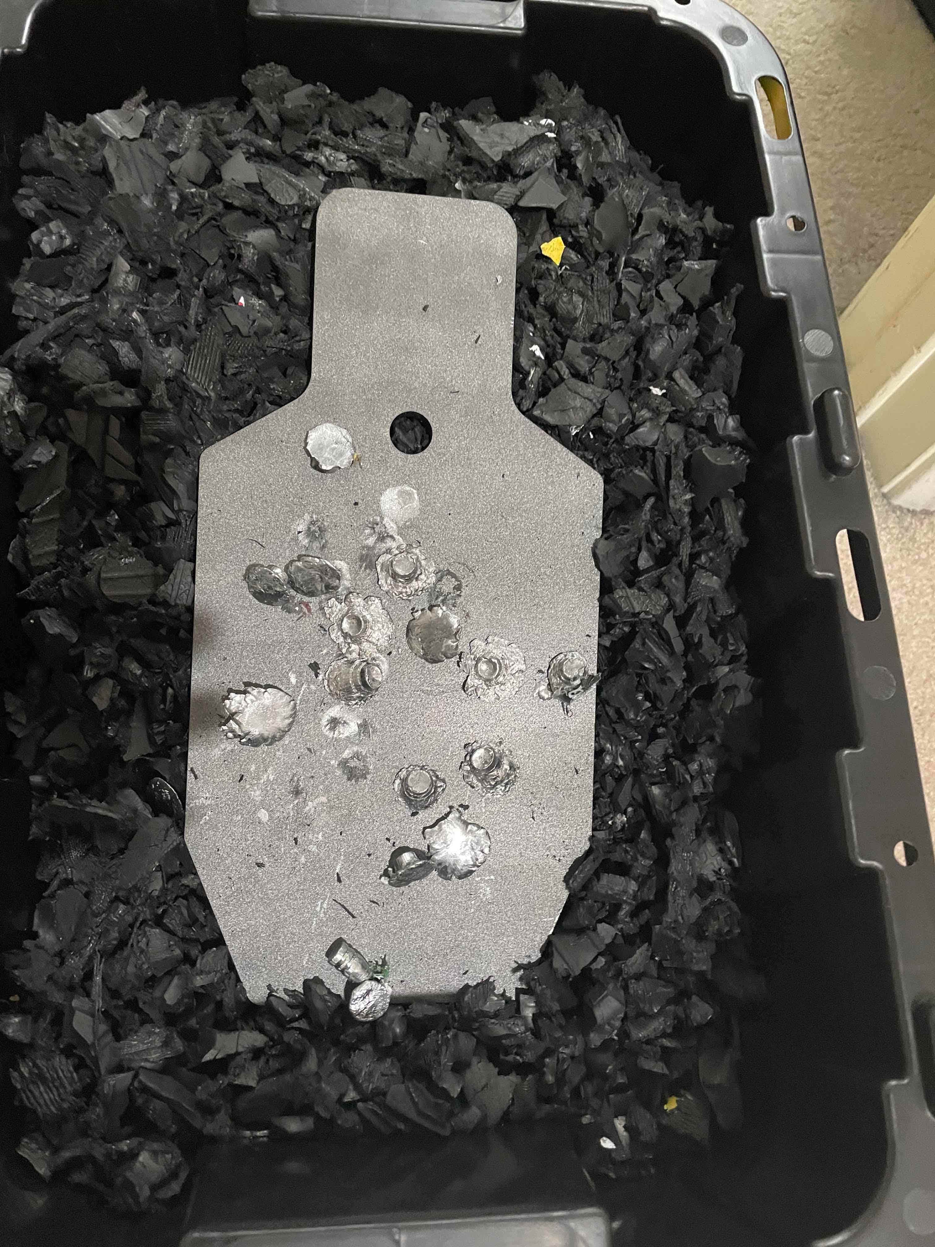

I use a box filled with rubber mulch as a pellet stop. Looking for the best way to separate the pellets and rubber mulch so the lead can be reused/recycled. It would be easy if the rubber mulch floated, but it sinks in a water bath just like the lead pellets. Any tips, suggestions or advice?

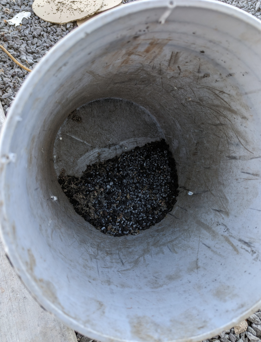

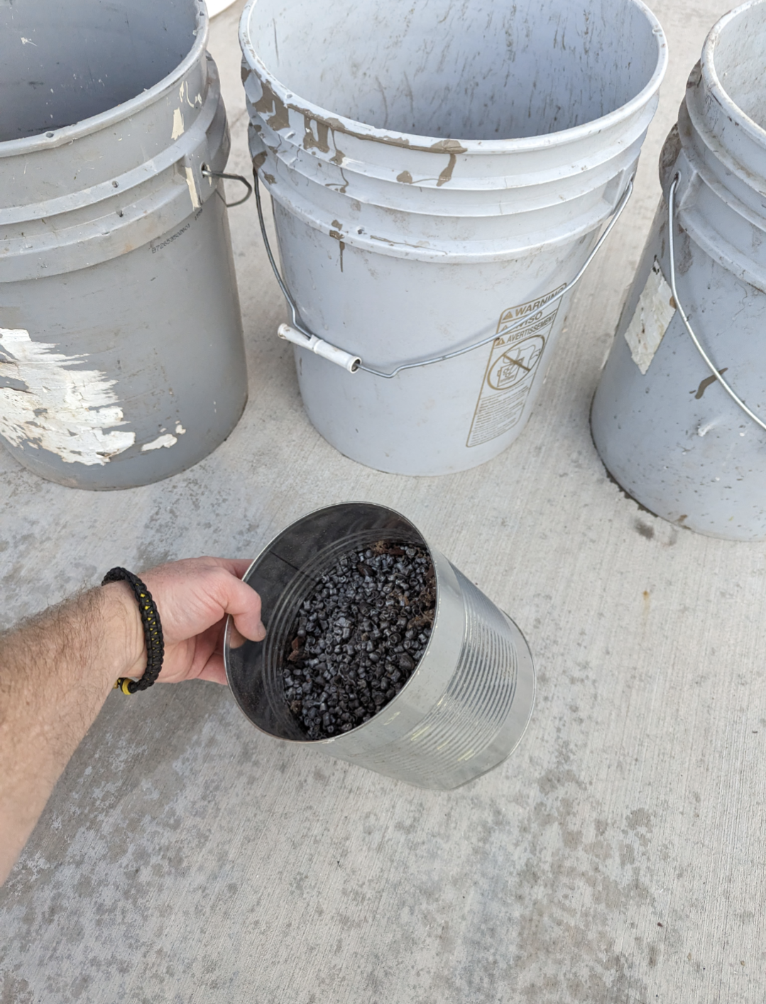

Photos from clean outs, bout 4 or 5 months worth. I'm due again.
Thanks - might be the best idea yet!
