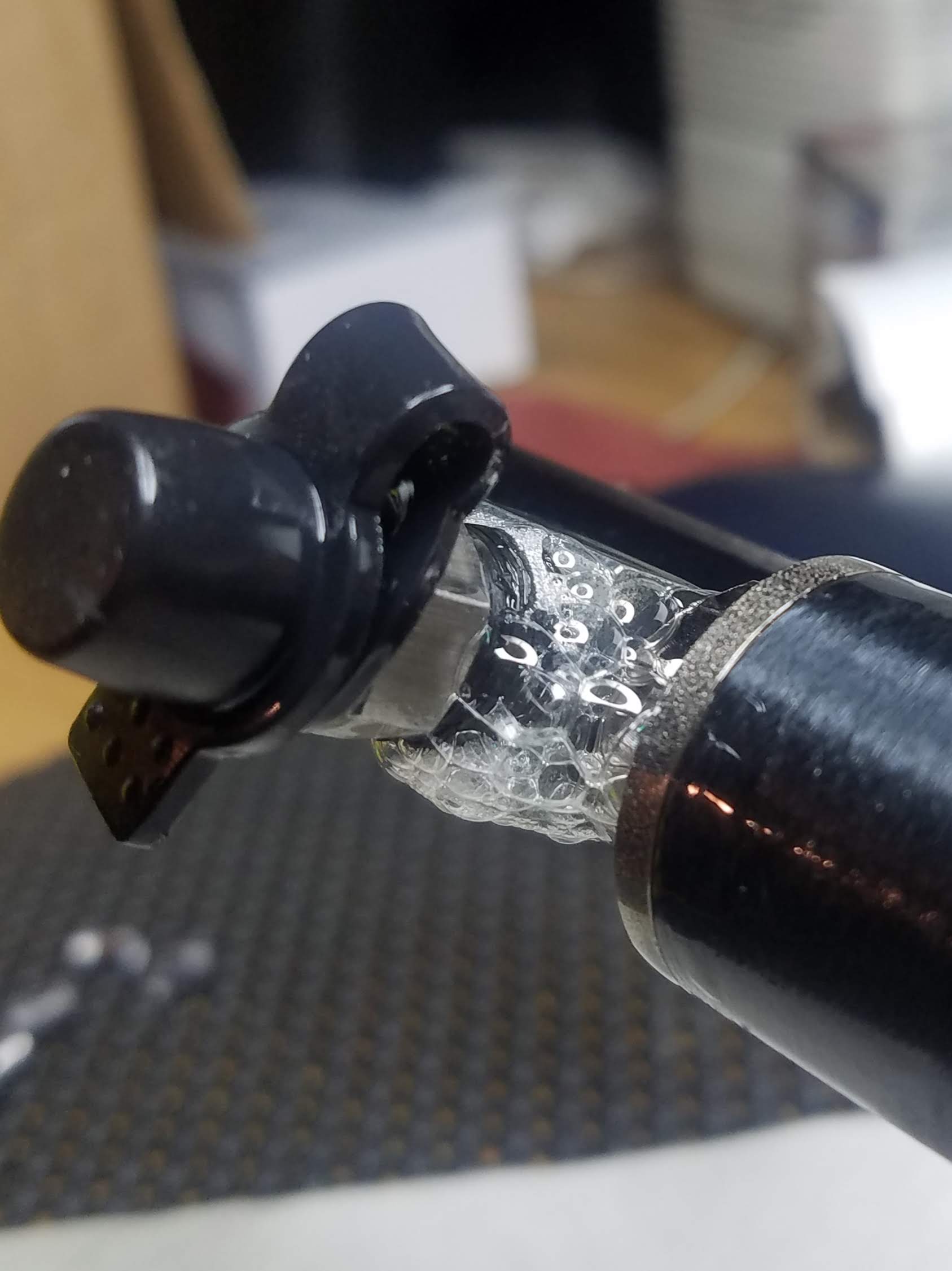

I was also recommended to use this one before:
