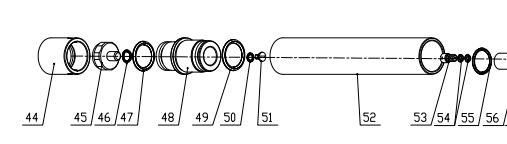

Snowpeak Leak in my PP 750 Pistol ?
Went ahead and ordered a new regulator (huma)as I am in there might as well improve it a little , I can feel the small leak coming out the hole where the air probe goes , Replaced gauge oring , to easy still leaking , Thought I would just order a o ring kit and valve for it , Nope there all over in the UK , Just wondering why no US based oring kits for the PP750?

The fill port O-ring #50 is a common source of leaking in SPA PCPs.
It is too soft so it eventually extrudes into the gap formed by the flat on screw #51. Replace it with a 90 durometer. The OEM size is a M1.5x5 but a -008 works equally well in this application.

Thanks a million, 1st gun I ever fixed a leak on and I have been in the PCP sport over 20 years , I usually just send them off to get fixed ,,, May try and fix my vulcan ll next,, Got the Vulcan ll 177 fixed also, I am on a roll , Right state of mind, Right tools and the right orings ,, I just plain lucked out ,

Do you have a link to the document you cropped the image from?
I'm having difficulty finding an exploded view of the PP750 and the newer PP750L...
