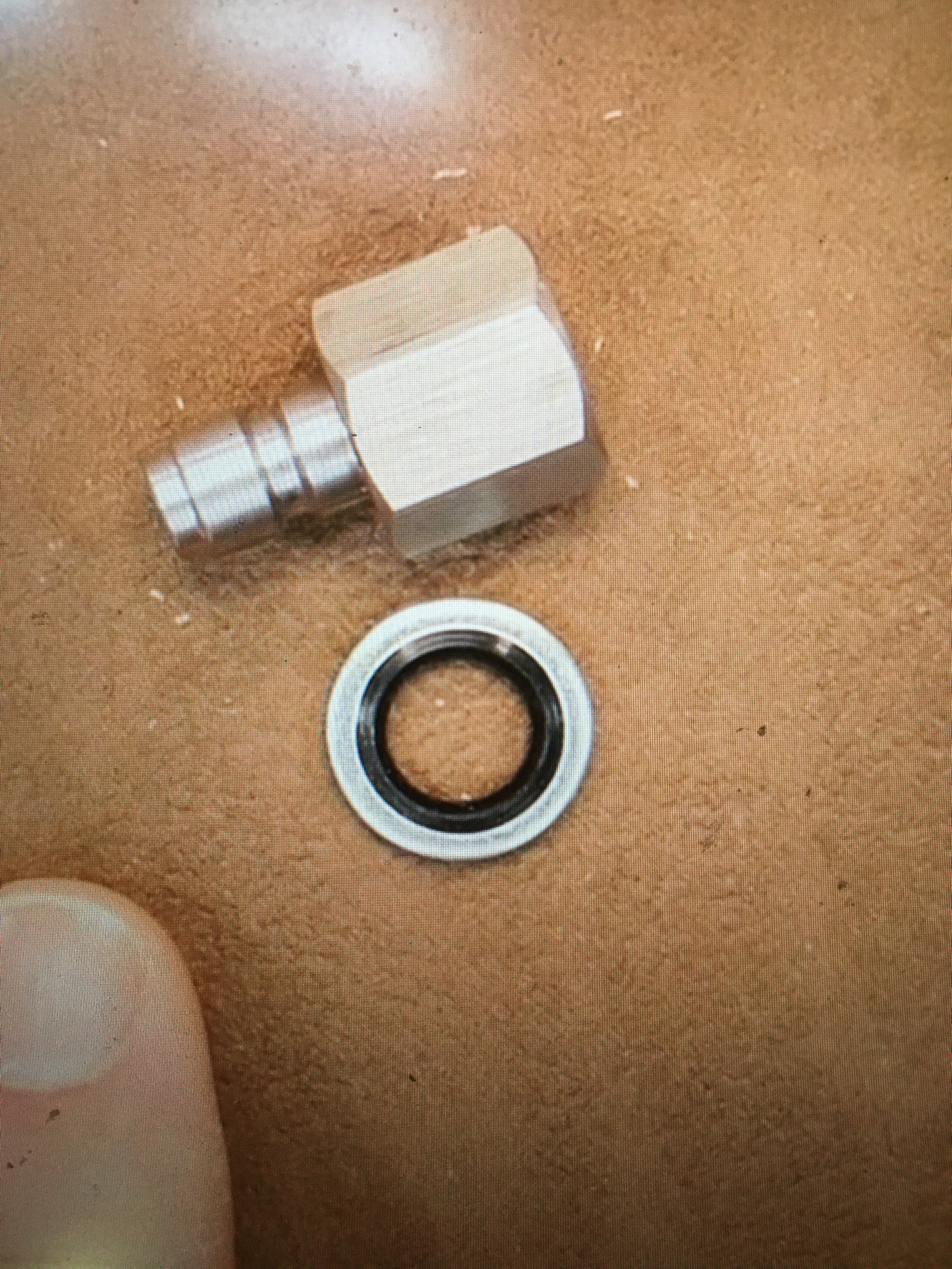

Looks like I found a video explaining what I need. Anyone know if this stuff can be found at Home Depot or a local hardware store?? Looks pretty specialized.
That's a dowdy seal. It will work and is external of the female fitting. Lowes sells some delrin washers that will work in a pinch. I think they might be like #10. I stacked 2 or 3 together and put them inside the female side.
